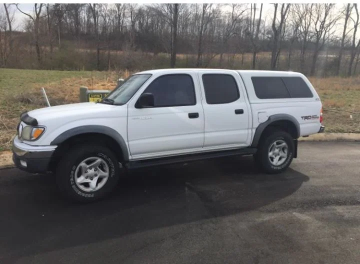

2001 Tacoma w/ 304,000 miles. Good price, good maint, etc... Would you buy?
Feb 10, 2017
13
96
Huntsville, AL
I've stumbled upon a well taken care off 2001 Toyota Tacoma TRD Off Road with 304,000 miles. The owner says it's all highway miles (never been off road) and maint was done every 5,000 miles.
I know these trucks can go forever but I'm curious if anyone would consider a truck with 304,000 miles as a good platform for an overland build. I'm just wondering if I should be hesitant about putting alot of money into a build with it.
Anything I should look for? Trouble spots?
Owner asking $5,500 but seems open to negotiations

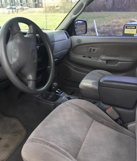

That interior looks to be in good shape. A good sign the owner took care of his stuff. I remember my driver seat was coming apart on the side plastic after 100k. It was from me rubbing as I got in or out.
