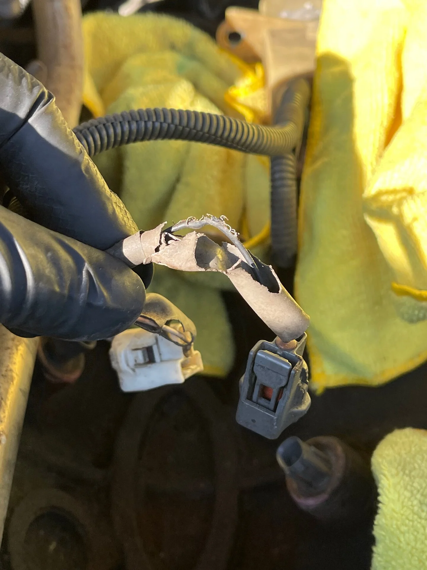

Replaced Starter, injector seals and a little wiring repair to the drivers bank knock sensor due to some rodent damage. It started right up the first day, second day no fuel pressure. I did start it with basically no fuel, so its possible the fuel pump sucked up some crap. I filled it with 7 gallons and still just crank and no fuel pressure. The diagnosis continues.

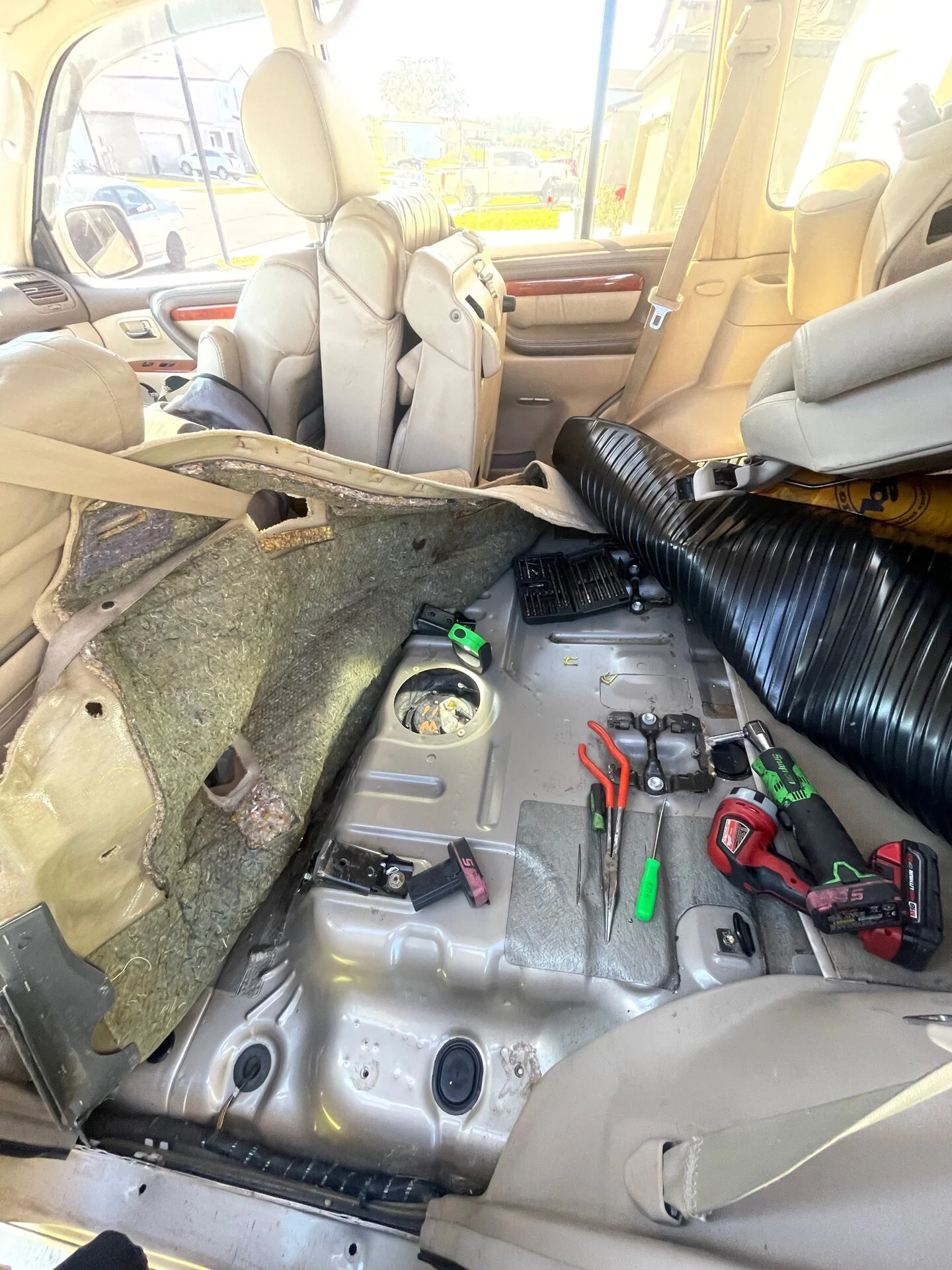

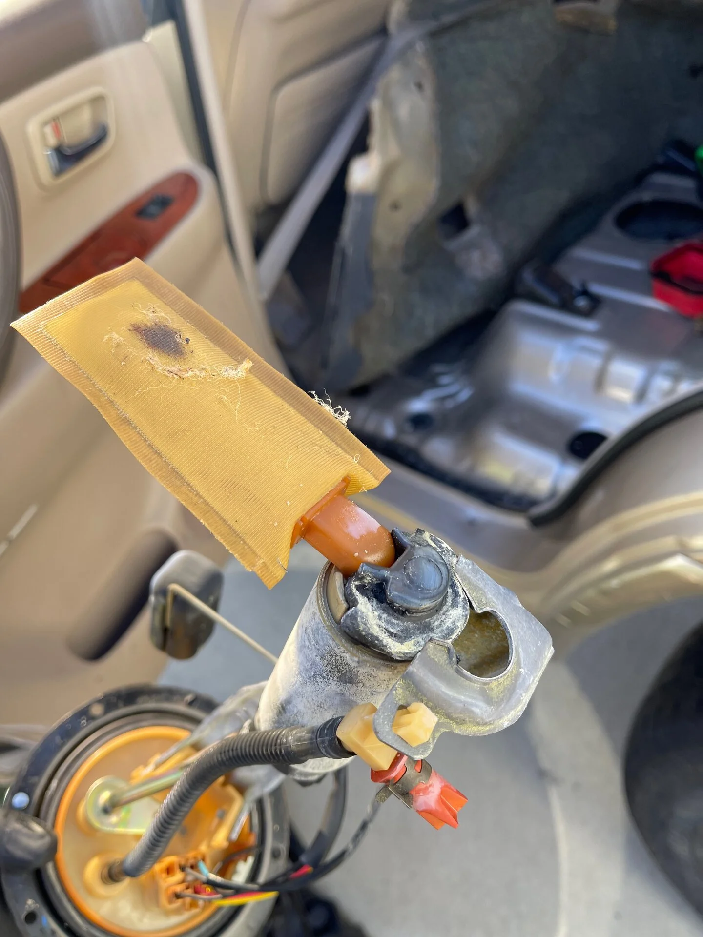

Checked power/signal and ground to pump. All good. Replaced the pump and fuel filter. Started right up. So all in all the started and fuel pump were both going out simultaneously. Ill post pics of both shortly.
