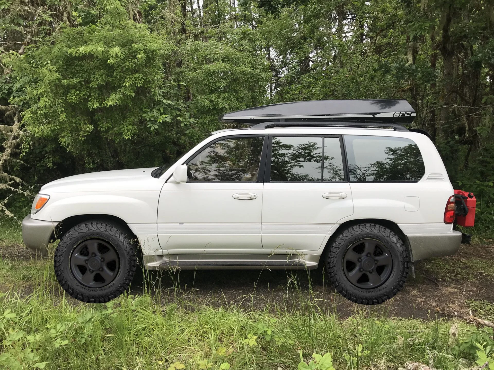

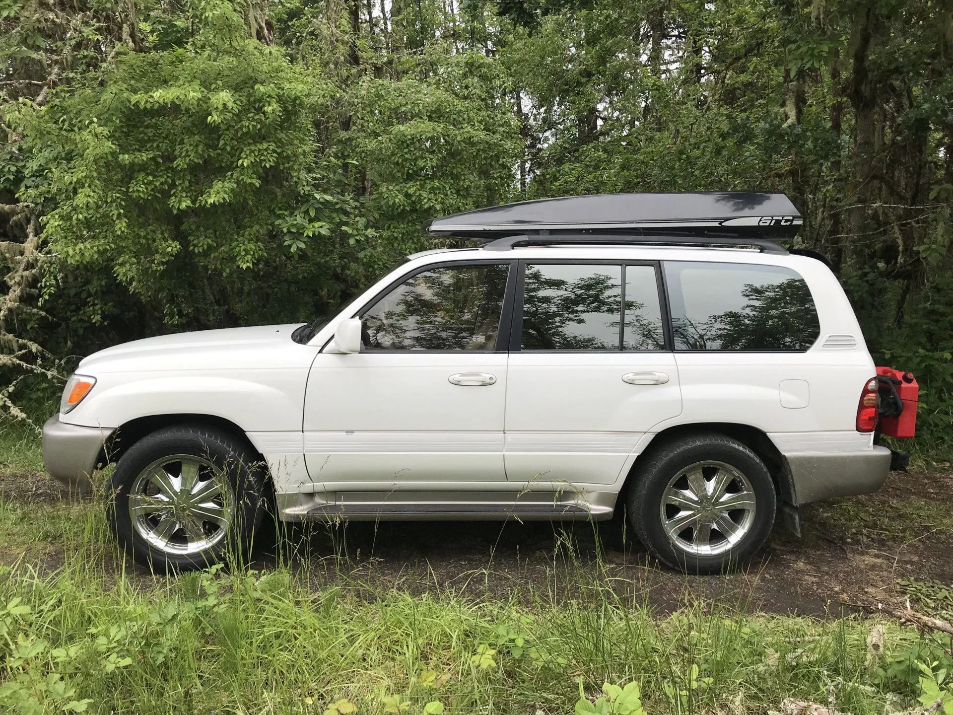

Lets try some photoshopping to get people talking... Vote for your favorite wheels. Going with K02s in some size that will fit on a 2" lift and fits whatever wheels I choose. The stance and tires will look a little different once things are lifted. I also didn't really go into crazy detail with 17 vs 16". I can get 4 stock LC wheels to add to the matching spare for $350. I could powder coat them all black for about $200. I could get 5 method NV wheels in black or bronze (I have the gold accents on this LC...) for about $1100. The chrome 20"ers and street tires need to go.
Congrats.
I would stick with 16s, but that's just, like, my opinion, man. Also, it's an ancient truck and this yr allows you to very cheaply/easily ( no messing with charcoal nonsense ) to do the spare tire mount lift ( one more thing for your to search ) Does it have screen or simple radio?

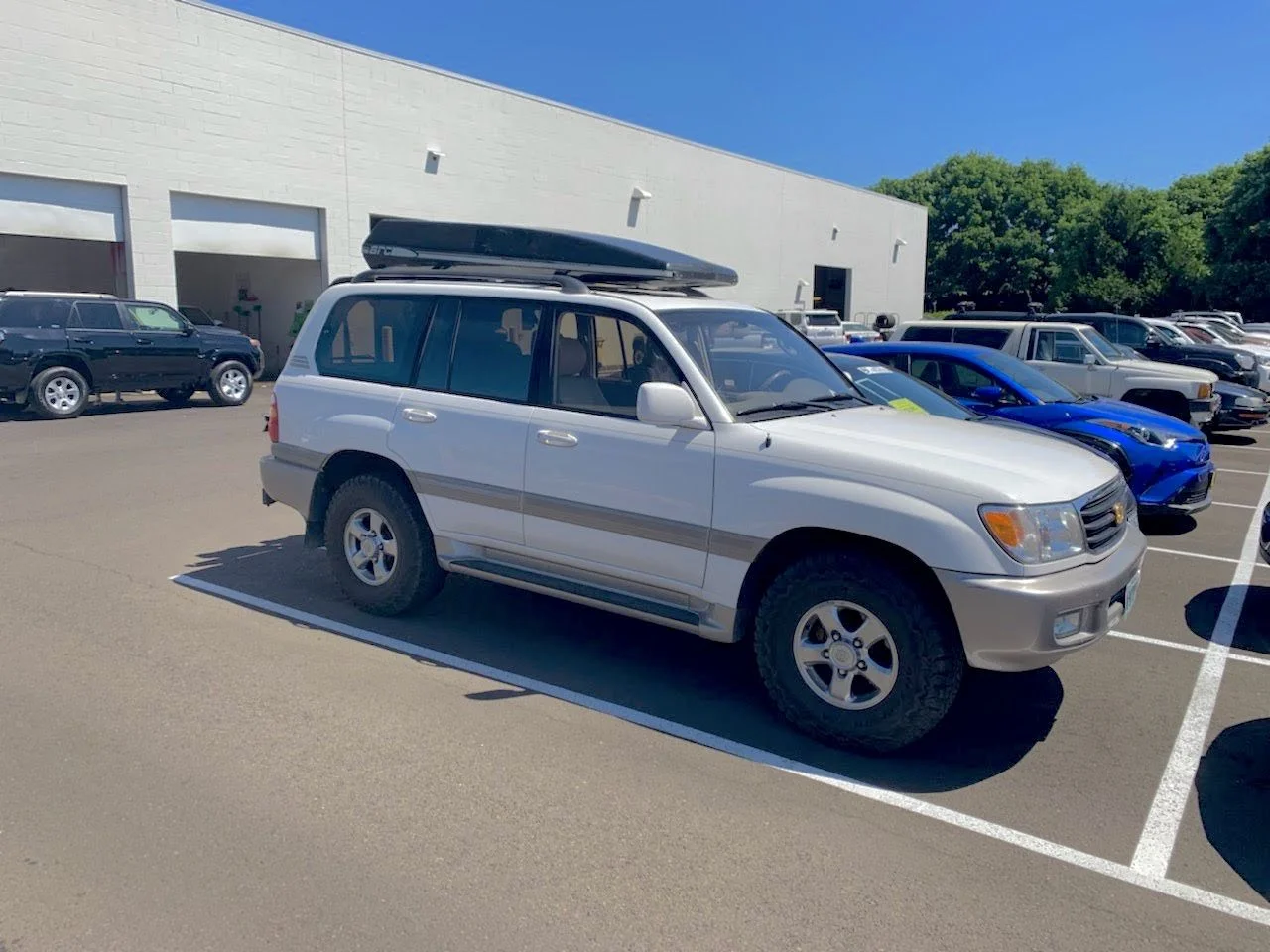

Here's some progress photos... Got a nice set of 16" rims off CL that came off another 01' cruiser to match my spare and got 5 BFG KO2 (MTS rating not DT) 285/75/16 tires mounted up last week. Put about 1500 miles on them already. Totally changed the thing visually and the road feel is amazing. Little to no noticeable road noise increase. Never going back to duratracs if these do well in the snow this winter...
With drawers and loaded up with camping gear, the original stock springs on the rear end were sagging pretty bad. Wanting to go slow and save some money, I had a set of 2860 OME rear springs put on yesterday (I don't have a garage or jackstands out here in Oregon at the moment so paid for the shop to do it) and I think its starting to level out although there are still a few things to put in the rear so will get a little less stink buggy in the next few weeks. It's about 1.75-2" higher up in the rear but I think that'll come down with the fridge and gear loaded. I haven't driven it yet but may have to throw new shocks/tbars in there but wanted to do one thing at a time.
