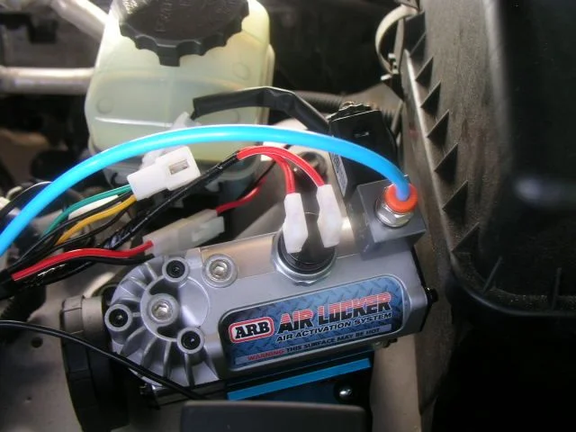

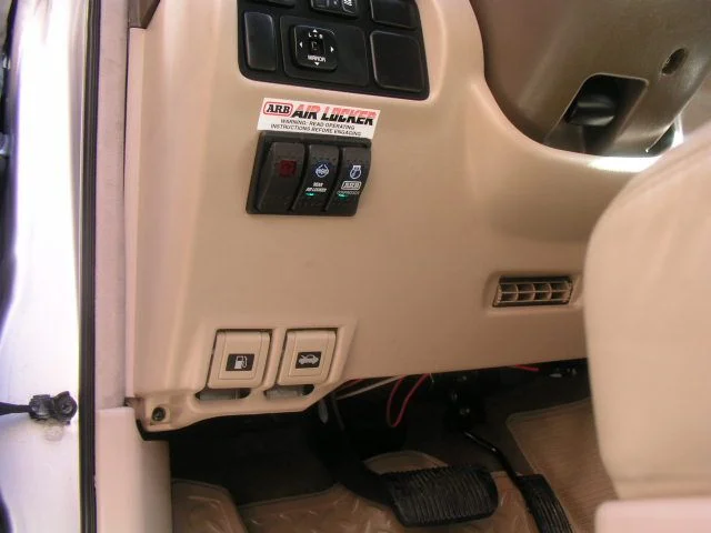

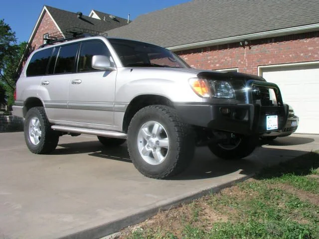

Back to the build. I installed the compressor and the switches today for the locker and front lights.

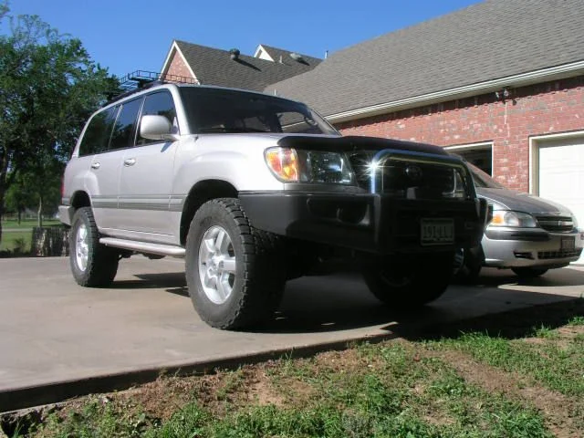

Installed the ARB bumper and M8000 winch today.
The cheapo plastic crap where the fog light kit goes is so cheesy. They do not offer any way to secure it to the bumper.
I had to use fawking ZIP TIES to hold it in toward the vehicle.
Also, the dinky little blinkers are worthless. They take the place of the fog lamps so I won't even hook them up.
Thanks Ken. I really like it.
Another thing I forgot to mention, I had an old plastic fairlead laying around the I had on my 40 once and it fit nicely in the area where the roller fairlead normally goes.
The plastic rollers posted once here are not a good idea as they still have the corners in them when they mount up where the rope can get wedged. This bumper is not like the 80 series where the roller is part of the bumper.
I slapped my licence plate over the hole and attached it with captured nuts so I can easily remove it when I hit the trail.
mobi-arc said:
Clean install, but how do you not activate it with your knee getting in-and-out of the truck?
I have my light switch around there and always hit the sucker though I'm too dumb to move it.

I dug this up to update the changes I have made since April....
I ended up pulling the HD rear springs and adding variable rate 866's in the rear. I still have the cheapo drawer system in the back full of stuff and I like the way it is only 1" higher in the rear like stock.
Also it rides much better.
Next up, I just ordered a front ARB to install over Christmas.
wngrog
866 & 863 carried same the weight just 863 set higher than 866 ur LC is very good what about the lockers ?:D i would like to see pictures while installing & did u change ur gears to 4.88 ?
The 863 to 866 swap dropped the rear by 1.5" and the ride is much better. I have only towed my big trailer once since the swap and it seems to handle just as well as the 863s did.
I was going to do the 4.88's but I am not going bigger than 33's and it just does not seem worth it, especially since I have already installed the rear ARB.
