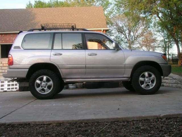

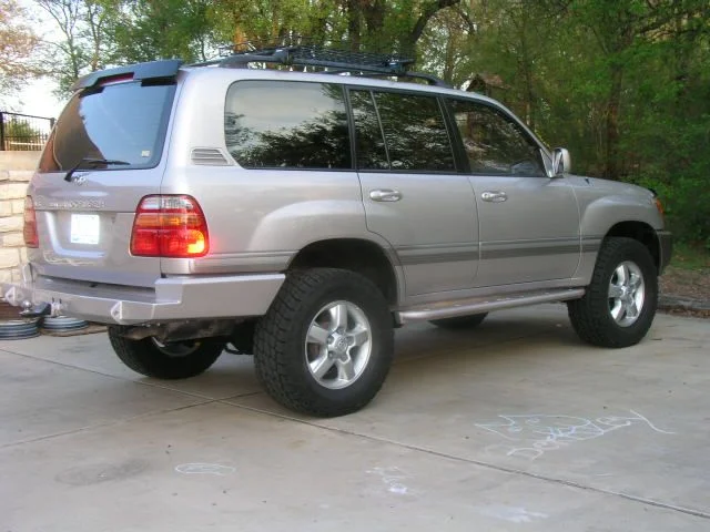

Wngrog, in your picture are you deciding on what roof rack to use? (I noticed the one in the background).
Damn you like to draw on your driveway alot! Every pic I look at has hieroglyphics in it. :D
Rig is coming along nicely; I can't wait to see all of the color keyed armor in place.

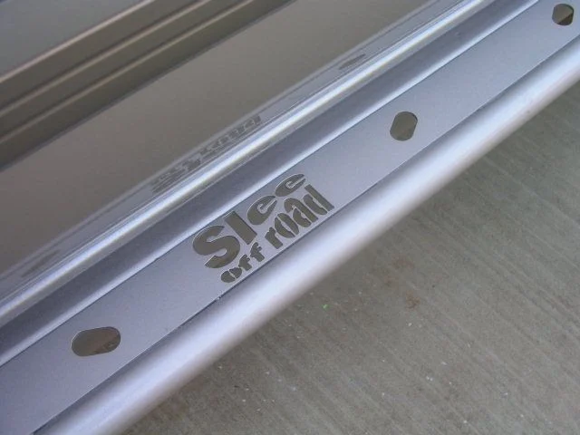

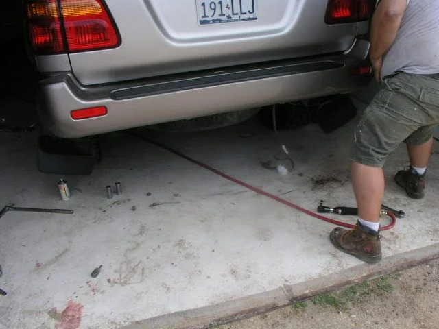

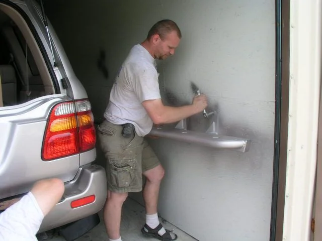

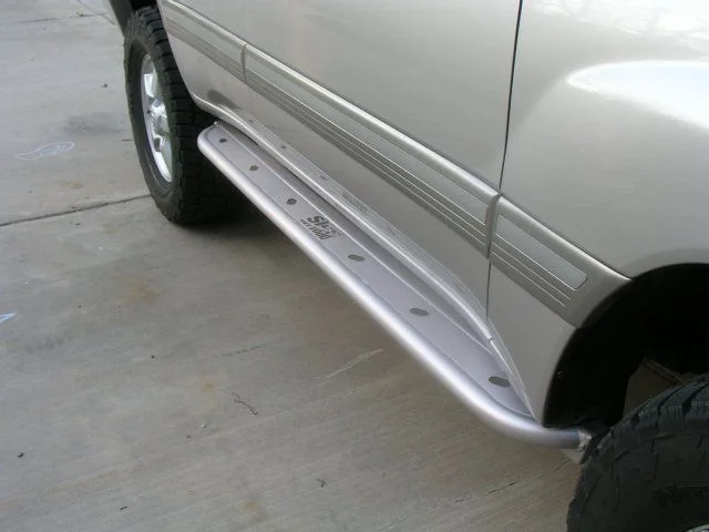

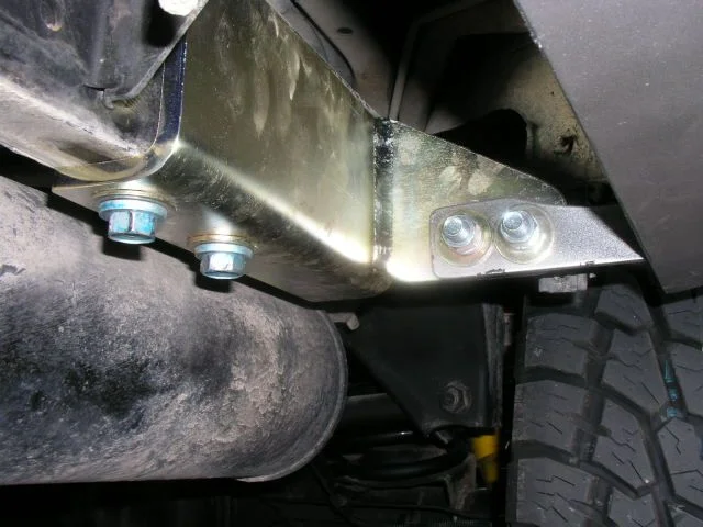

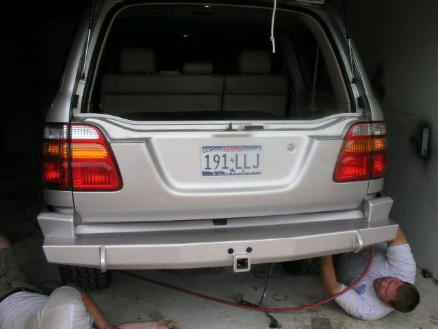

Did the install of the sliders and bumper. My buddies chipped in and with their help and me stopping to take pictures the old stuff was removed and the new installed in 40 minutes.
I really like the bumpers being painted the lighter silver like the body instead of the darker color the old bumpers were painted. Thanks Garth for the nudge in that direction.
I can not say enough about the quality of the Slee Sliders and the rear bumper. All the holed line up perfectly, the instructions are clear, the packaging is perfect........
Looks GREAT!!!! Love the match. Very low key, very stout.

ats4x4dotcom said:
copyied from bulls build post-
"You should maintain a minimum of 70mm [2.75"] of droop in the 100 IFS front set up, if you have a Slee diff drop fitted, to stop the cv boots wearing out. [boot pleats shouldnt be touching in straight ahead position at ride height]
This is normally 50-60mm higher than standard, depending on accessory levels.
on a 16" rim this makes for 770mm [30.3"] measurenent from bottom of rim bead edge up through centre of wheel to fender edge when set up correctly.
Rear should be aprox 790-800mm [31.5"]"

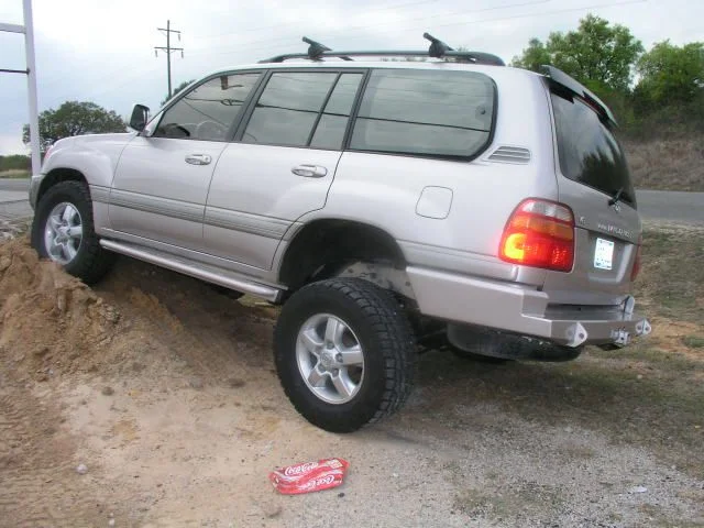

OK, after installing the Slee bumper it did not come down at all......with or without the spare in there.
Front (with 18" wheels) is 31.5" and the rear is 33"
1.5" rake back to front.
Christo and Darren, if you are reading this, I would like a set of those Bilsteins for the front so I can crank the bars up another 1" to level it out.

You are within 1/2" of where you would be with the Bilseins at the moment in the front.
I don't think you want to level it out even if you could. I experimented with this and found, as Christo and others have said, a 1" lower rake to the front will allow the 100's to handle and track much better...just as they were designed.
Cool. I was thinking I was going to be lower with the winch and bumper, but I realized it is not the torsion bar that is the limiting factor but the shock.
When it drops from the extra weight, I can just crank it up a turn or two.
Thanks for the feedback.
