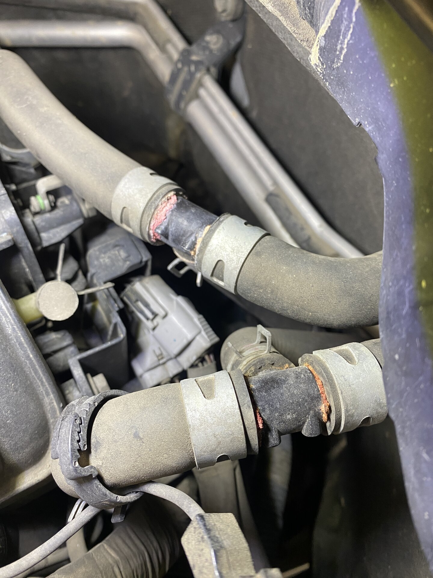

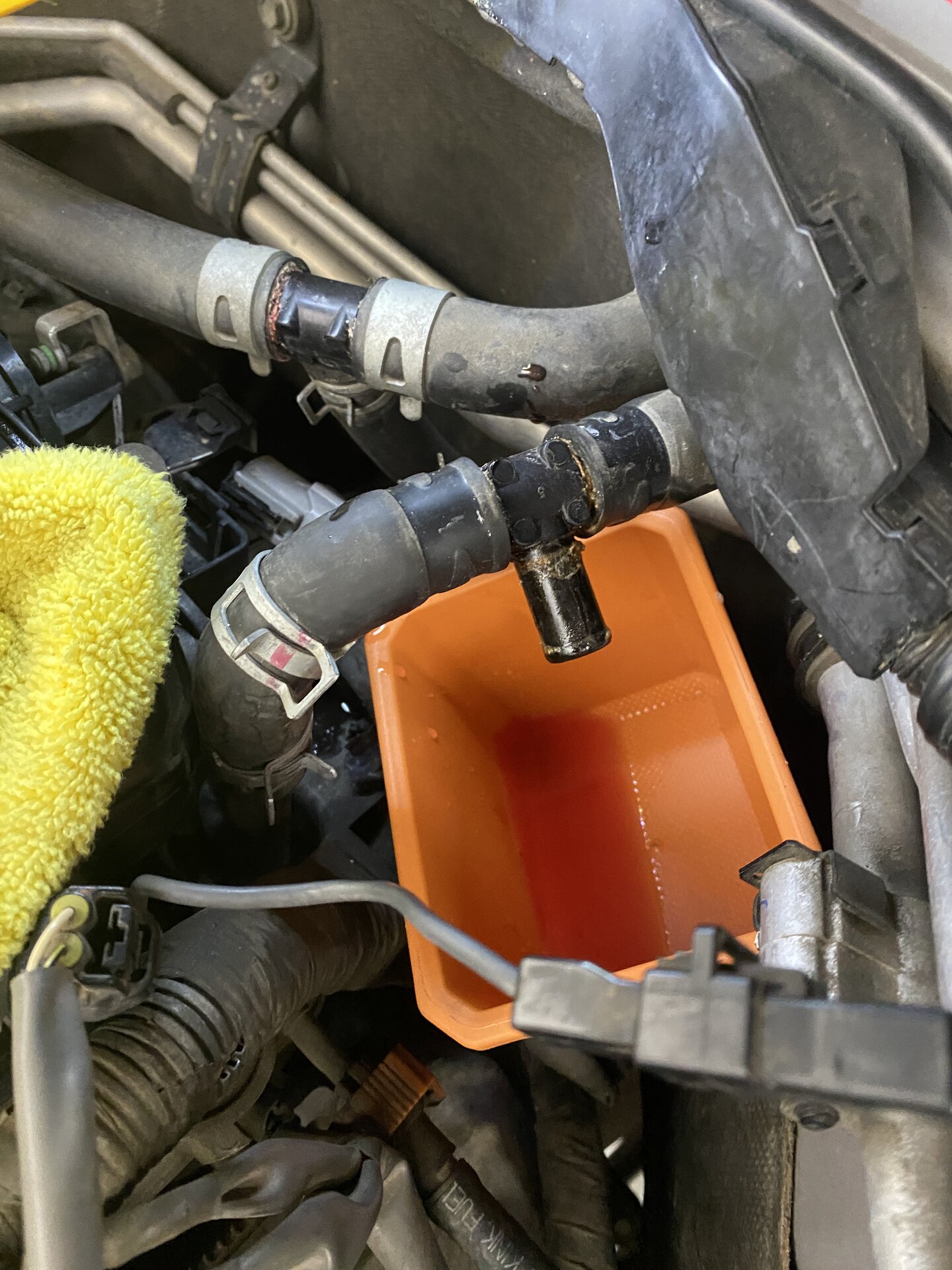

Noticed the heater T’s were in bad shape. I snagged two from the local dealership and tossed them in.
My heather T’s are in great shape. Can’t say the same about my back.

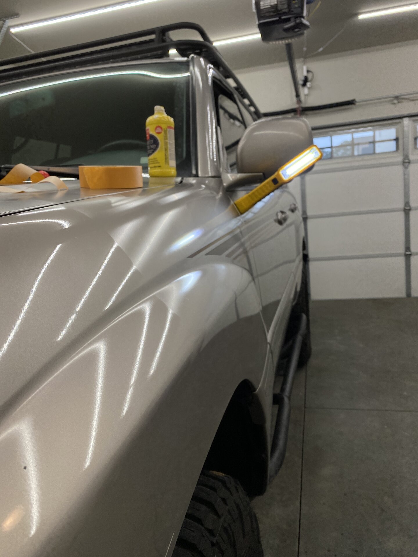

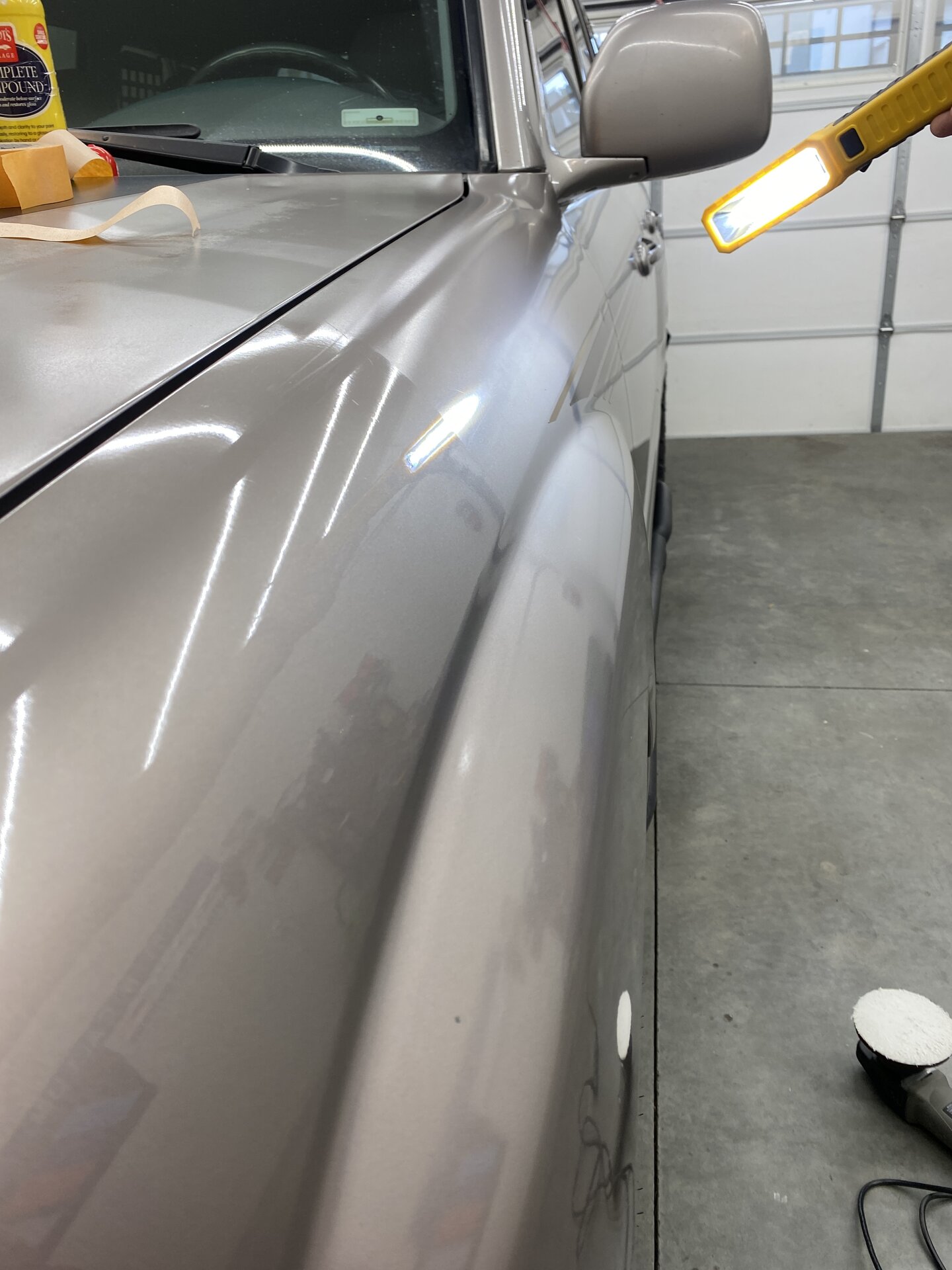

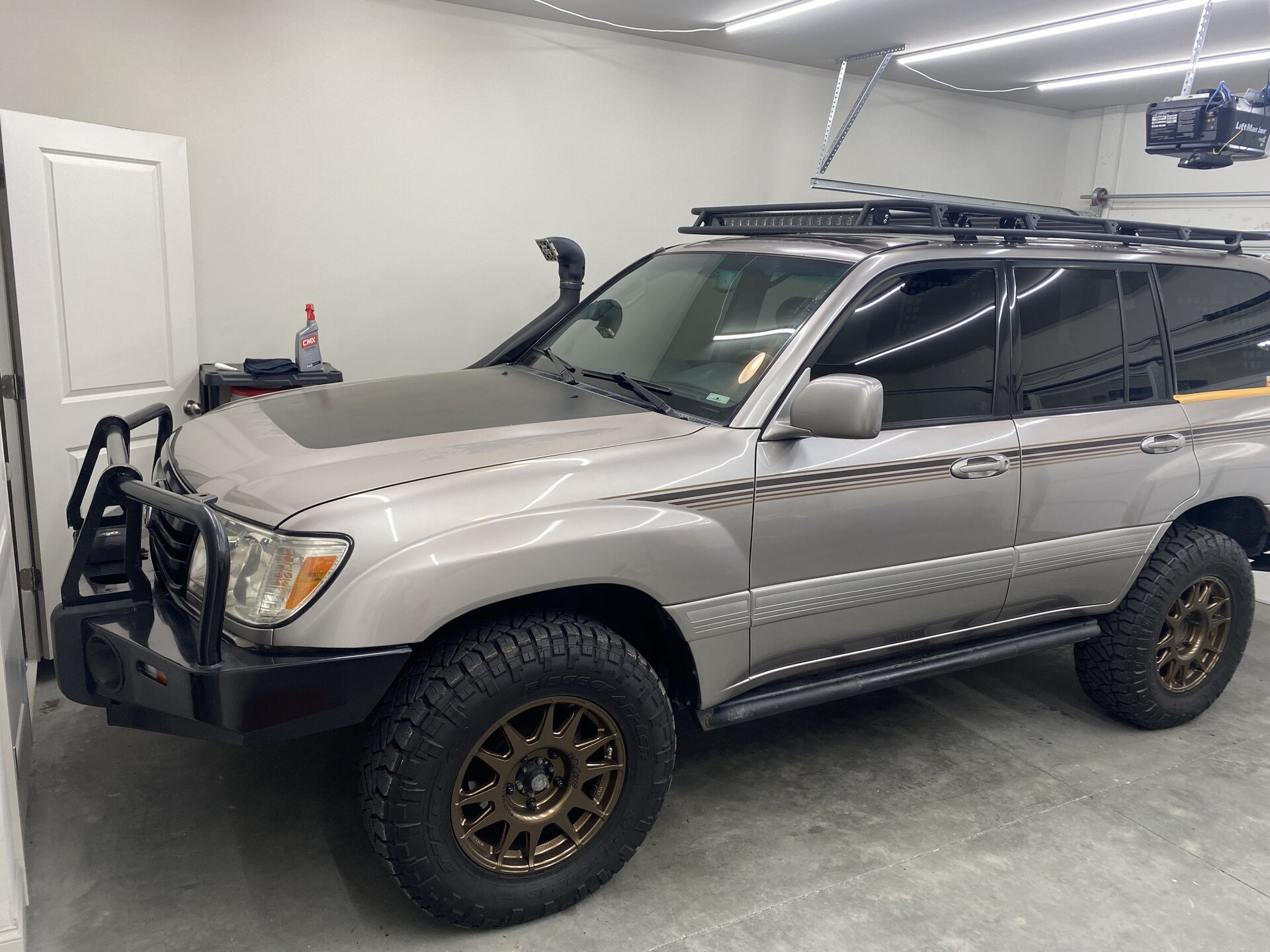

In my pursuit to bring this paint partially back to life I’m testing different pads and compounds on some panels. A DA with a microfiber cutting pad set to low speed produces a really nice finish, but does not heat the paint to a point where I’m nervous. I think the results are fantastic. I don’t wanna take any more clear off, but I’m happy with the results taking a “exfoliate” a little method.

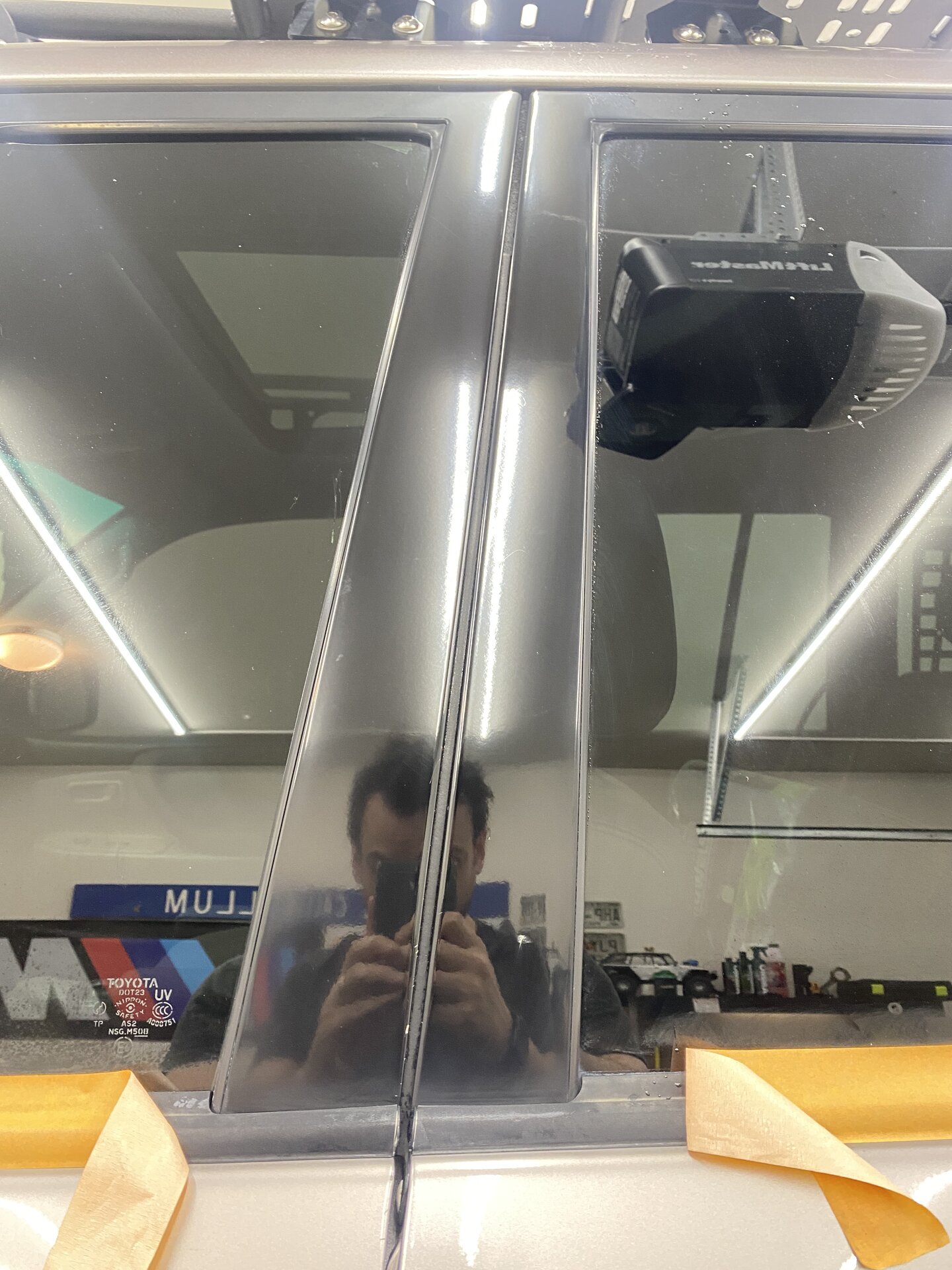

Wrapped up the doors. I had to really step up the cut on the top. The graphics were a challenge but overcame with plenty of liquid and blowing out the pad after each round. You can see the difference between the front and rear door reflection. This was my “50/50” shot before correcting the rear door.

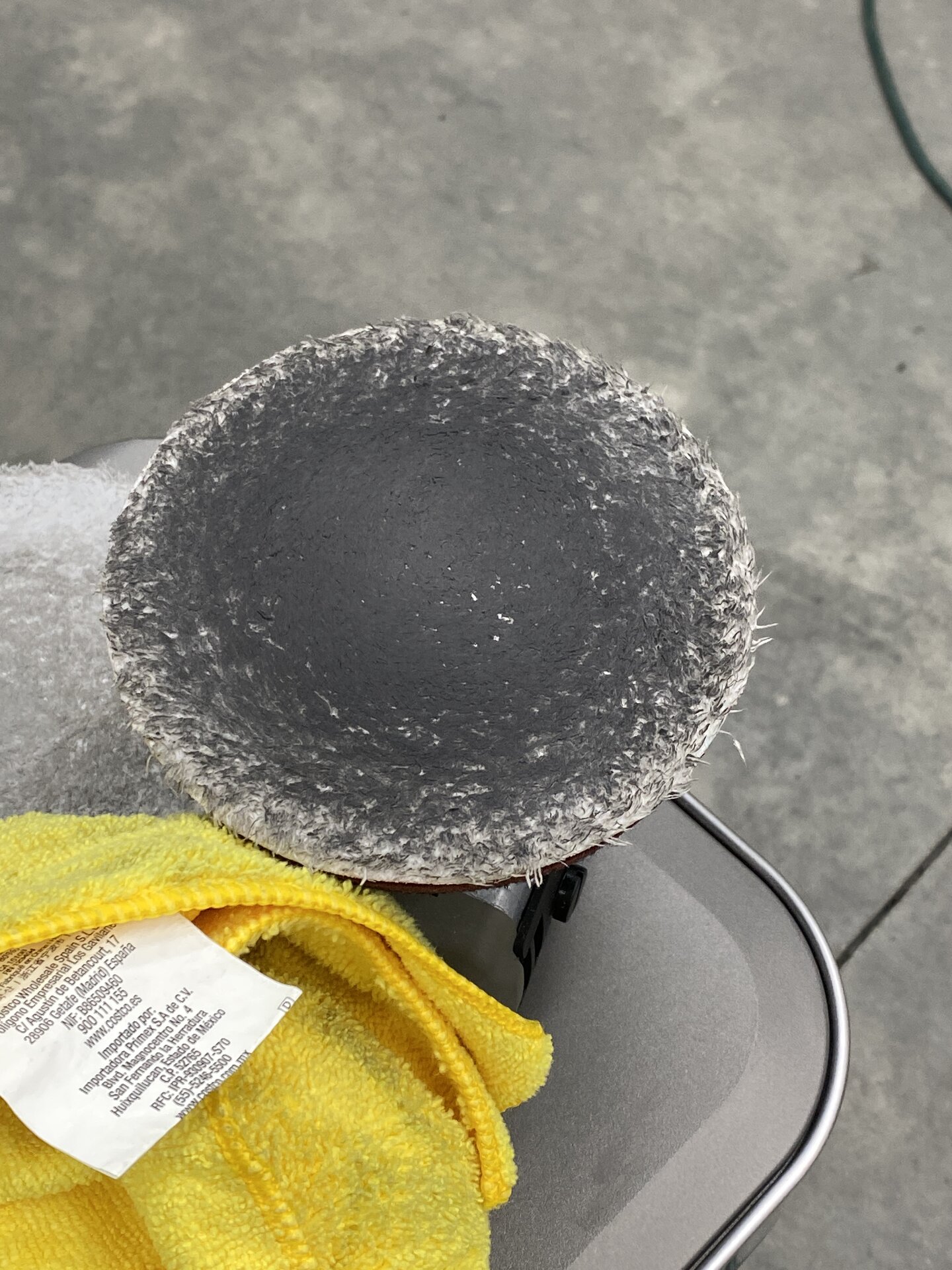

Started on the trim, instantly clogged the pad and ended my night 🤪
