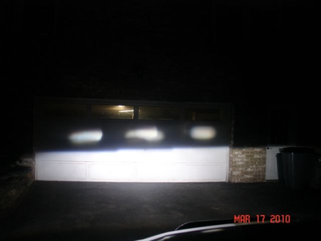

I will take some pics of the holes when I fill them over the weekend. For now, here are two pics of the result. The holes in the pic are obvious, as there are two in each headlight. If I back up another 20 feet, there are four rectangles :) It seems pretty obvious to me in these pictures, but I also took some height measurements last weekend and my drivers' side front is currently sitting about an inch low... dang Lexus' AHC :grinpimp:
Just installed hid's on my LX and boy are these "holes" annoying and distracting. No way to fix these without opening up the headlight itself I take it? How many LX owners here are riding around with these? I'm tempted to try and fix the projector from the inside through the bulb hole, maybe a paintbrush to cover the holes? Thoughts/suggestions?
^ I believe you will have to take the light apart to fix the squirrel finders, but you can try your idea. Keep in mind that needs to be addressed soon, your sending bright light straight into on coming traffic.
I have an 01 LX with the 55w 5000k and those three dots you see up close actually shoot straight up and to the sides. i think theyre meant to highlight street signs and such. ive never had anyone flash me for glaring them (1.5 years). however, they do look annoying to me and i want to find a way to get rid of it.
Haha..squirrel finders is a perfect way to describe them, they are all up in the trees for sure!
I worked on the pass. side headlight tonight and was able to block off the holes in the cutoff inside the projector by going through the bulb hole. This was with the headlight removed from the truck and sitting on a work bench, I think it would be very difficult if even possible to do it with the headlight on the car.
I used a product called strip caulk from 3m to plug the holes. It's a soft putty like substance that is somewhat sticky as well. I rolled up a ball of it and stuck it on the edge of a long thin screwdriver, then fed it through the bulb hole and got it in position over the hole in the cutoff. Used a long 1/4" drive extension to pack it down into the hole. The strip caulk tended to stick to the extension instead of the light at first, so I sprayed the extension tip with silicone first to prevent sticking, then packed the caulk down. Works perfectly and should stay in place pretty well I believe, this stuff never hardens or dries out.
Simple solution and well worth it I believe, much nicer to drive, just have to fix the other side tomorrow.
