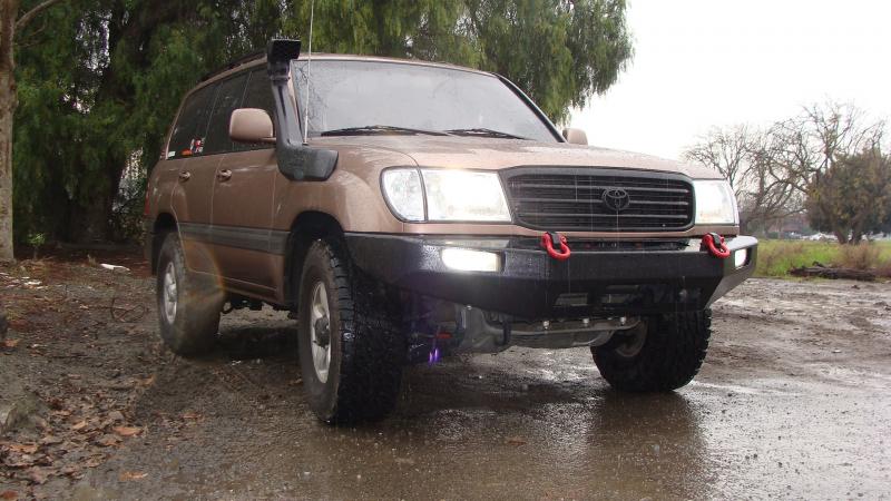

1st picture: HIDs in the lows, not yet installed in the fogs
2nd picture: HIDs in both lows and fogs
lows: 55w 9006 6k
fogs: 35w 9006 4.5k
doesnt look blue to me:D
