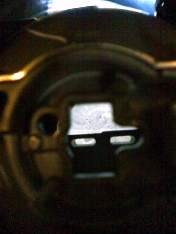

got a pic of where those holes are that need to be filled?
I'll see if I can get a pic when I do the driver's side lens. Didn't happen today as I took the truck in to get the infamous windshield noise fixed at a glass shop and it wasn't finished at closing. If you look though the bulb hole in the back of the headlight you will be able to see them fairly easily, two rectangular holes in the cutoff shield.
Here are the pics.
First pic is the back of the headlight with the access cap and bulb removed, second is the view of the holes through the bulb opening, and third is a pic with one of the holes filled.

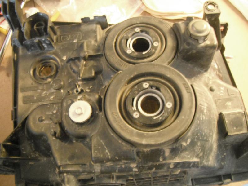

Pics -
#1 - rear of light assembly
#2 - view through bulb mount into the assembly
