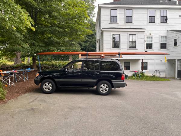

Hi Everyone, I love this 100 series, but im looking at north of 5k in repairs and it needs tires. The frame near the front body mount is pretty much toast. It needs a steering rack, CV joint, front Automatic Transmission hose assembly, a rear wheel speed sensor, and the mechanic says there is 1/4 inches of play in the rear diff......Cost likely go up depending one what breaks on removal, and the bill doesn't include fluids, etc. I could actually do this myself but I have so much else going on I just dont want to do it. The sunroof doesn't open but I bought new cables and a frame that works with a working motor I was going to install......
What it does have, a 297k motor that runs like a top, burns no oil, has new coils, plugs, timing belt serpentine belt. New radiator, All new AC front to back a stainless exhaust and slee step sliders. Also, I revcovered the front seats, and it has a great sony head unit with apple play....
Anyone on the board want a 2000 LC to cannibalize? I think its worth something for the parts. All thoughts welcome!

This is such good advice! The only rust ive seen is near the body to frame bushing up front....I'm pretty close to doing the cv joint myself. Ive done them before and it doesn't look that bad....The steering rack looks like a pain, but doable.....Im in MA yes...Too wet to get under the car for picks but I'll get some tomorrow. Here is my post on craigslist. added a bunch of images, will get underside tomorrow....What is the name of the shop in Braintree?

I found the Craiglist Ad.
If it's ok to post it, here it is.
Honestly, it doesn't look bad, but the underside may be a different story...

here are a bunch of images, Ill add pics of the underside tomorrow

Hey everyone, I bit the bullet and started pulling the CV joint. Unfortunately I didnt know that means replacing the upper control arm!....I took a ton of pictures if the underbody. The frame is solid except where the front body to frame mounts are....and the passenger side rocker is rusty, I figure due to a clogged sunroof drain. After cleaning up the car yesterday I starting thinking of doing the work myself...maybe not the rack as that is difficult on my back....Let me know what you think of my rust survey pics. They are on google drive, I shared to anyone with the link: LC-under-body - Google Drive - https://drive.google.com/drive/folders/1pMToDzVHYqxdyCTbflghjo32k-VZxsuY?usp=sharing
I think I will need to break the lower Ball Joint to get the CV out, and tricks on the upper ball joint replacement would be great. Not pumped about pulling the upper control arm.....My Dad told me years ago, never fall in love with your car....damn it
