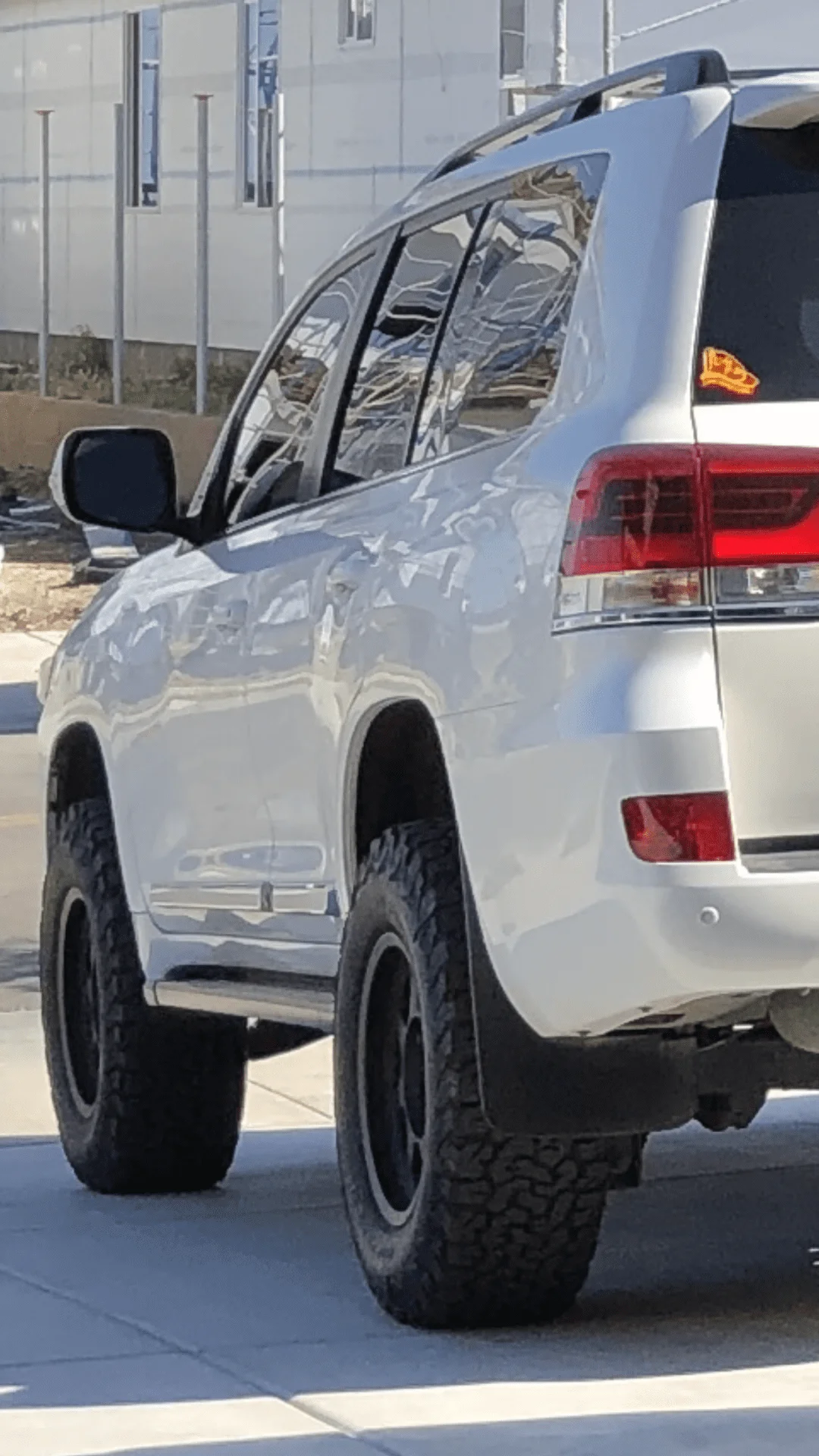

This image is of 0 offset with LT285/70r17. The Tires poke out well past the fenders.

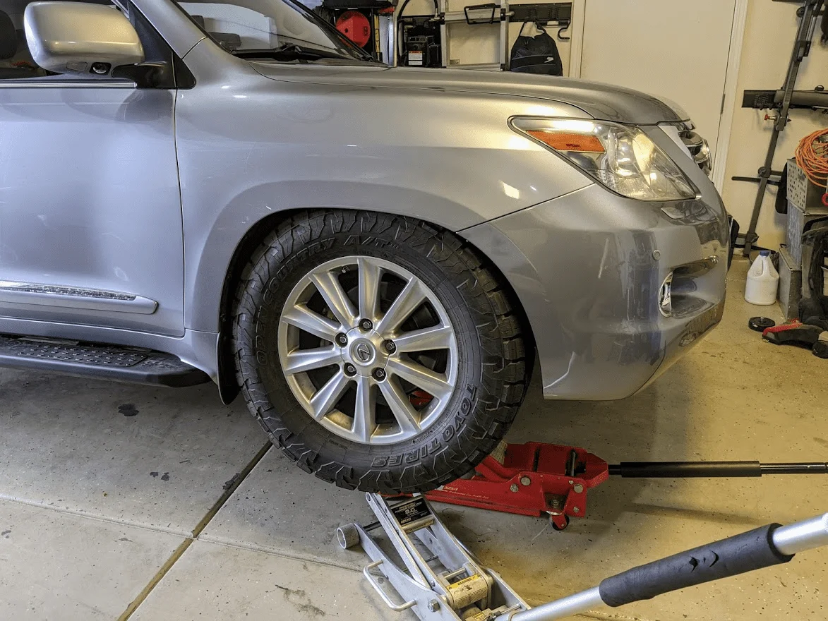

Here's what a 35x12.5 looks like at full stuff with +35 in front. It does contact and needs a tucking of the wheel well liner moved to above the tabs to resolve. The rear may contact too. There's a seat belt bolt that protrudes that's best cut off to minimize issues. Aggressive offsets are going to need aggressive mods.
