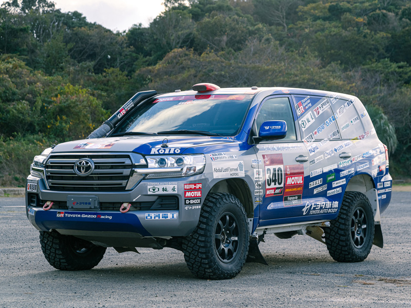

Found some sweet new style wheels for 5x150 but I have to order 40 (from Enkei) to get them made to be sent to US. Do to a JDM Market limited wheel.
PDT1 Limited Edition in 18 or 20 in a various colors.
View attachment 2887002View attachment 2887002
Is that this wheel? You just need 9 more volunteers to get to 40.
That is the full forged wheel only for race teams.
The PDT1 is the flow forged street version.
