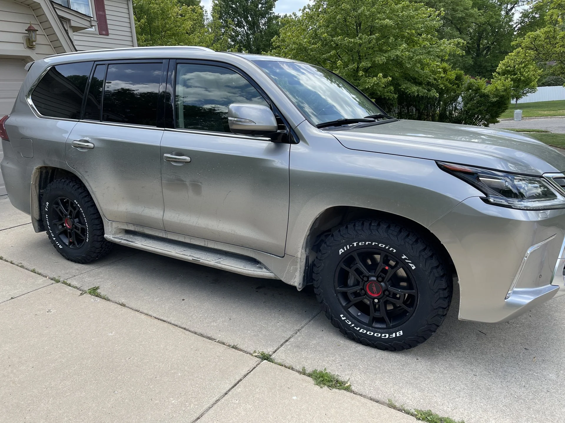

Update here: I was able to get a set of BFG K02s in 275/65/18 on some Toyota TRD Pro BBS rims (PT960-34200-02). All stock; no lift and no spacers required. Here are the images for those on this forum who are interested (photos taken with suspension on standard height). I can't stress how great these look in person. Can't wait to try them out:
It looks really good. Was there a big difference in ride quality going from 20s to 18s with lots of meet?
I have 285/55-20 KO2s on my LX which is almost the same size. I did have remove the front mud flaps but removing them was <5 min.

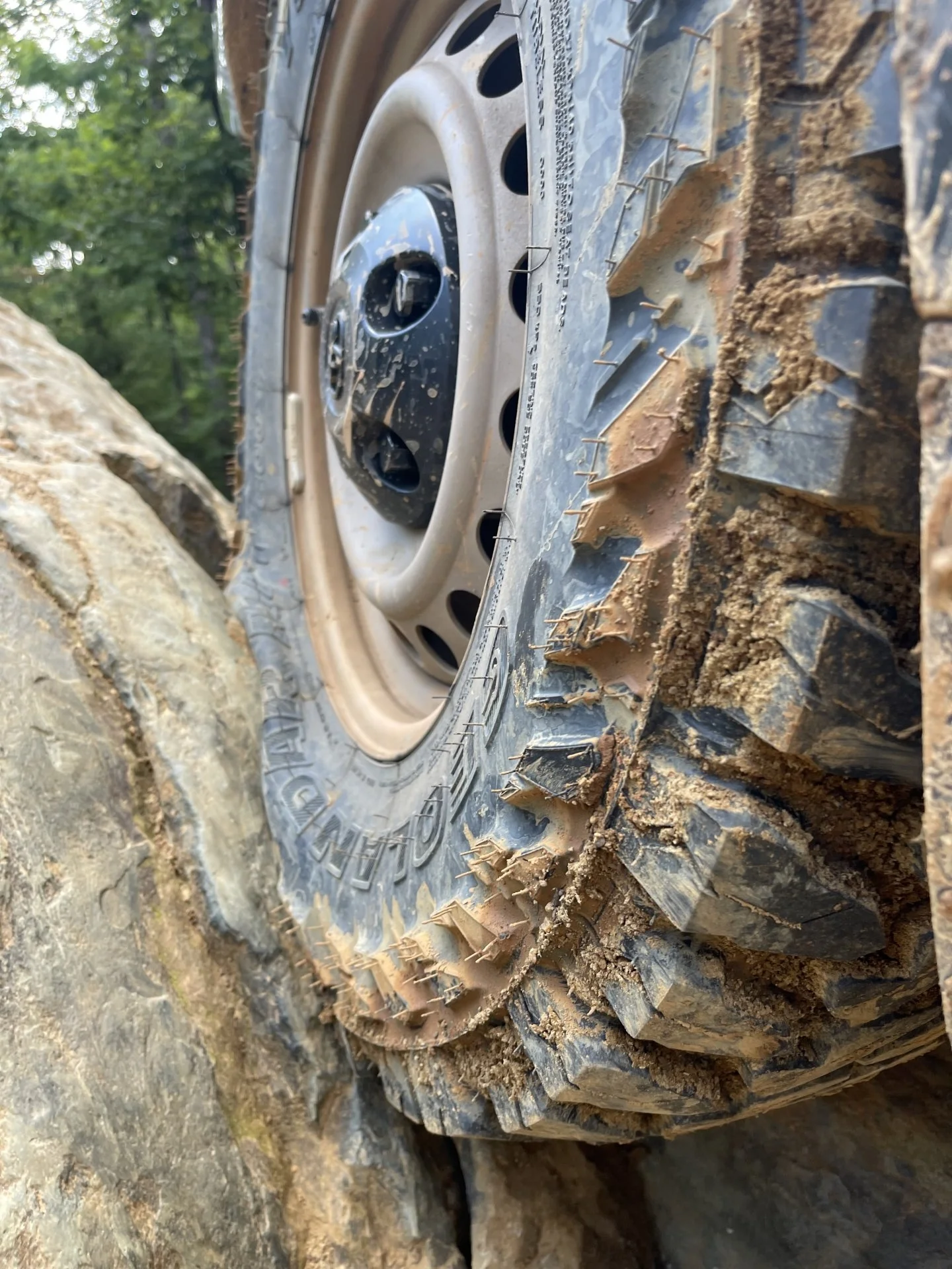

Went with the tried and true 285/65r18. Toyo R/T, load range E. No rubbing at all, even after a day in the mountains with some articulation.

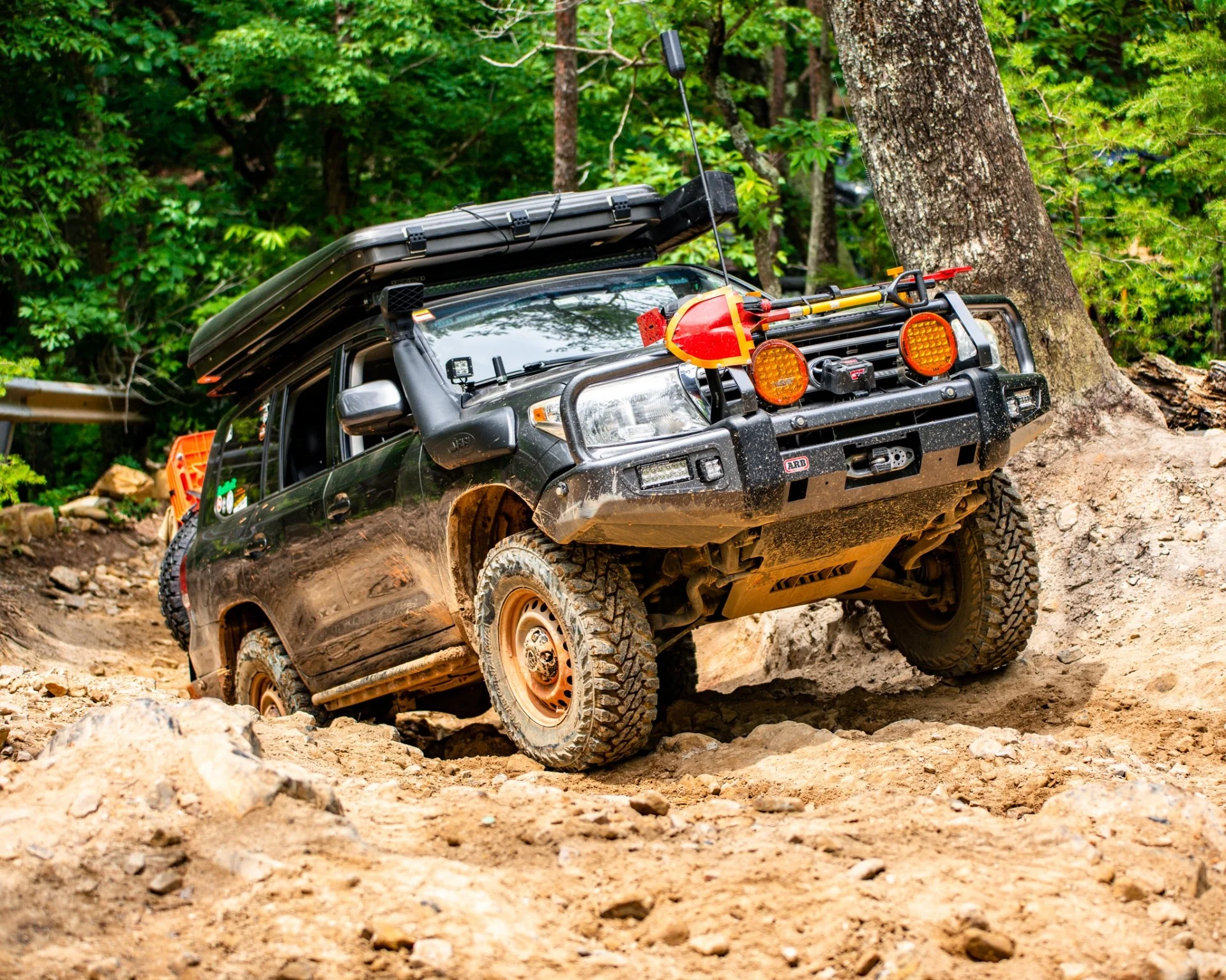

275/80/17 definitely get into the rear wells.. didn't think I'd need extended bump stops but this weekend proved otherwise. Bent in the metal behind the bumper skin is how hard it was getting in and got into body inside fenderwell
stock suspension set up?

Yes, all stock, no front spacer.

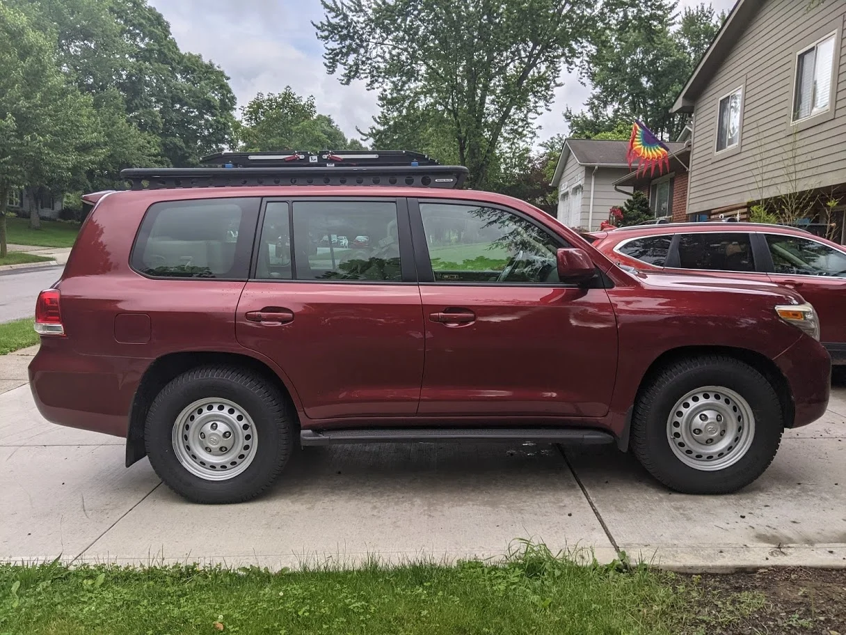

Decided on going with Michelin Agilis CrossClimate 275/70R18's since I mainly use the LC for towing our camper. Stock suspension for now but will do that soon also as well as remove those running boards. @gaijin is there a RTPS for this tire (load range E, speed rating R)?

There sure is!
The RCTIP (Recommended Cold Tire Inflation Pressure) for those LT275/70R18/E 125/122R tires on your LC200 is 41psi F/R.
