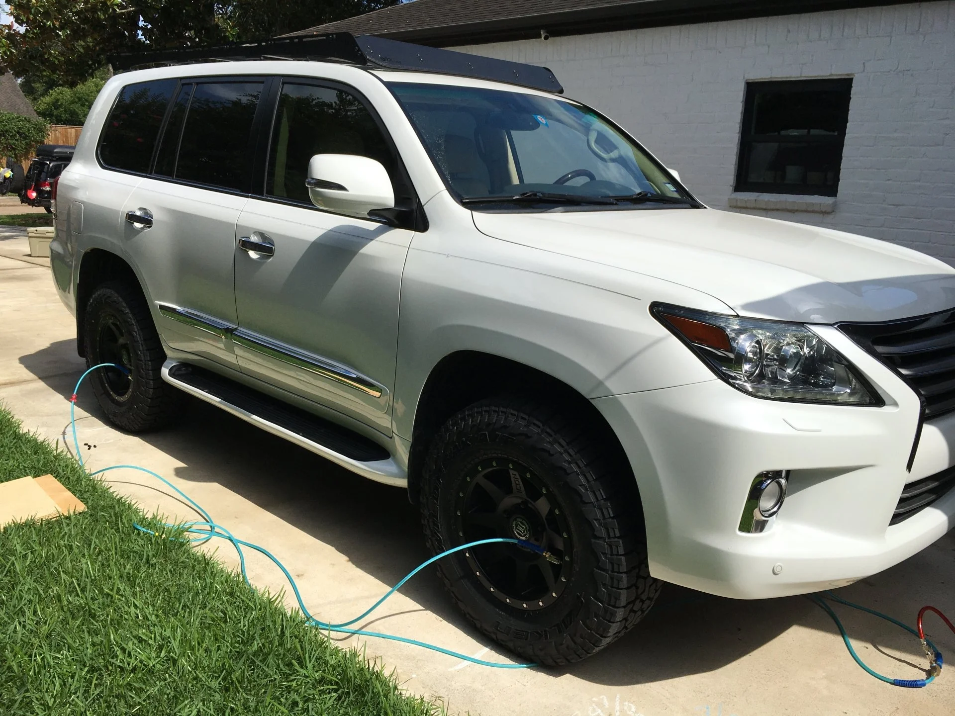

Icon rebounds 17x8.5, 25mm offset. 285/70-17 LT-E falken wildpeaks.
Slight poke (I blame the wildpeaks - they are ~1/2in wider than the KO2s, but I can live with it since I can tell myself I'm on a true 33" tire 😬).
Slight rub in front wheel liner and mud flaps - pushed liners forward and cut the offending portion of mud flaps. No more rubbing H/N/L.

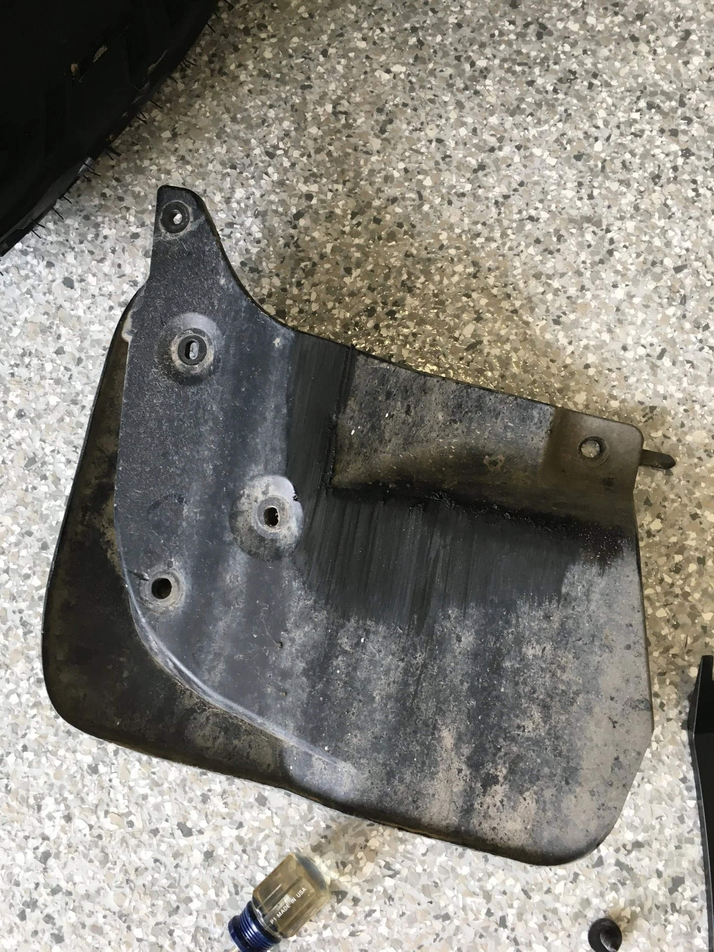

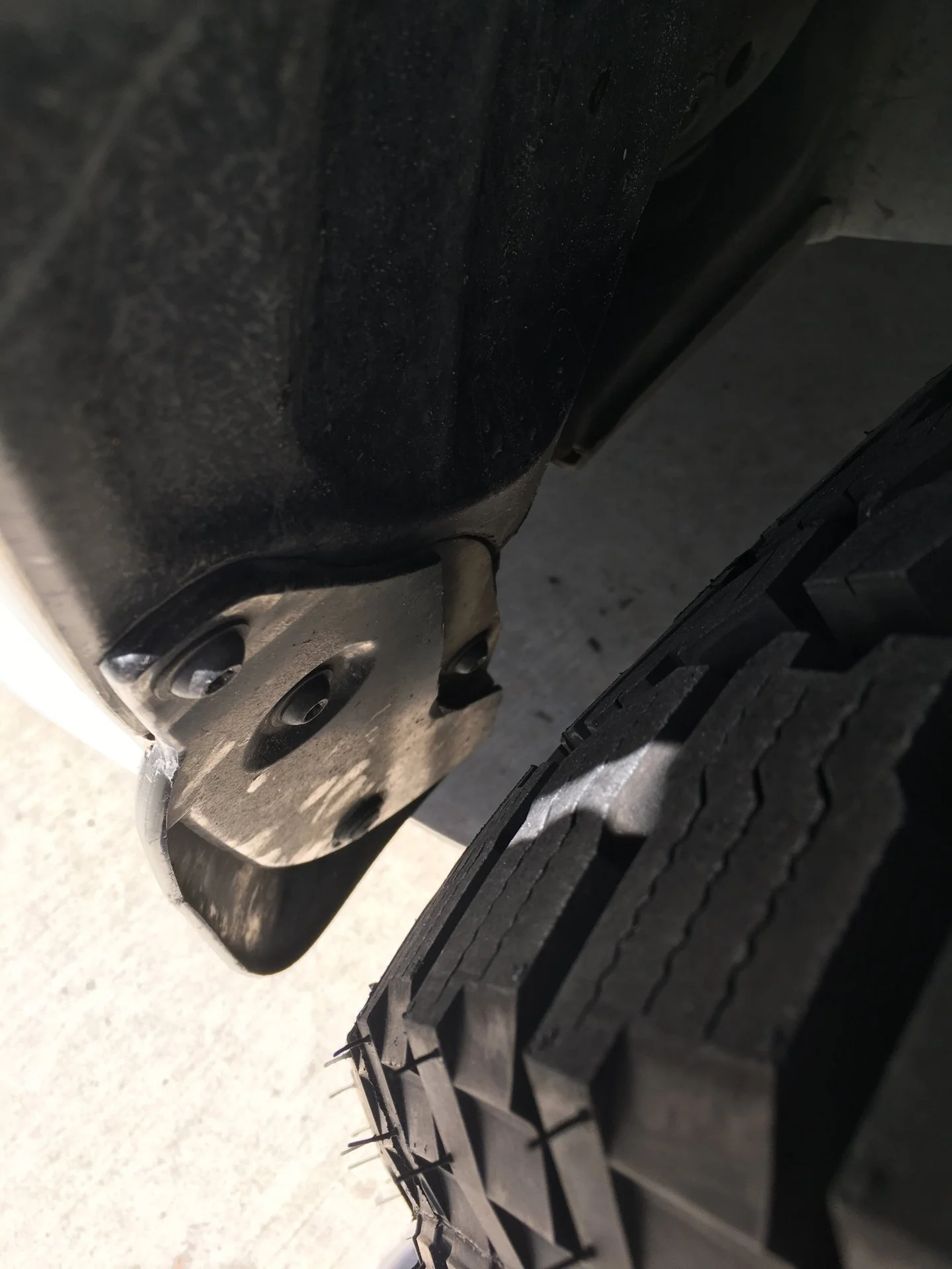

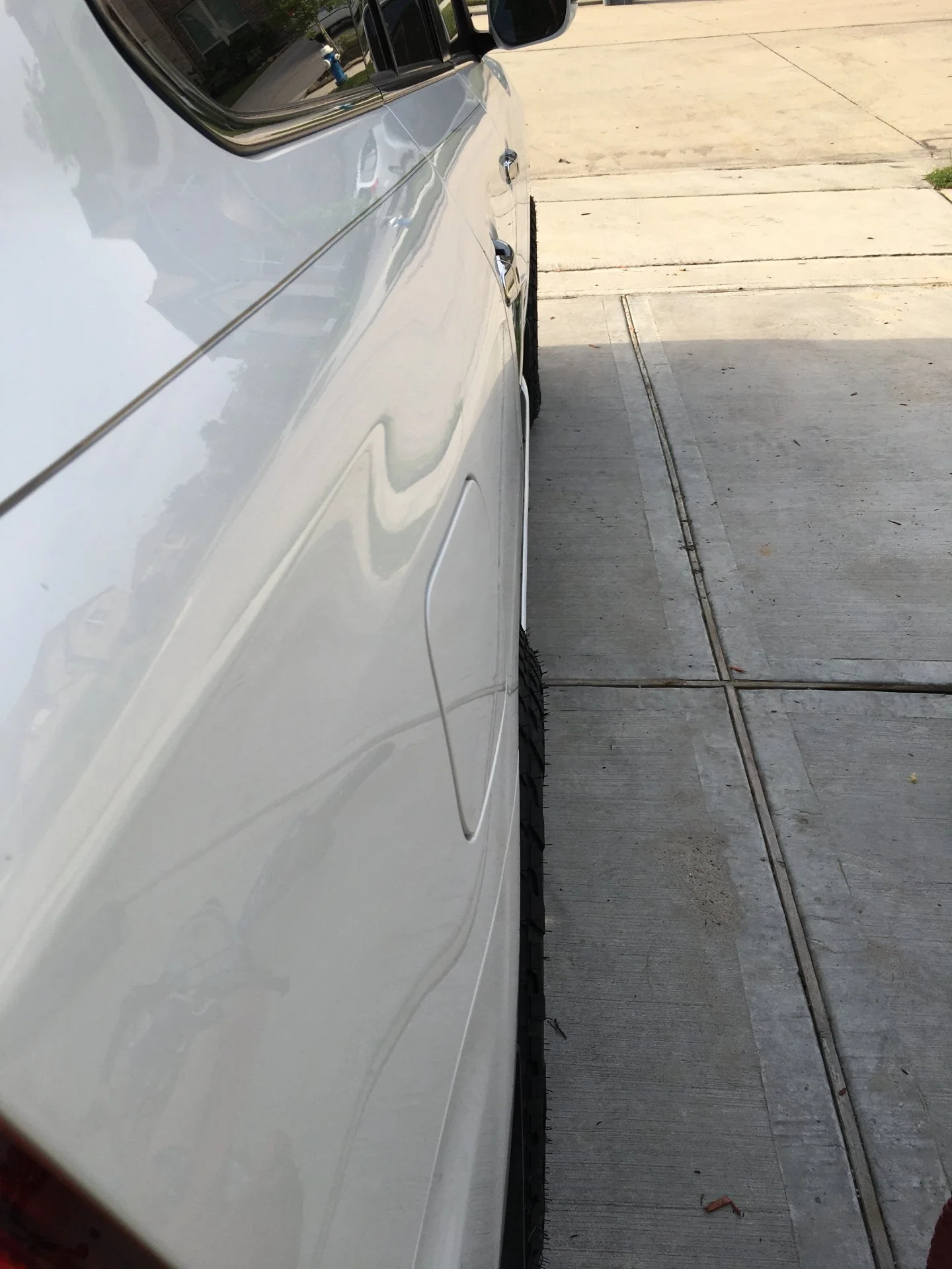

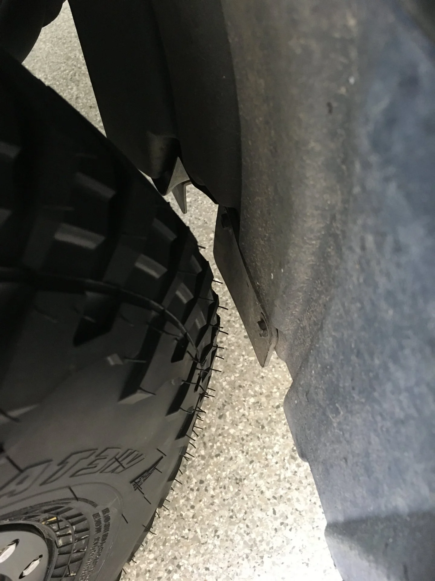

Did it. Icon Vector-5’s. Stock suspension. 285/70/17 E rated KO2.
no mud flap rub. Just a pea sized rub on the front liner at full lock. Will probably move that liner forward when I find the instructions on here. Thanks. Add to the data base. I know for a fact slee and toytec here in CO will talk you out of this set up. Just buy wheels from slee. Drive’em over to discount tire. Have’em toss them on. 30 day return policy!

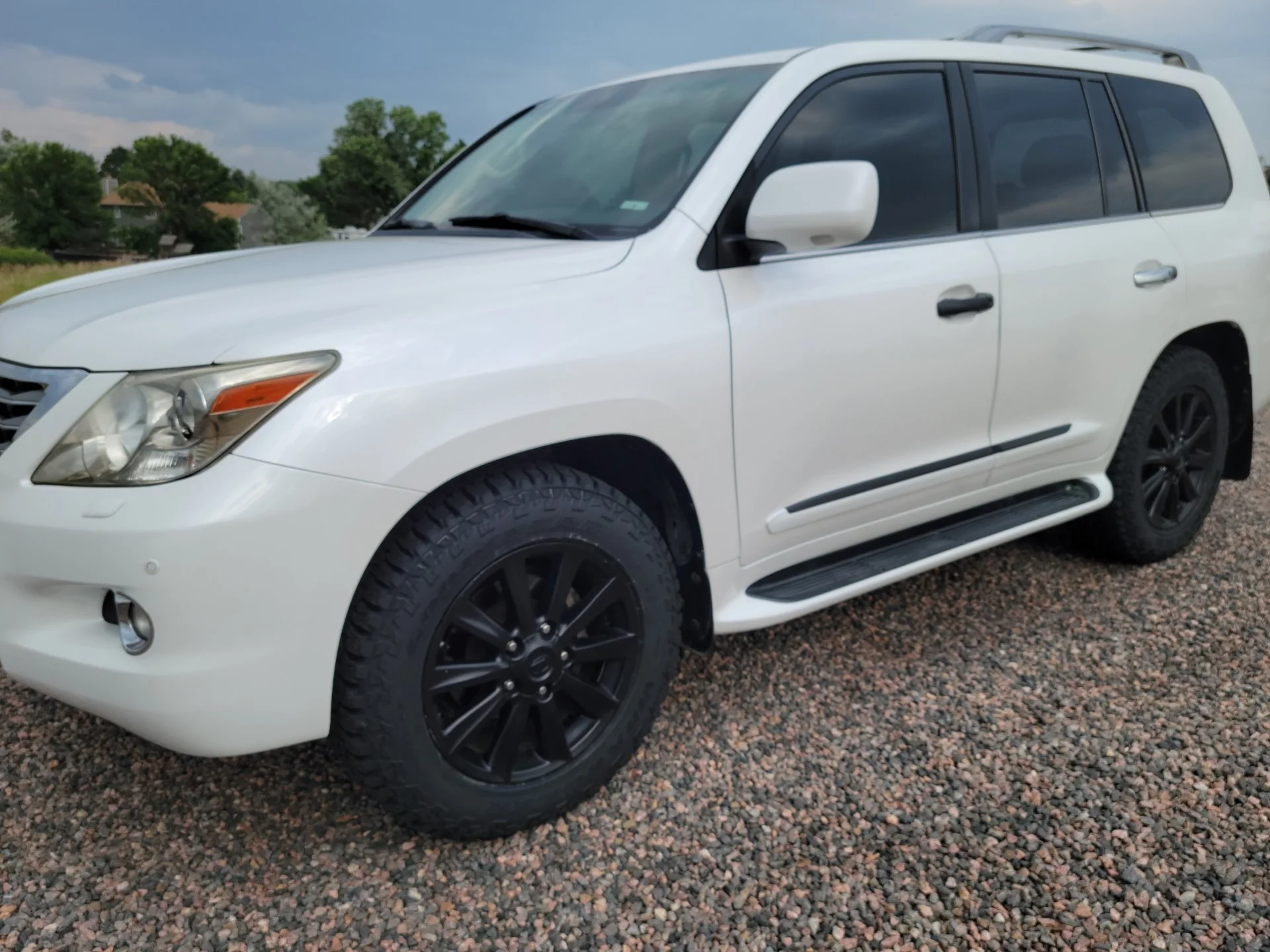

Thought I'd throw my $.02 in with the tire upgrade I just did on my newly purchased 2010 LX. Stock wheels. Previous owner plasti-dipped them. Goodyear Wrangler UltraTerrain 275/60R20 - essentially 33's.
A few comments and answers to potential questions.
-Do they rub? Just a bit during reverse with wheel turned right. Not too bad, & not as much as my GX when I upped the tire size on them. Waiting until I get a proper wheel alignment before trying any mods with flaps/inner well.
-Does it ride better? Hell yes. On a vehicle of this size and weight, the more sidewall the better. Have not really noticed any performance difference between the stock 285s and these 275s.
-Is there more road noise? I really don't notice much although I have yet to really open it up on the interstate yet. From what I can tell, if there will be any, it should be minimal.
Can't wait to give these a run on some good trails.
Eventually plan on getting 18" wheels with 33's, but this was just a quick fix to get rid the awful AS tires that were on there.
I apologize in advance. My photo editing and stitching skills are basically non-existent but here are a few before and after pics.

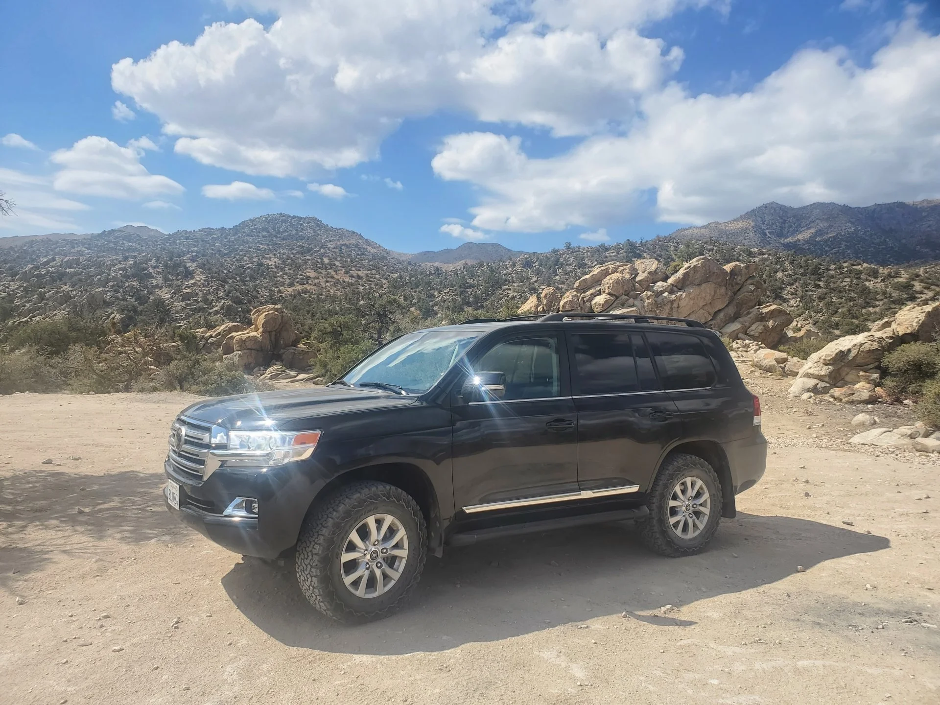

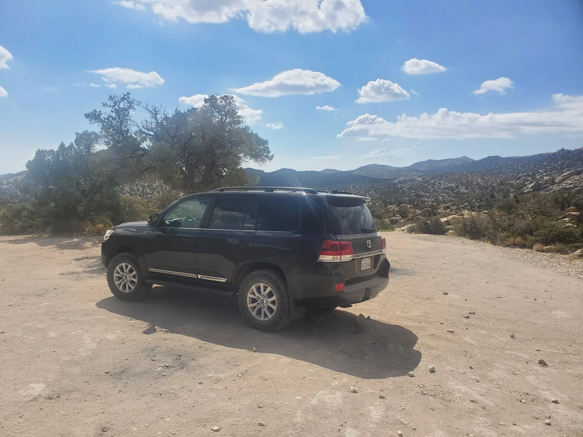

A big thank you to all who have helped build this database! Thanks to the great information here, on my 2020 LC I have installed the OEM front strut spacer, had an alignment done, worked the post spacer KDSS lean out, and installed 275/70-18 BFG AT's. Great ride and no rubbing. I thought someone might benefit from the following measurements. Pictures are all after the spacer and BFG's.
TiresSizePSIMeasuredAdvertised
Stock Dunlop Grand Trek AT23285/60R183530 1/231 1/2
BFG AT275/70r184132 5/833 .2
Fender height measured from level​
ground on wheel center​
Fender HeightStock DunlopsDunlops + OEM SpacerBFG AT + OEM Spacer
DS Front34 1/235 1/236 5/8
DS Rear36 1/835 3/436 11/16
Pass Front34 3/1635 5/836 5/8
Pass Rear35 7/835 5/836 7/16
