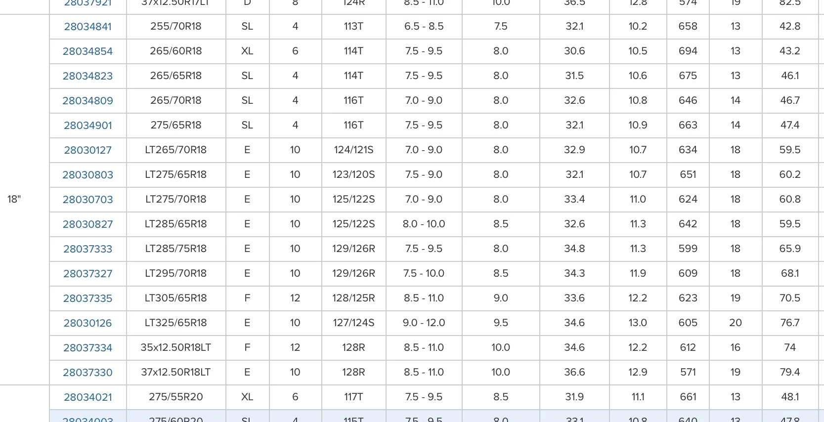

Yes, it does matter. Here's the pertinent specifications page that shows the acceptable rim widths for the LT285/65R18 Toyo Open Country ATIII tire:
Further, the TRA (Tire and Rim Association), the folks who set the specifications for all things tire and rim (wheel) related, list the following "Approved Rim Contours" for all LT285/65R18 tires:
8 1/2 J, 9 J, 9 1/2 J, 10 J

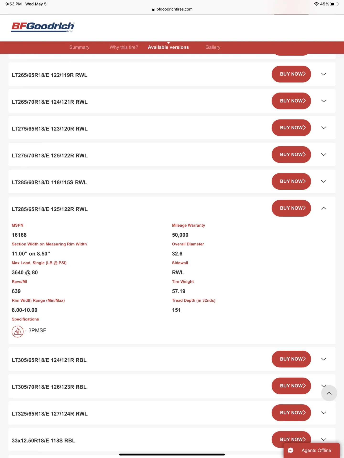

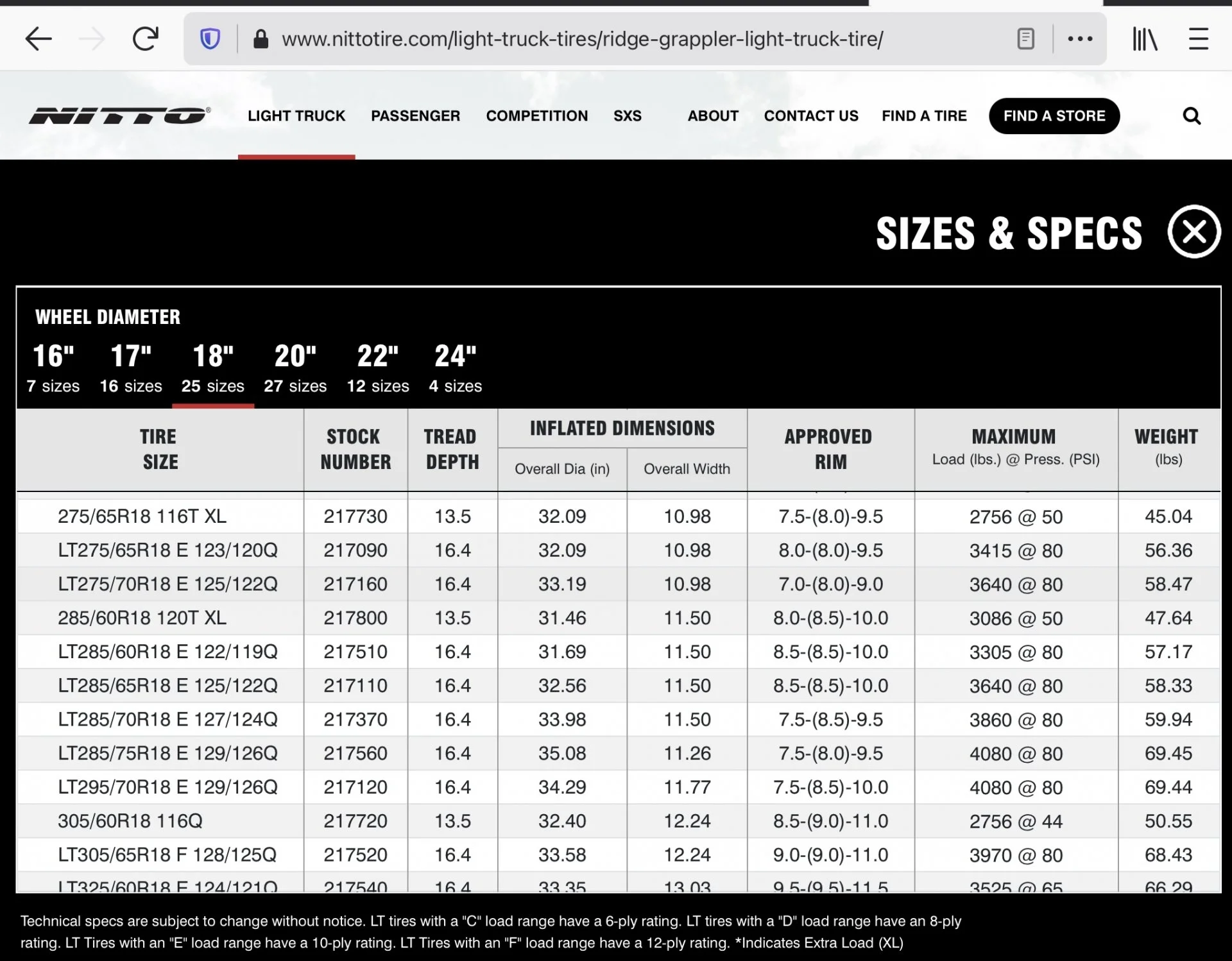

I was hoping to size up to 285/65/18, (sure....looks). but not if it’s unsafe somehow. Why do you think Michelin & BFG allow the 8 inch? Am I misreading? I looked for the 2021 TRA yearbook but it’ll take a bit to get a freeware copy.

I think you raise an excellent question, and provide some great examples of why it is important to go to primary sources for this kind of information if it is important to you.
I started purchasing the TRA Yearbooks in 2014 and update to a new one every three years, so now I have the 2014, 2017 and 2020 Yearbooks. I do this because the information and specs do change from time to time, and I like to have the latest available.
Looking at just the "Approved Rim Contours" for LT285/65R18 tires I find the following:
2014 TRA Yearbook: 8J, 8 1/2J, 9J, 9 1/2J, 10J
2017 TRA Yearbook: 8J, 8 1/2J, 9J, 9 1/2J, 10J
2020 TRA Yearbook: 8 1/2J, 9J, 9 1/2J, 10J
So, it appears that anywhere you see 8-10 instead of 8.5-10 as an approved rim width for this tire size, you are looking at an outdated spec.
HTH

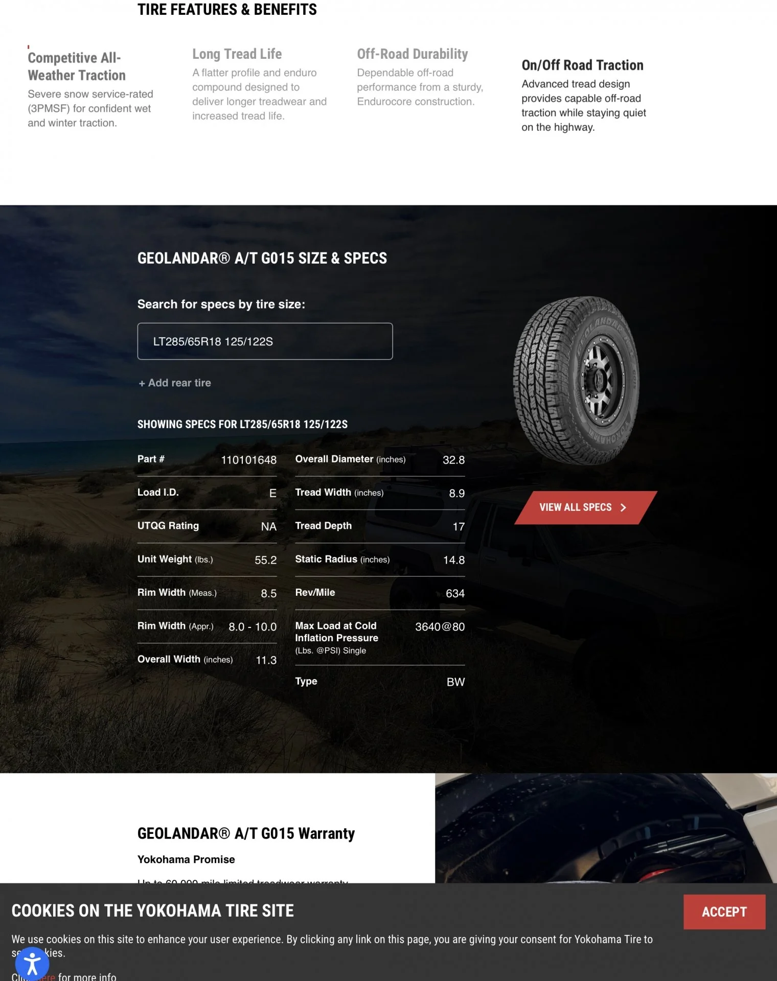

Falken AT3Ws 285/65R18 also support an 8" wheel.
Personally, I would have no problem using the Toyo AT3s on an 8" wheel. There's plenty of margin and load capacity to work a bit outside of the box.
An e-mail reply from TRA confirms the standard changed from 8.0 to 8.5" due to a harmonization around LT tires to current TRA guidelines. However, previously approved rims and use of the 8.0" standard are grandfathered. This is listed in the Supplementary Service Data section.
"Therefore it's [8"] still an approved rim contour, but viewed as a superseded standard."

So, my take is as the Toyo and Nitto are newer registrations, thus using the latest standard. But the others are up to date as of their registrations- to explain the manufacturer charts.
Toyo Technical support also reconfirmed their 8.5 -10" listing.
So anyway-...all in all...while the 8" is probably just fine, and I wouldn't question anyone who installed such. I'll skip it and use it as an excuse to find some 8.5 or 9 rims I like.
