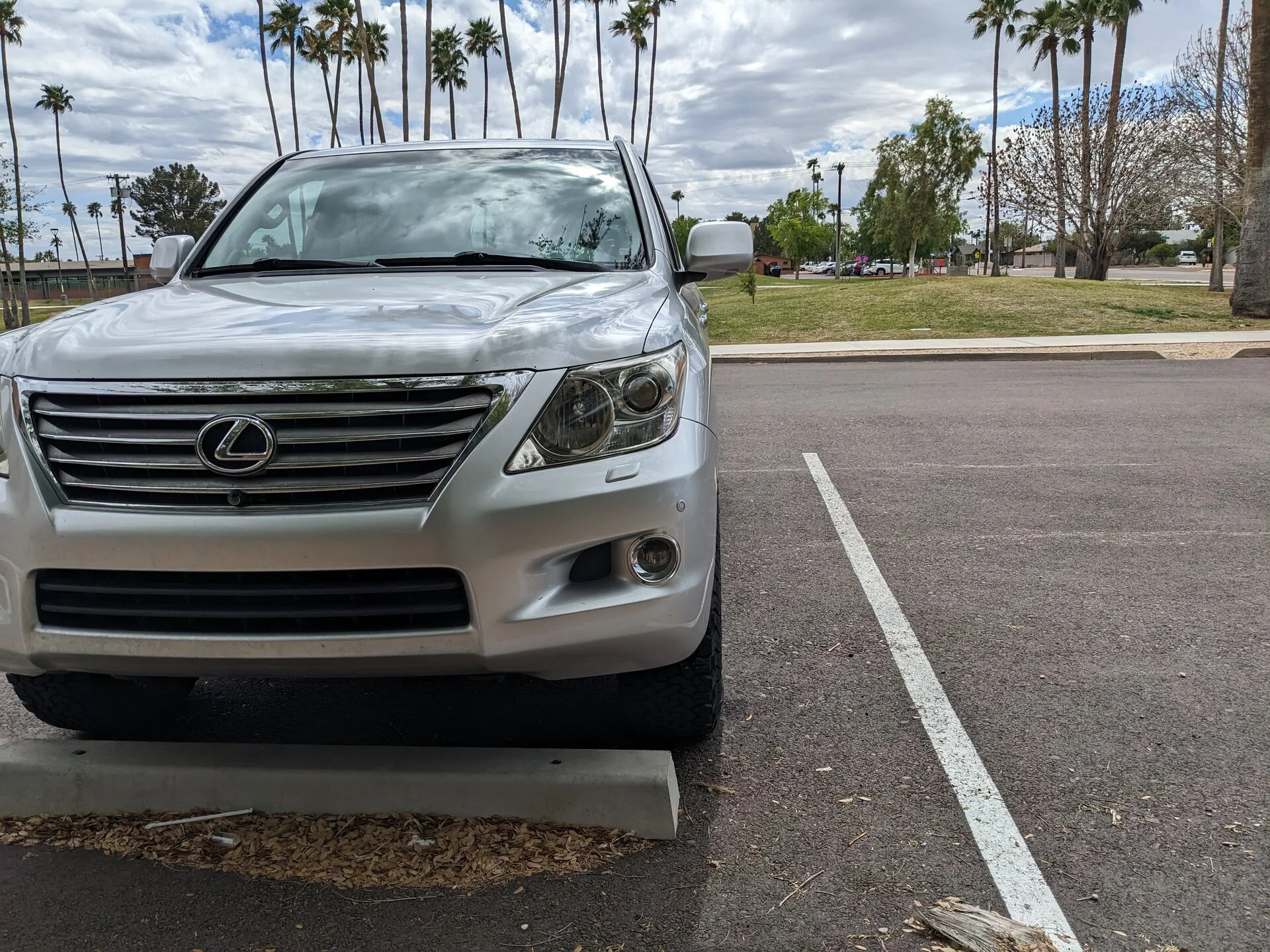

Looking for some feedback to see if I'm missing anything before I buy new tires. I have a 2009 LX and currently have 275/55/R20's, but just finished removing replacing the AHC with new suspension (Fox 2.5" coil over front, Icon spring / Fox 2.5" rear). Picked up 17x8.5 Method 703's with 35mm offset, and was thinking of going with 285/70R17 since that's what I've seen around on the OEM Rock Warrior wheels and also the Lexus J201 concept. Not looking for max tire size or something that requires a bunch of work to fit or leave me wanting a re-gear. Spent some time reading the BFG 285/75/R17 thread and that didn't convince me it was worth it to go with the 75 over 70. Just wanted to hear everyone's thoughts before I finalize my decision. Appreciate the help, thanks!

I think for your reasoning the 285/70R17 will be perfect. Shouldn't take anything to fit and is just big enough to look like the right size for the platform.

I don’t know much about that suspension setup you’ve got but i would say depends on the amount of lift. 33s good to my eye up to about 2”, then start to look surprisingly smol.
At full sensor lift equivalent they are spot on, and you dont want to go much past 34s without thinking of gearing on that year range.
Otherwise platform was practically built for 33s. My 2 cents anyway.
- guy who went 33 and should’ve gone 34. Currently stuck wearing out these shoes…

Thanks for the feedback, that's helpful.
I should have taken measurements of mine before, but after the new suspension my front hub to fender is ~21.75" and rear is ~22.125". Based on what I've seen some other folks post online I think that's about 1.5" of lift in front and 1" in the rear; that said I wouldn't call that a precise measurement because of how the fender angles.

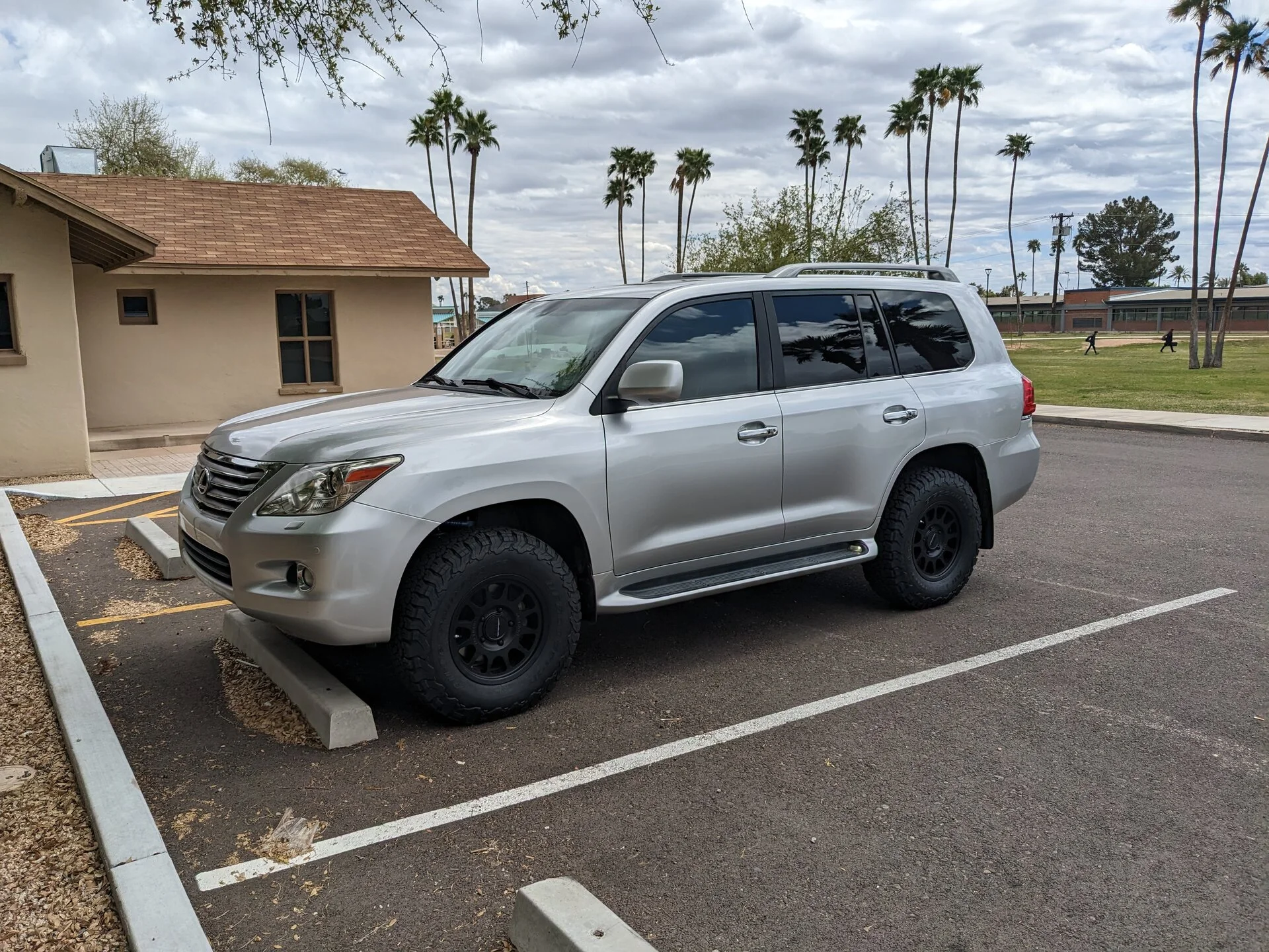

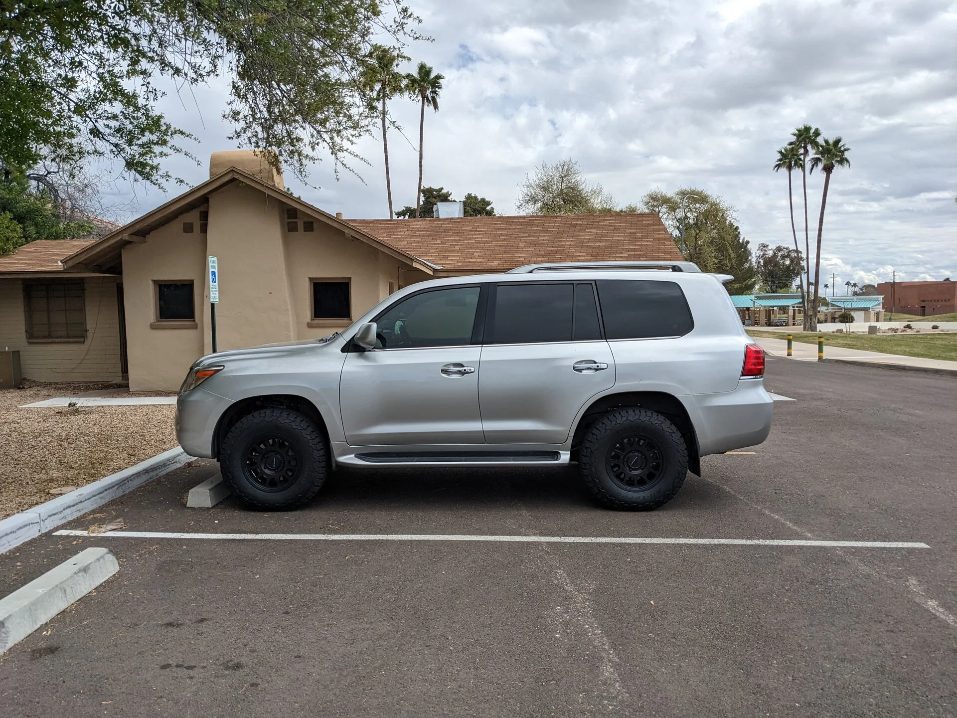

Went with 285/70/17 BFG AT KO2's (Load Range C) on Method 703 +35mm offset. LX with 1-2" of lift after AHC delete and new suspension (Fox 2.5", Total Chaos Upper arms, Icon rear coils). Exactly the offset I was looking for. Does rub a bit at full lock in the front on the mudflap and front of the liner, but not too bad and just in reverse. Should mostly go away once I trim the steps for sliders. Thanks again for everyone's help.
View attachment 3286617View attachment 3286618
A near perfect fitment for the 200! Well done.

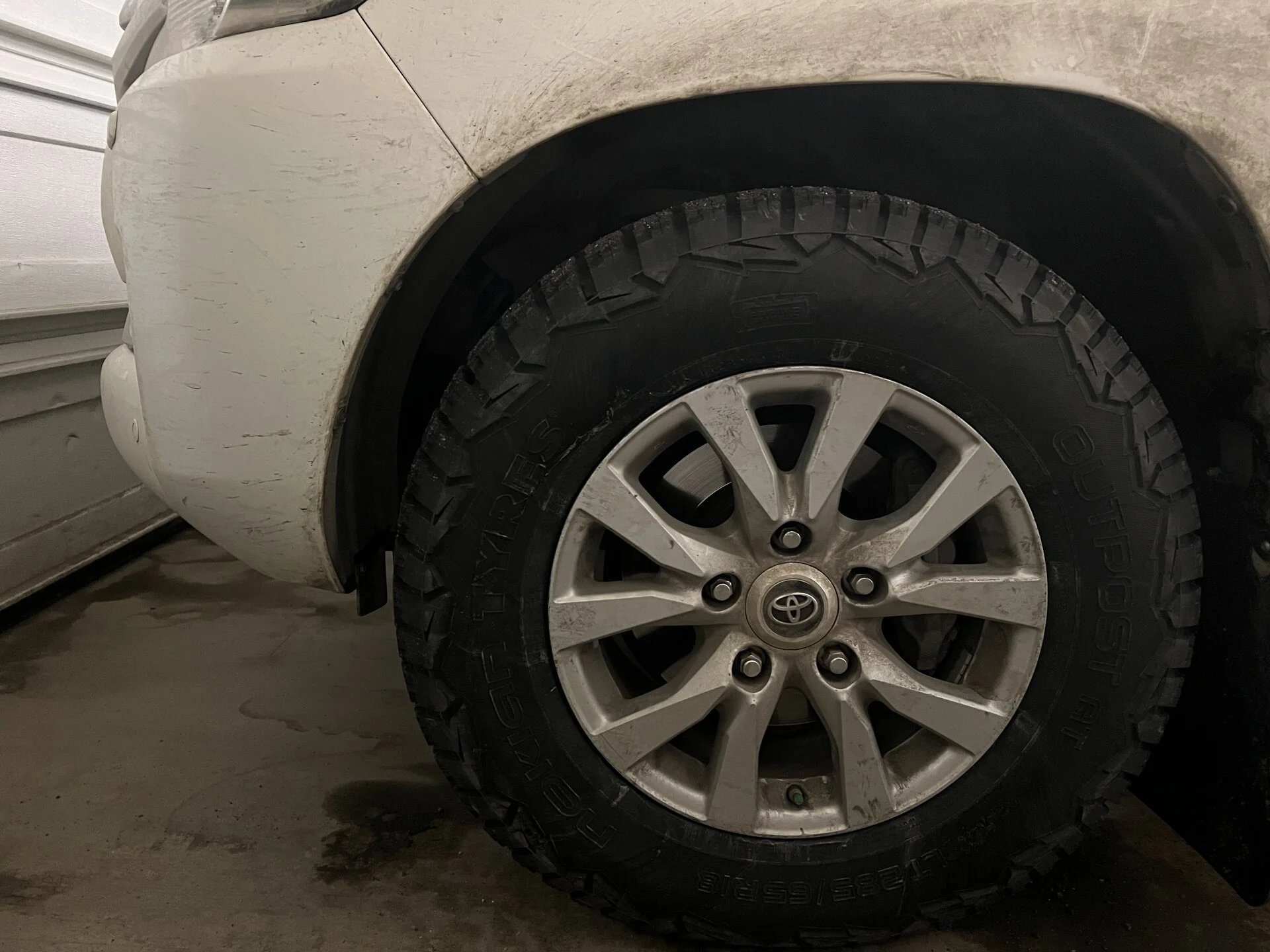

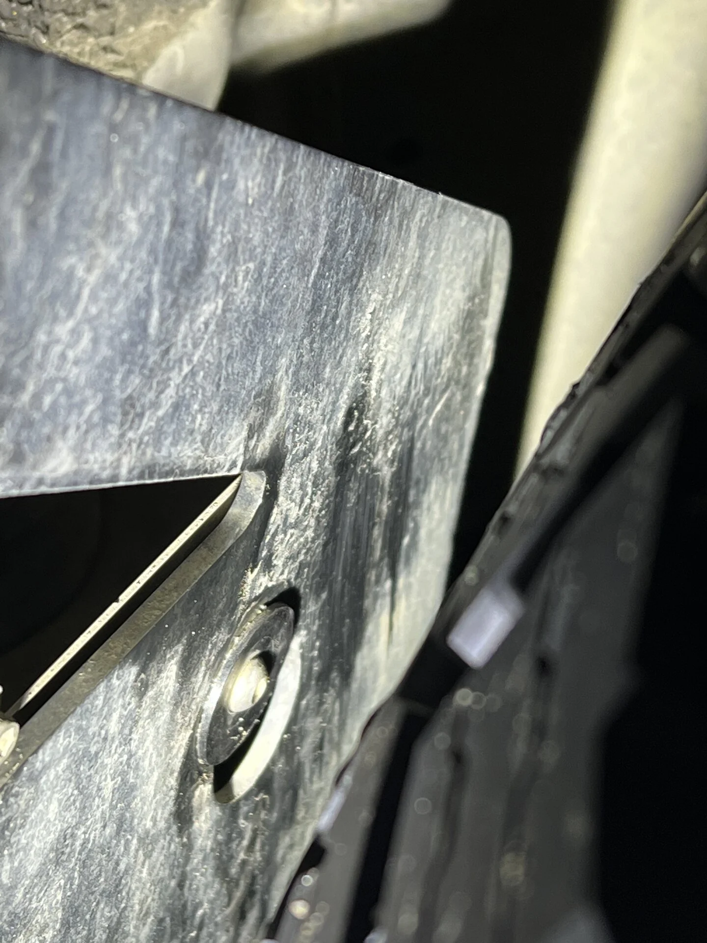

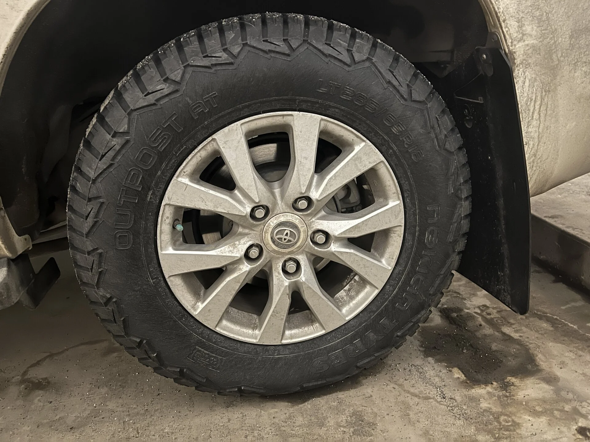

I finally replaced the stock tires on my ‘18. Stock suspension, I do have @Ramathorn15 ASAP flaps. Went with Nokian Outpost ATs 285/65r18. The tires rubbed somewhere when in reverse pulling out of the tire shops bombed out parking lot, but haven’t had any more since then. Only have 8 miles on them so not much to say about them yet. It’s the breakup up here in the north so I’m sure I’ll have them out in the mud soon enough.
Had a late spring snow show up in the Anchorage bowl and had the LC out for a fishing trip and can confirm the 285/65r18 rubs on the inside corner of the ASAP flaps. Not sure if the stock flaps would make more room. I’ll try bending the bracket inward slightly to make some room.
