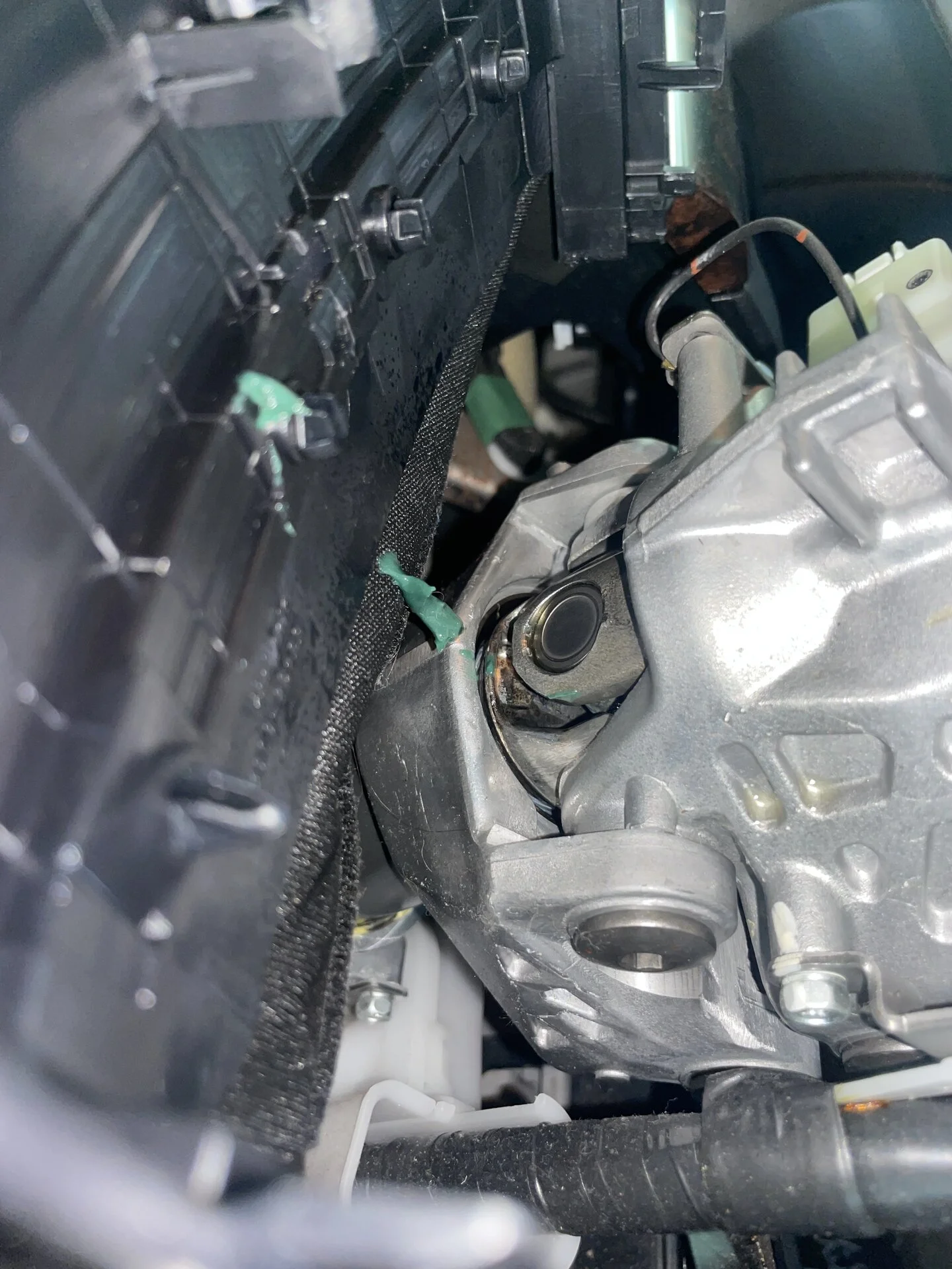

On start up the steering makes this horrible whine. Doesn't make sound when turning, Motor seems to work fine, doesn't make sound while telescoping, just the up and down movements. Before I start digging in I wanted to reach out to the interwebs to see if anyone else has dealt with this.

Think I got it. Took the column cover off and there is the main joint. Kinda looks like a u joint, and then a threaded rod thingy. Greased both and seems to have addressed it.
Don't know what grease you're supposed to use but I used my park tool green grease.
White lithium from a tube is probably the best bet, but park is good enough you probably won’t have any more issues.
