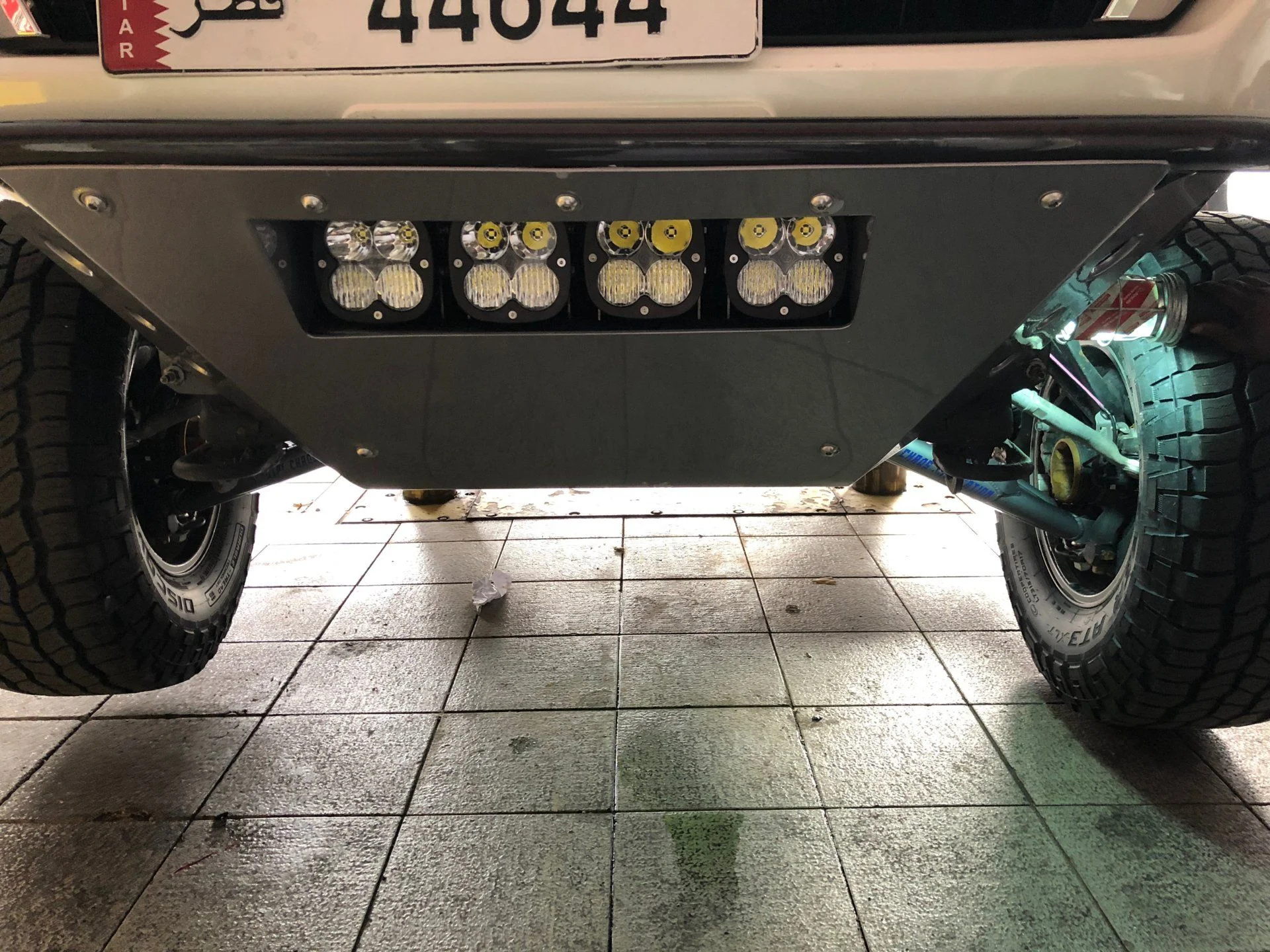

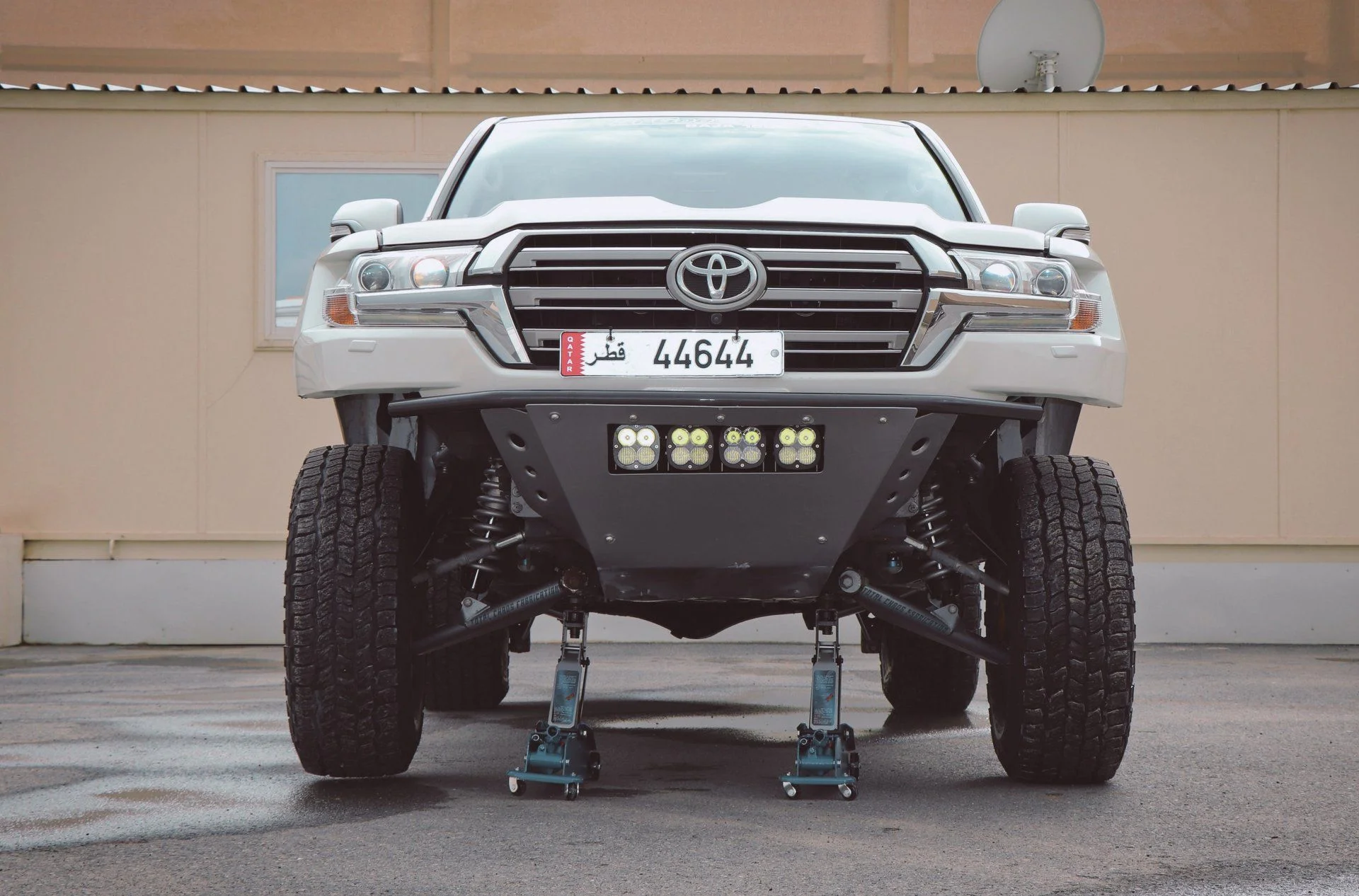

Forgot to post about the limit strap removal that I did last month. Since it yielded significant gains on wheel travel surprisingly.
Since I have removed the front differential, I do not have to worry about the CV Angles anymore, so no need for a limit strap. The rebound damping is pretty heavy right now so no need to worry about the shock getting damaged from top outs.
Removing the cam burg limit strap increased down travel by 1.75 inches. That's a 12.5% increase in wheel travel just by removing two screws!
You can also see how much of a change it made:
Left Side with limit strap, right side without limit strap.
1996135
1996138
1996140
Prerunner LC200:
A couple questions if I could:
  • Are you running the center diff locked all the time, or have you swapped your transfer case to a non full time 4wd case?
  • Do you happen to know the total travel you were getting while still running the front differential / axles? Often times the advertised travel vs actual are a bit different and I am curious what the kit actually gives.
  • Any chance of getting whomever made you those fenders to make more?
Thanks, great work on the it !
See below in green
Yes, since I did not change the transfer case. I have to run with the center diff locked all the time or else it wont move
Before I removed the front differential, when it was stock 4WD. I had around 13-14 inches of wheel travel, the extended total chaos axels were maxed out at that travel.
*However I still have to ensure that it is cycling the full uptravel before hitting the factory bumpstops. I need to do some work on that, put it up on a jack, unbolt the coilover and cycle the wheel travel to ensure it is using every bit.
The fenders were made my a local store here in Qatar, called Offload store. I am not sure if he made them himself or relied on another workshop or body shop. I would have to ask him to get the details.
See below in green
Thank you very much for the reply, that is very helpful for me as I will be staying 4wd but couldnt decide if I wanted to simply go with the tundra arms or do a full TC long travel kit.
Considering I believe I can get 12" of travel out of the tundra arms it is probably not worth the extra $ for another 1" or so of travel.
Again, great looking truck, I love seeing it in the air!
Anytime !, Thank you for the kind words. Good luck with your project.
