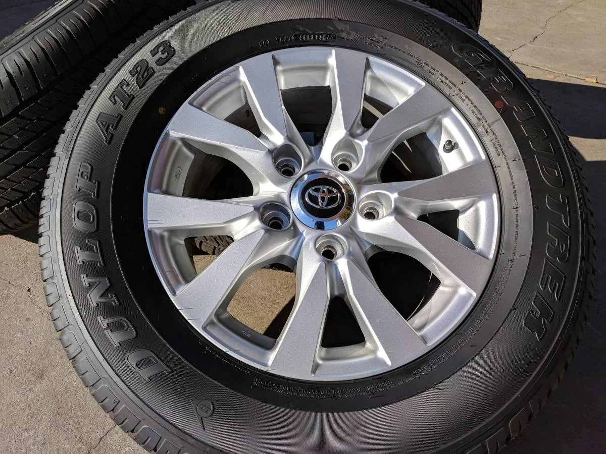

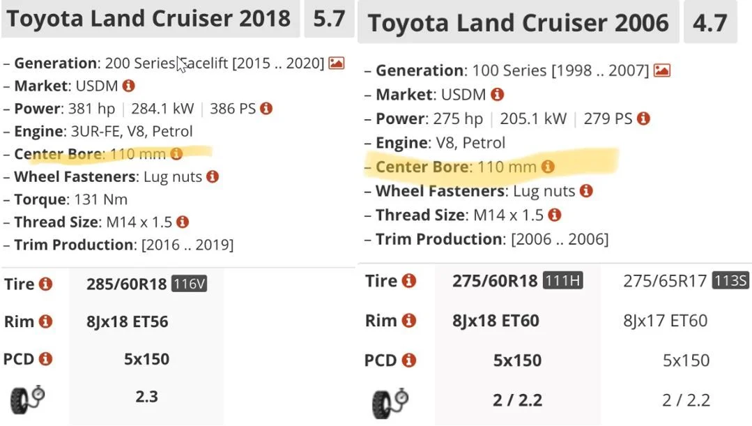

Recently acquired a 2006 100 series and not super fond of the 18" chrome 5 spoke weeks. I have a lead on a set of 18" wheels from a 2018 200 series and although I have not put my hands on them, everything I've read says they are 'virtually' the same and should bolt up: 18x8 ET56, 5x150 bolt pattern, 110mm center bore. Only difference I can see is the wheels on the 100 are 18x8 ET60. I don't believe this 4mm makes a difference in offset but not certain. I cannot find one pic of a 100 series with these wheels mounted which leads me to believe there may be an issue I'm not seeing. (besides TMPS sensors). I'm planning to drive an hour to pick them up later this week so wanted to run this by the experts before I hit the road.

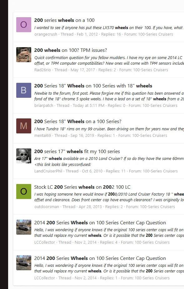

Yup, I read most, if not all of those posts but could not conclude with certainty there won't be fitment issues. Some say 'yup, they fit, but might need to trim center cap' some say, 'should work but might need a spacer' , etc. I'd just love to see one picture of a 100 series with 2018 wheels bolted up to put my mind at ease. Either way I'll drive the hour to check them out and if they bolt up with no issues I'll be sure to post some pics and if not, I'll come back and report on what fit and what didn't. ;-)

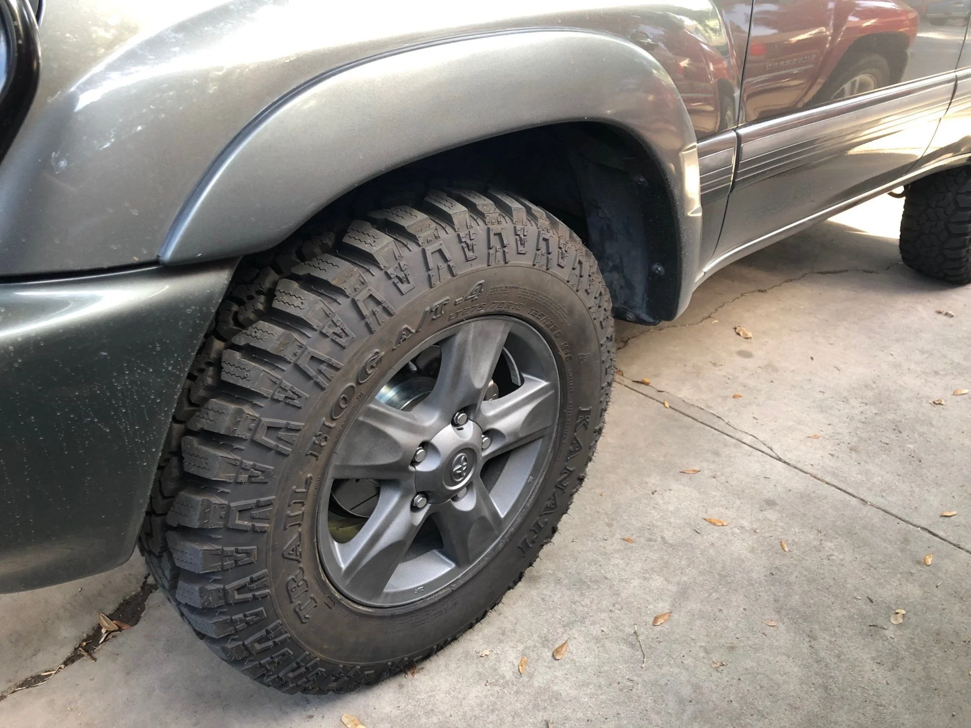

the wheels will fit.
the center cap needs to be trimmed to fit.
Wow, those look great! Nice color combo! These are the wheels I'm going to check out, looks like yours have more clearance around the center cap....we'll see!
Yeah, that looks problematic doesn't it. I guess I'm confused about the center bore spec being 110mm for both wheels. I'm gonna have to pull a center cap off mine to see if that provides any clarity
