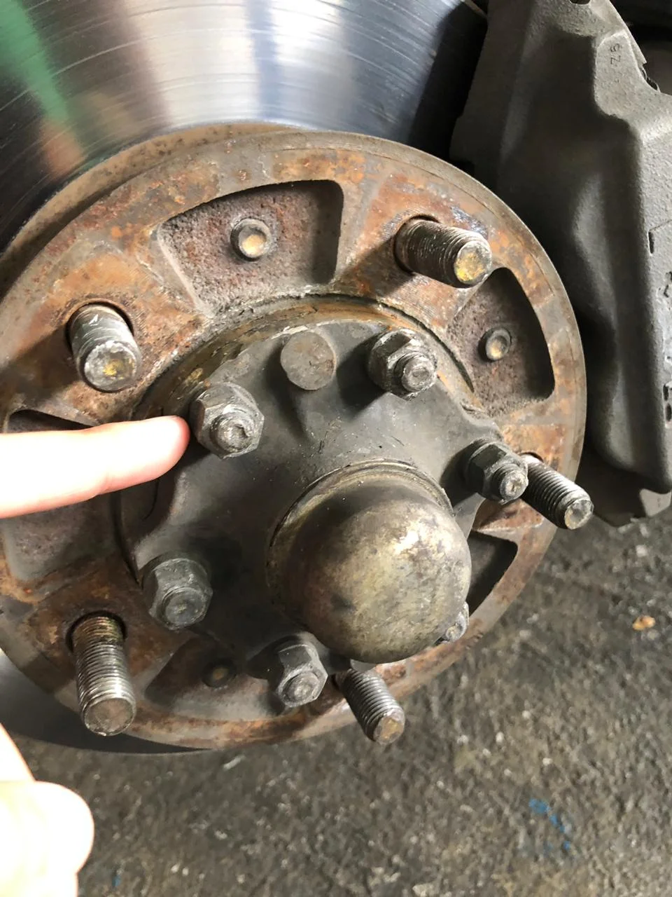

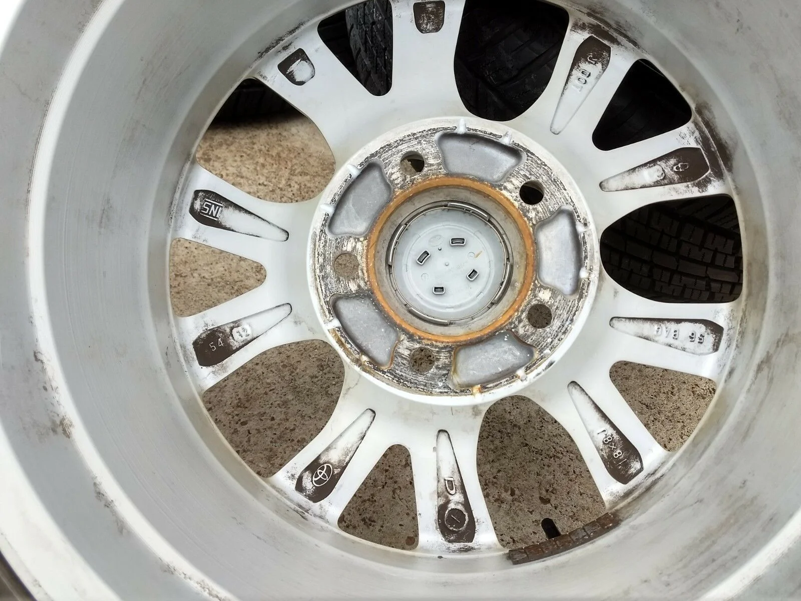

I grabbed this photo online but they are the same wheels I have tried to fit on the 100. 2016-up 200 series OEM wheels. Notice the small center cap. It won’t clear the 100 hubs. It won’t even clear the 2008-2015 200 series front hub unless you remove the hub cover.
Is it just the outside of the wheel? Meaning, it still has the same 110mm bore on the back where it indexes on the hub, but then is smaller on the outside face?
Yes I believe it has a 110mm bore but it tapers down towards the cap. Looks like it will fit if you use wheel spacers.
Interesting and thanks for all the details. The truck actually has spacers so I’m thinking they might work. Hmmm.
