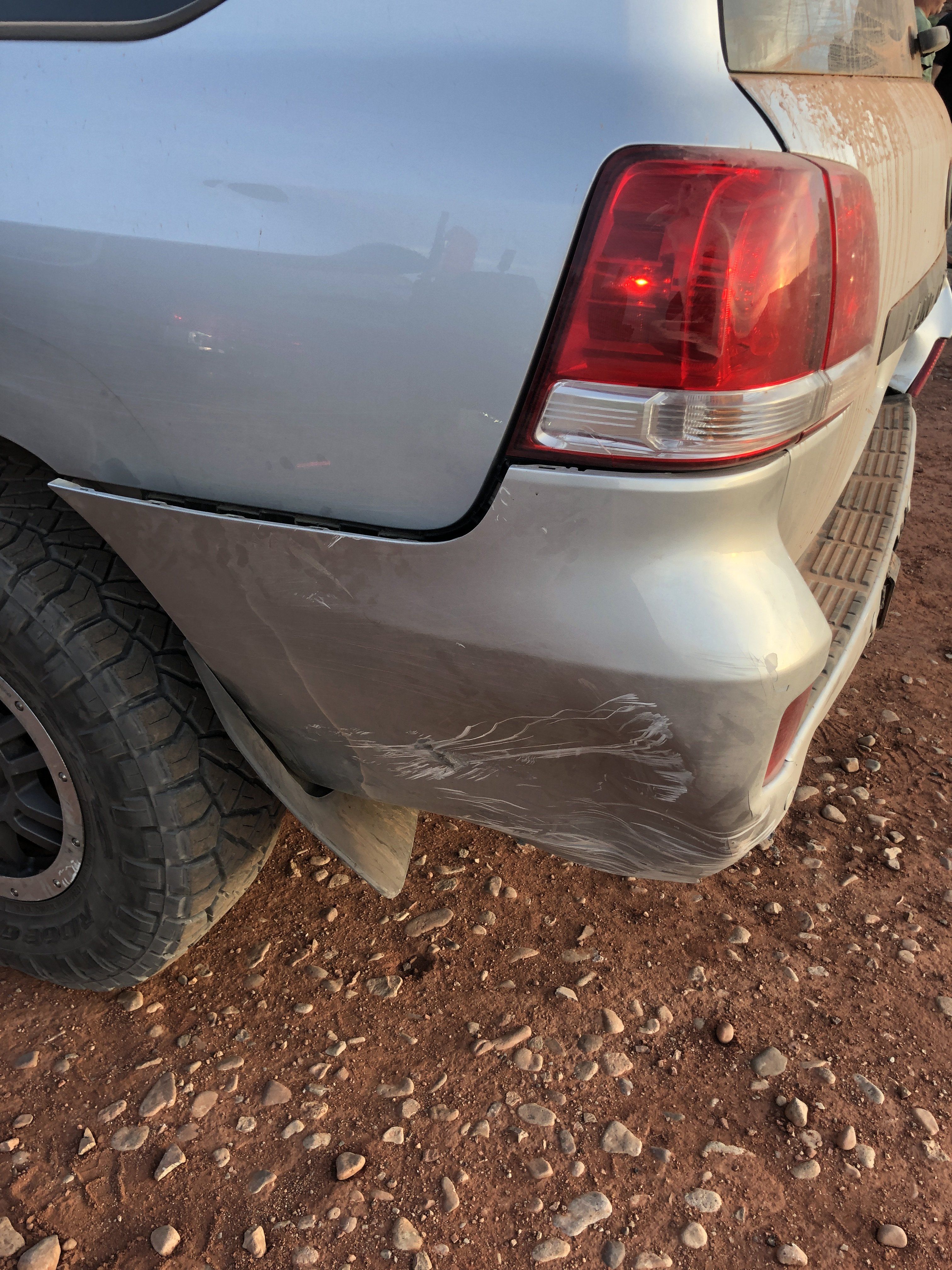

Yes I drove 75 on the highway today and it made no new noises.... the bumper is solid as ever.
Haha and no it’s not a lease :)

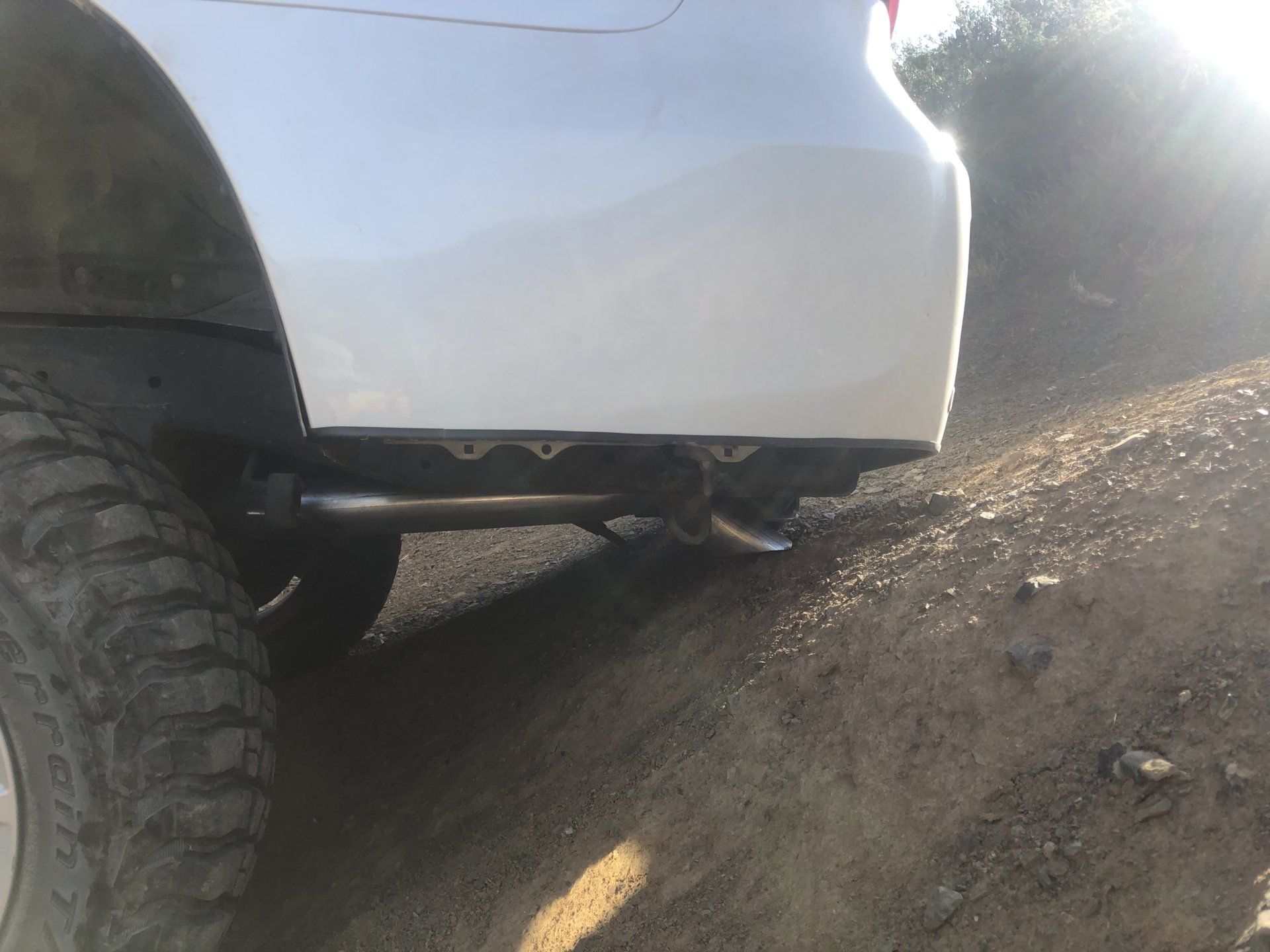

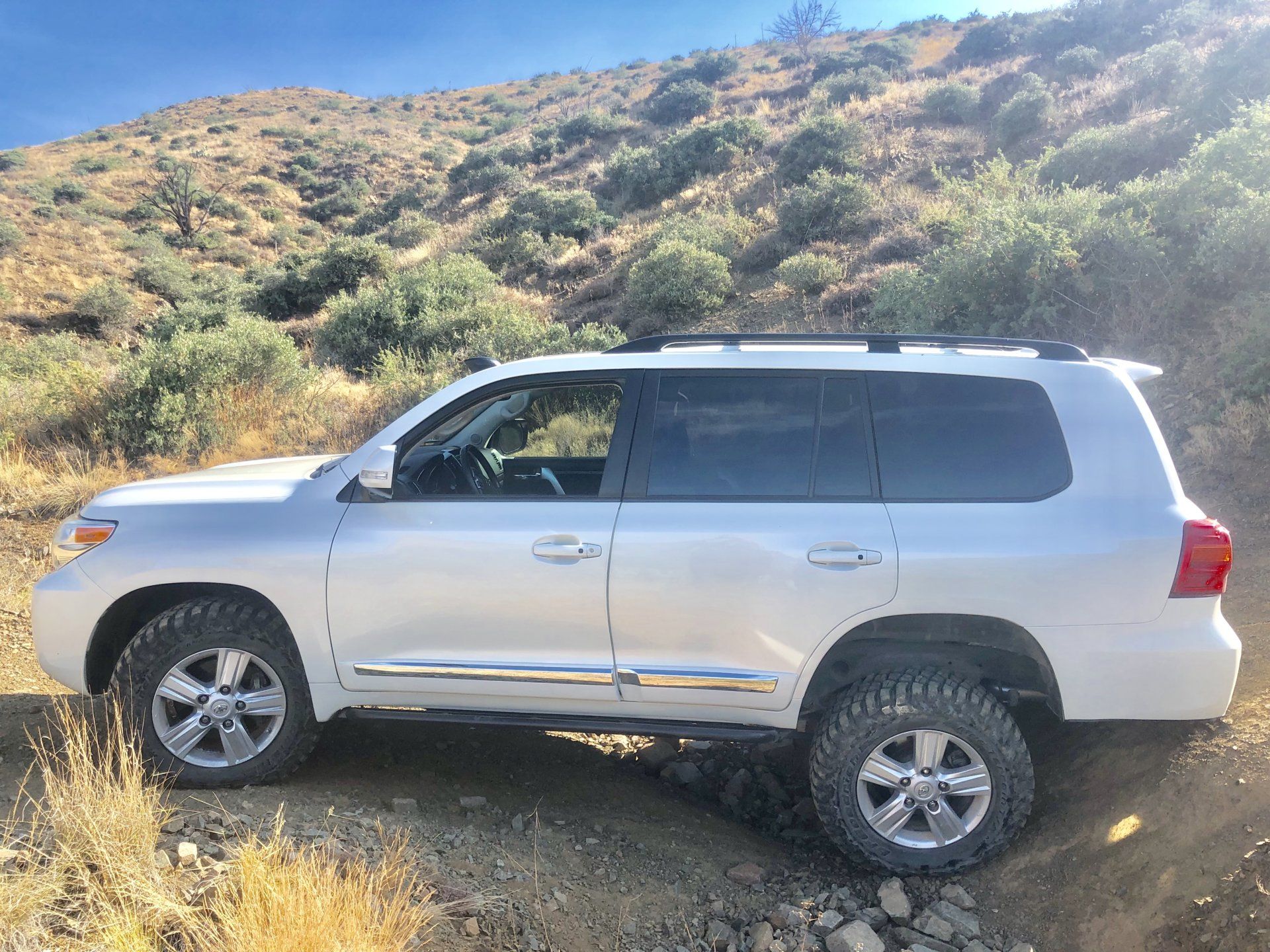

Headed to the bumper chop proving grounds today and it worked exactly as planned.

Wish you posted this a little earlier...Not sure if it would have saved me though. I ended up finding an almost new steel rear bumper for sale in the classifieds, so it all worked out. I would encourage anyone with stock bumpers who wheels their 200 hard to follow @FlightMedic178 's lead on this. Nice work!!

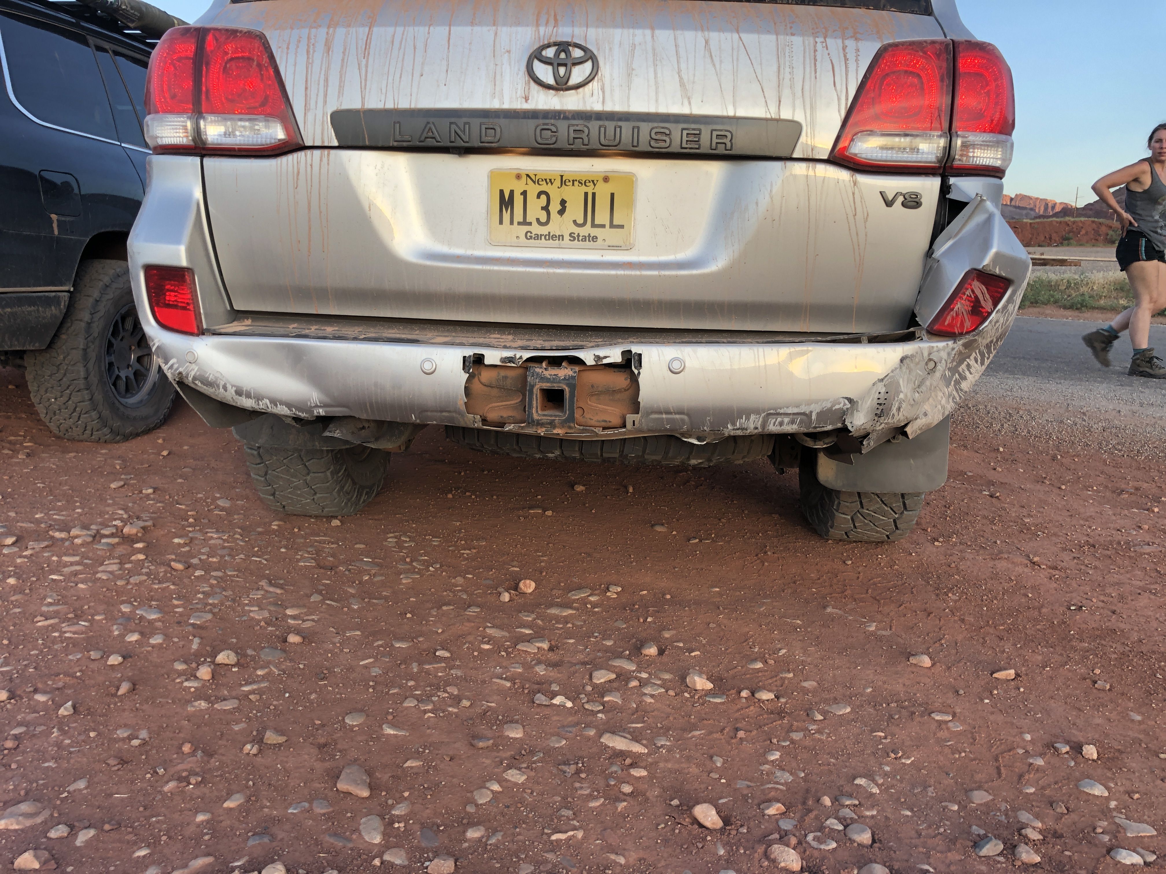

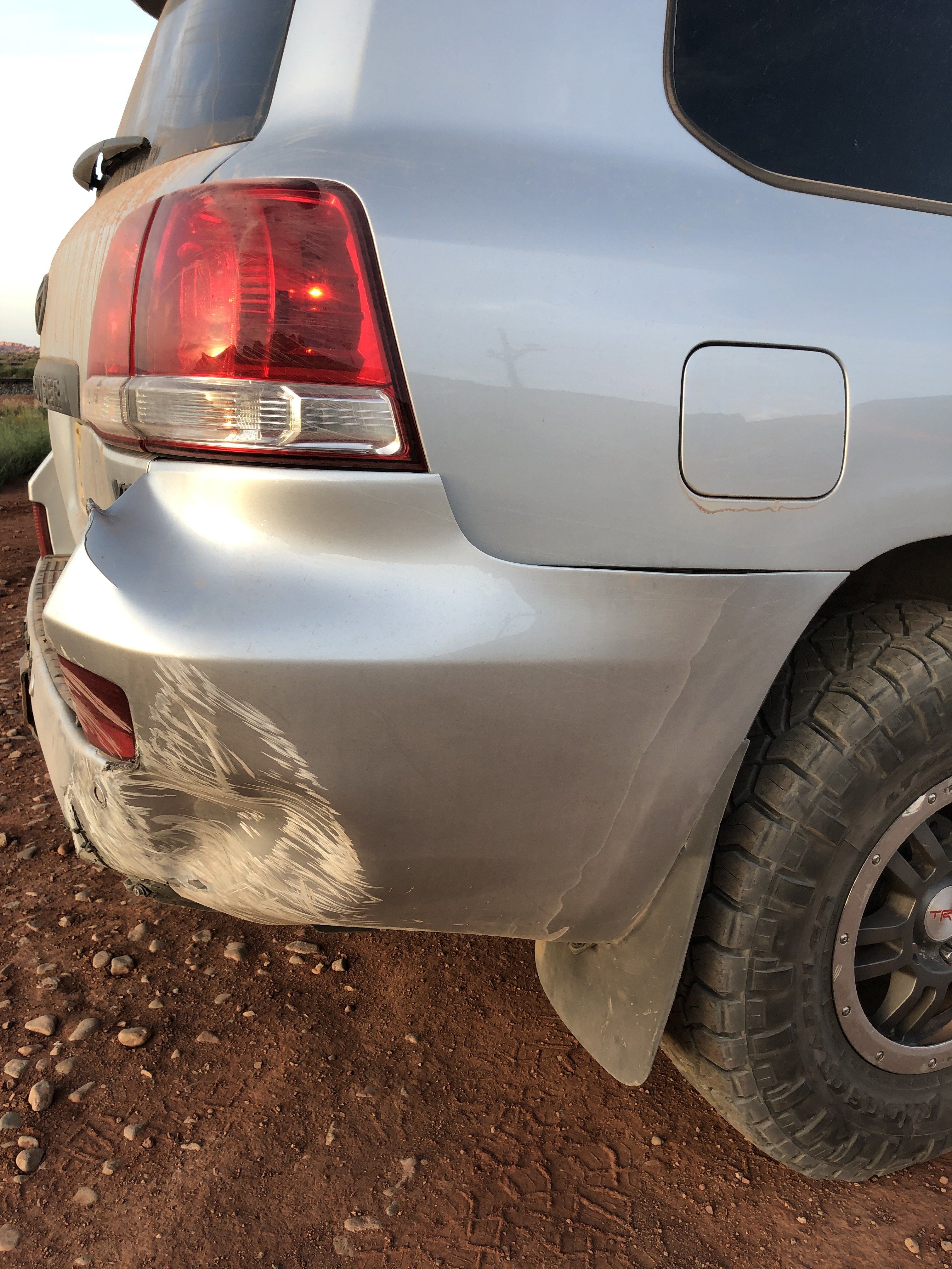

Did you at least avoid taillight damage? Seems like I read on someone’s rig abusing the bumper did more damage than just the tupperware..
I have not seen any new damage on the taillights from this trip. In Tahuya State Forest (Events/Trails - DeGen19 - PNW/Vancouver B.C.) I got a tiny crack in on of the lenses. Couldn't figure out if this was from hitting a branch or from something else.
This weekend I'm going to hit the bumper with a heat gun and see if I can get it back into shape before my steel bumper install.
Just occurred to me.. are you worried about the new edge catching on stuff and pulling back/up vs just kinda sliding over things?

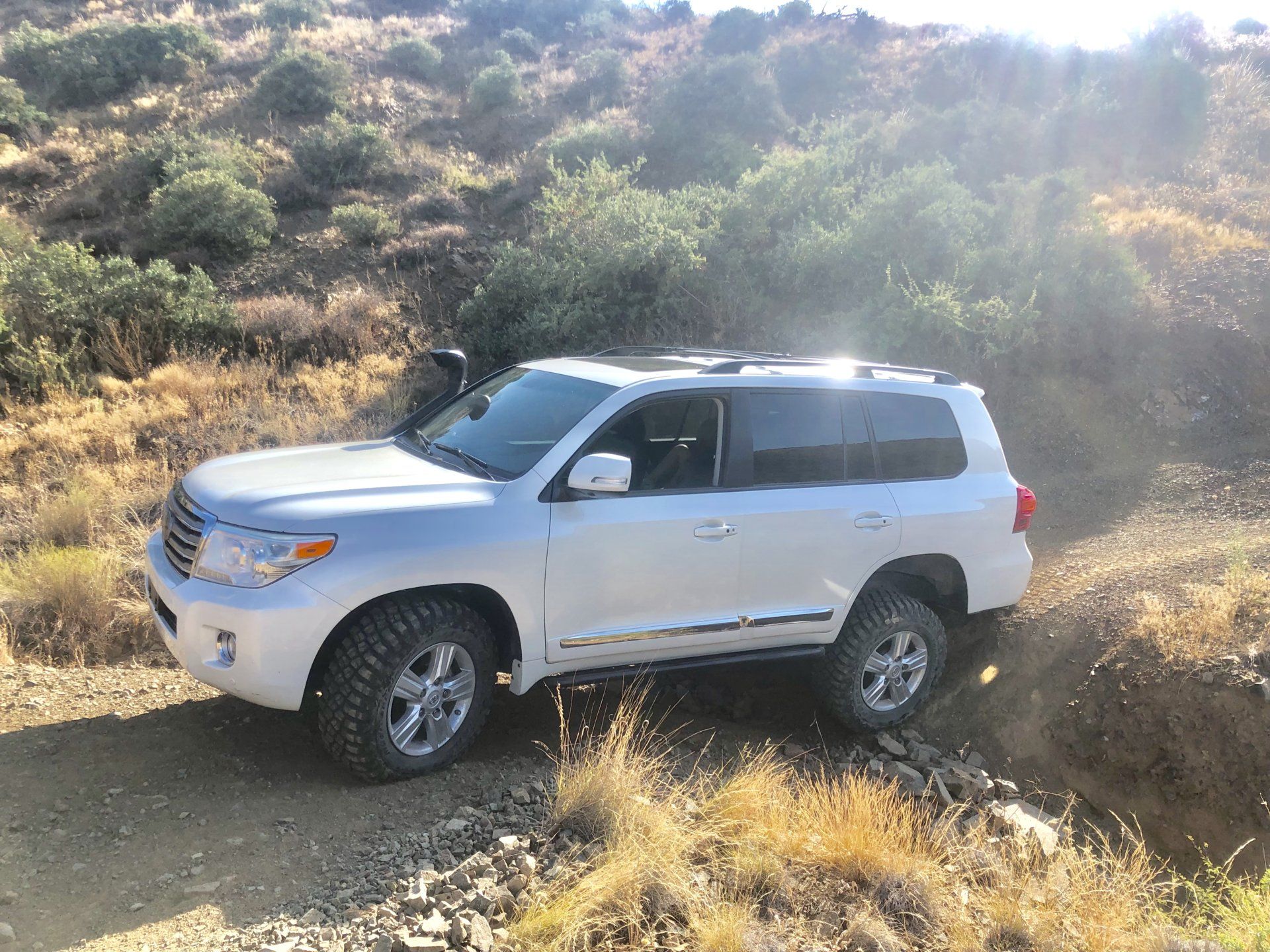

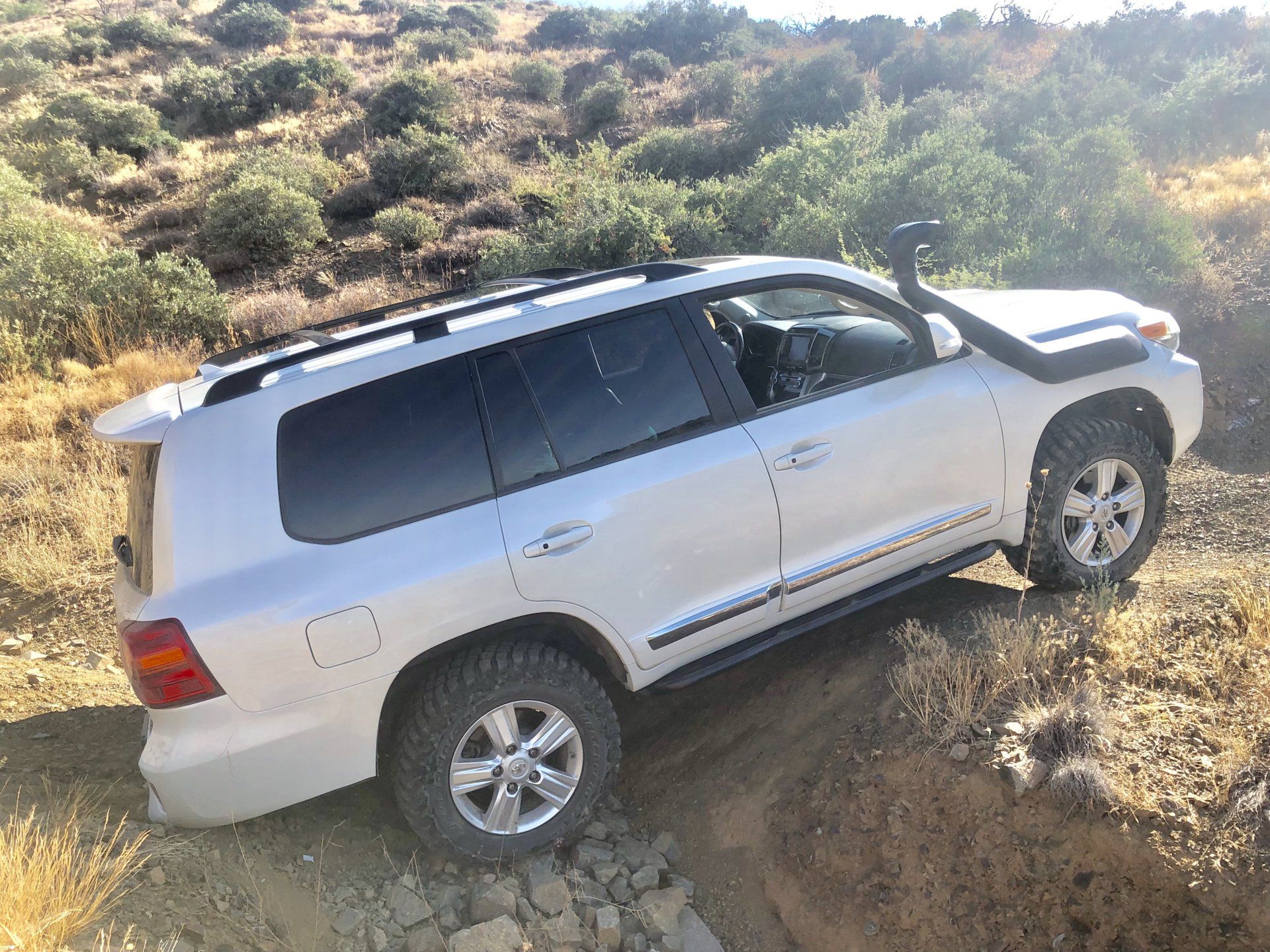

I did catch the other day on a dirt hill and it bent it out but immediately went back without even a mark. It might be an issue on jagged rocks but I think smooth rocks and dirt it’ll be fine.
This hill is a 2 foot drop with an immediate 4 foot upslope.

Well done indeed looks great. Having no plans for a rear metal swing out bumper myself this is an idea I can get behind. I am interested in what you and your welder come up with as a bumper slider solution. I can definitely see how that would help in situations where the tupperware could get caught on something.
