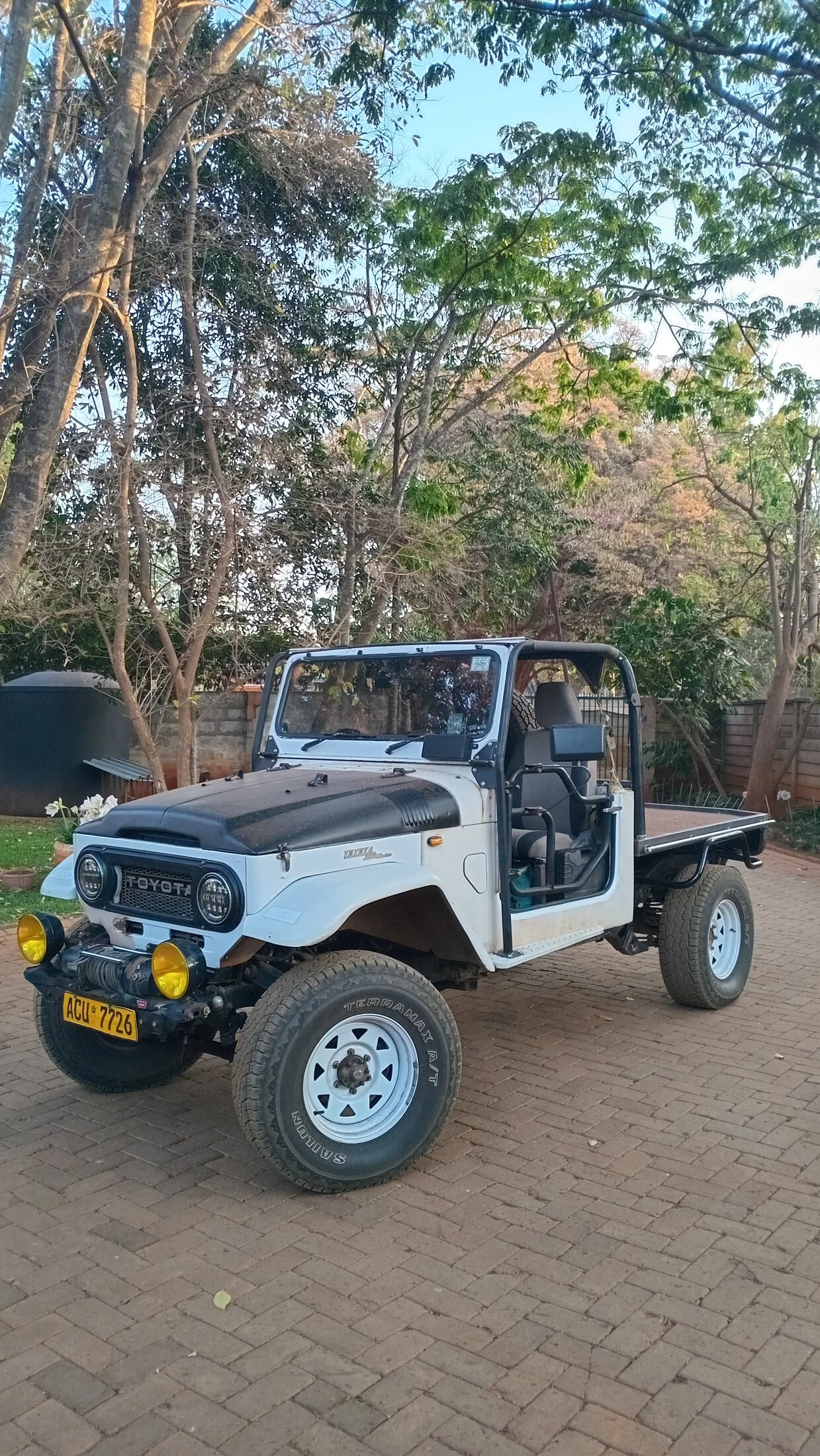

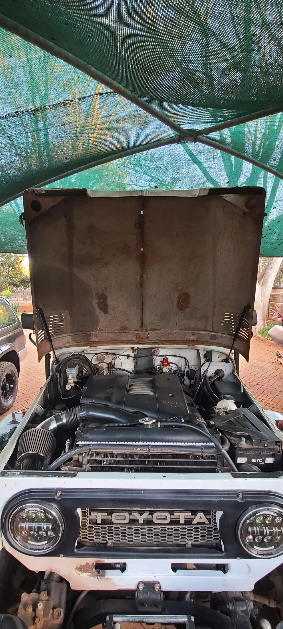

1UZ vvti and 5 speed auto a650 in mine and stand alone ECU. Stock numbers on the engine are 296hp but I should be well over 300 with my intake, exhaust and I'm running a fairly aggressive tune on it.
It's an absolute blast to drive! Most fun than you can have with your clothes on :grinpimp:
She will run a true standing start to 60 in 8.1 sec if I lean on her hard.
My part of the world we don't have access to the LS platform like you guys do, so for me the UZ was the best option. No regrets at all.
