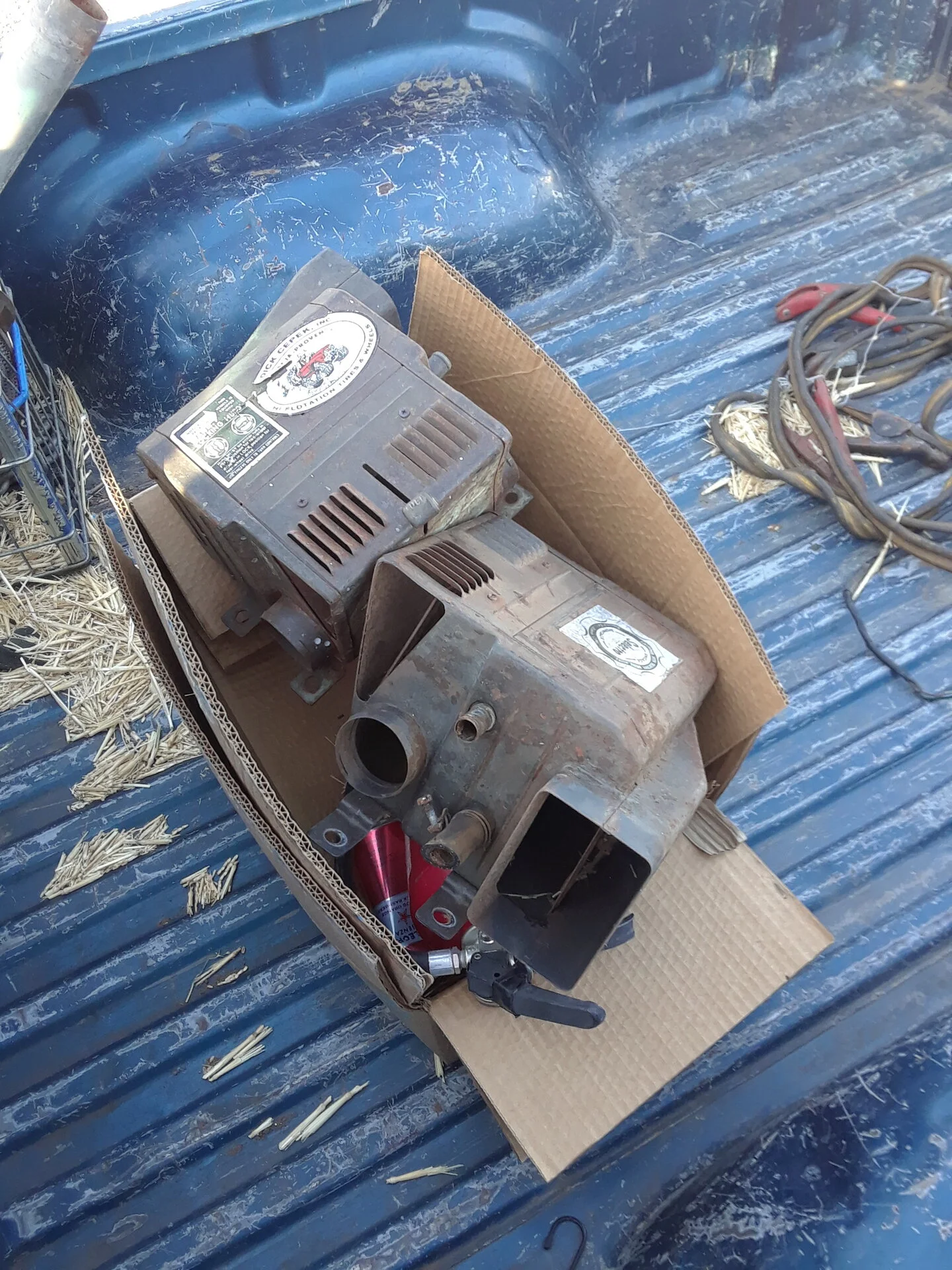

Recently I took some parts off of my parts pig to sandblast at work.
Both front and rear heaters and the seat rails.
Last night I was parked at my girlfriend's house, while there, a other fj55 front heater unit found it's way into my bed.
weirder than weird.
Anyone recognize the heater with a warn sticker and a Dick Cepek tires sticker?
it just sort of landed in the bed of my pickup overnight...
There it is.
Pictures or it didn't happen, right?
It happened.
Any and all clues are much appreciated.
weirder than weird.
There it is.
It happened.
Could it be a 40 heater box?
