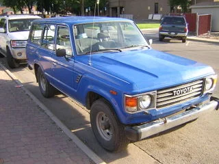

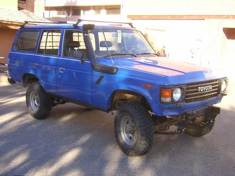

Here is my finally complete Ironman set-up. 2" Ironman springs, MAF stainless extended brake lines, MAF 4" extended sway bar links, MAF shackle reversal, Ironman steering stabilizer, Heckethorn 4" lift shocks ( Have four semi used iroman shocks if anyone needs them ) and 2 1/2" SOR cheap ass rear shackles. Yeah, I know I need bigger tires, the fiance says I have to wear these out first. Grrrrrrrrrr.
I have the BDS with a a S.R. and a friend has the Ironman...can't tell the difference in the ride.
What I am writing to say is that this is an EXCELLENT post. All the comments about the ride are subjective...like Jim said you give a little and you get a little. Nonetheless the pictures provided are a GREAT resource for the community. I really liked the two white cruiser pics...one with and one without the lift.
The only negative comment I can make is that you guys need to BIGGER TIRES...hoorah!
I know, I know. I want 34's so bad but we are renting now and looking to buy because we are recently engaged. Have to save .....Grrrrrrrrrrrrr.
