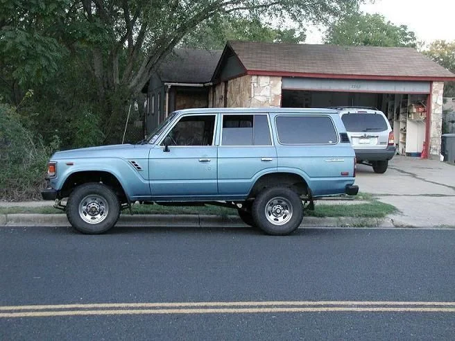

Nice!!! It really look's great with the lift, seems like your cruiser have a new life.
How did you feel the ride?
thanks!!! well the stock springs wern't bad so it rides the same, but a little more bouncy!

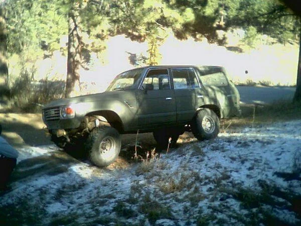

Got mine all done, but didn't have pics at the time, I took this with my cameraphone so it's kind of crappy, I'll post better pics when I get my real camera located. It was blue/primer but I decided to paint it since it was faded down to primer most of the way anyway. If you don't like lifted POS 60's than don't look at this picture, especially if you don't like "custom Krylon" paintjobs either. I personally think this particular truck deserved an olive drab paintjob though due to the fact that it's not nice enough to get a real paint job on (especially considering I'm gonna dent the crap out of it anyway).
