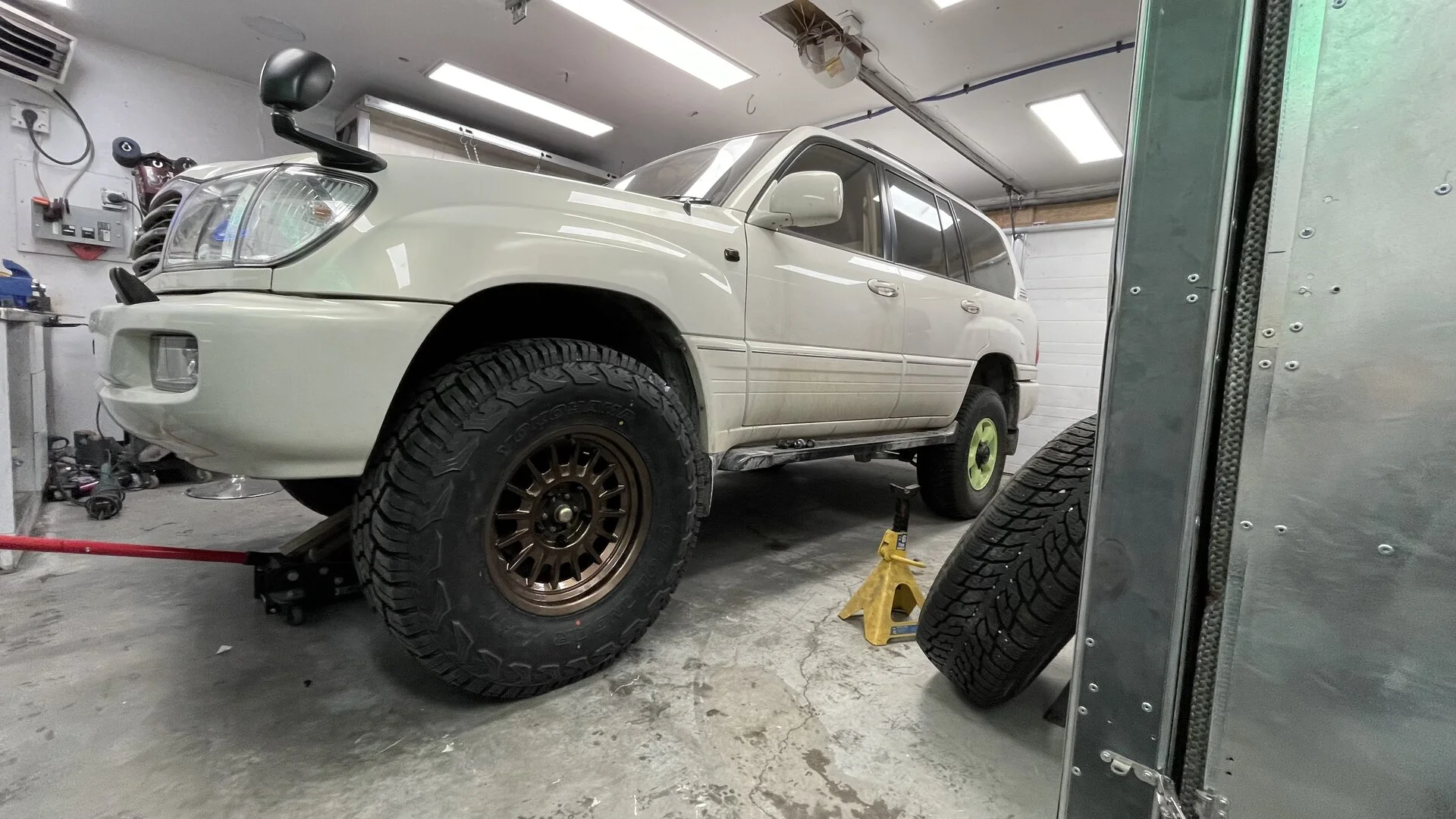

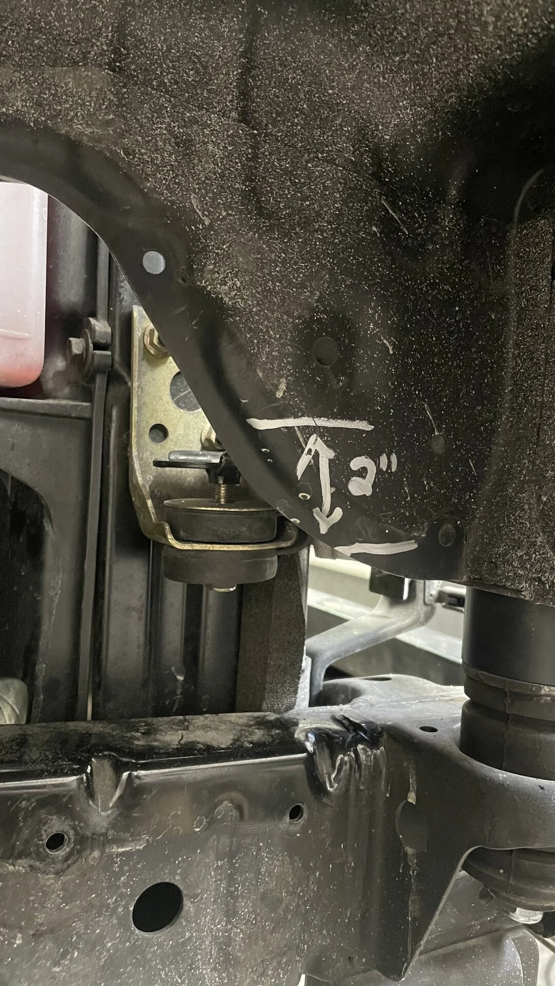

So I had a specific wheel I wanted, but it's offset puts it inline with the fender lip. And, I wanted 35" tires. So, body lift, as the AHC was staying no matter what.
Tried to source 4" from Japan, but shops got real weird about selling parts...like they want to keep their lift on the island only, oh well.

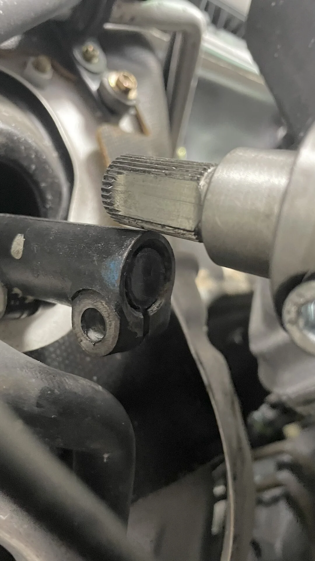

So, got a spacer + bolts + steering extension from New Zealand.

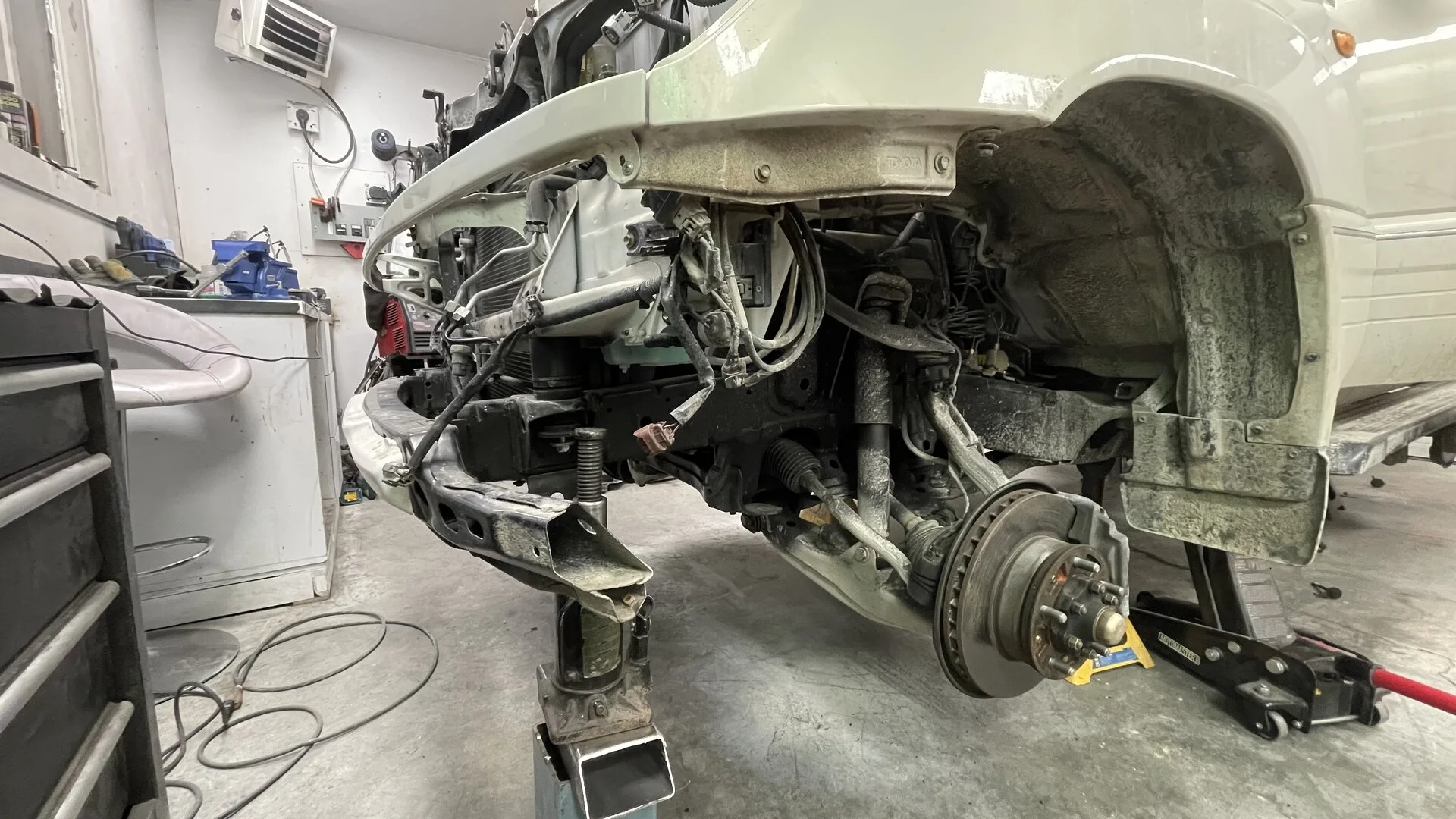

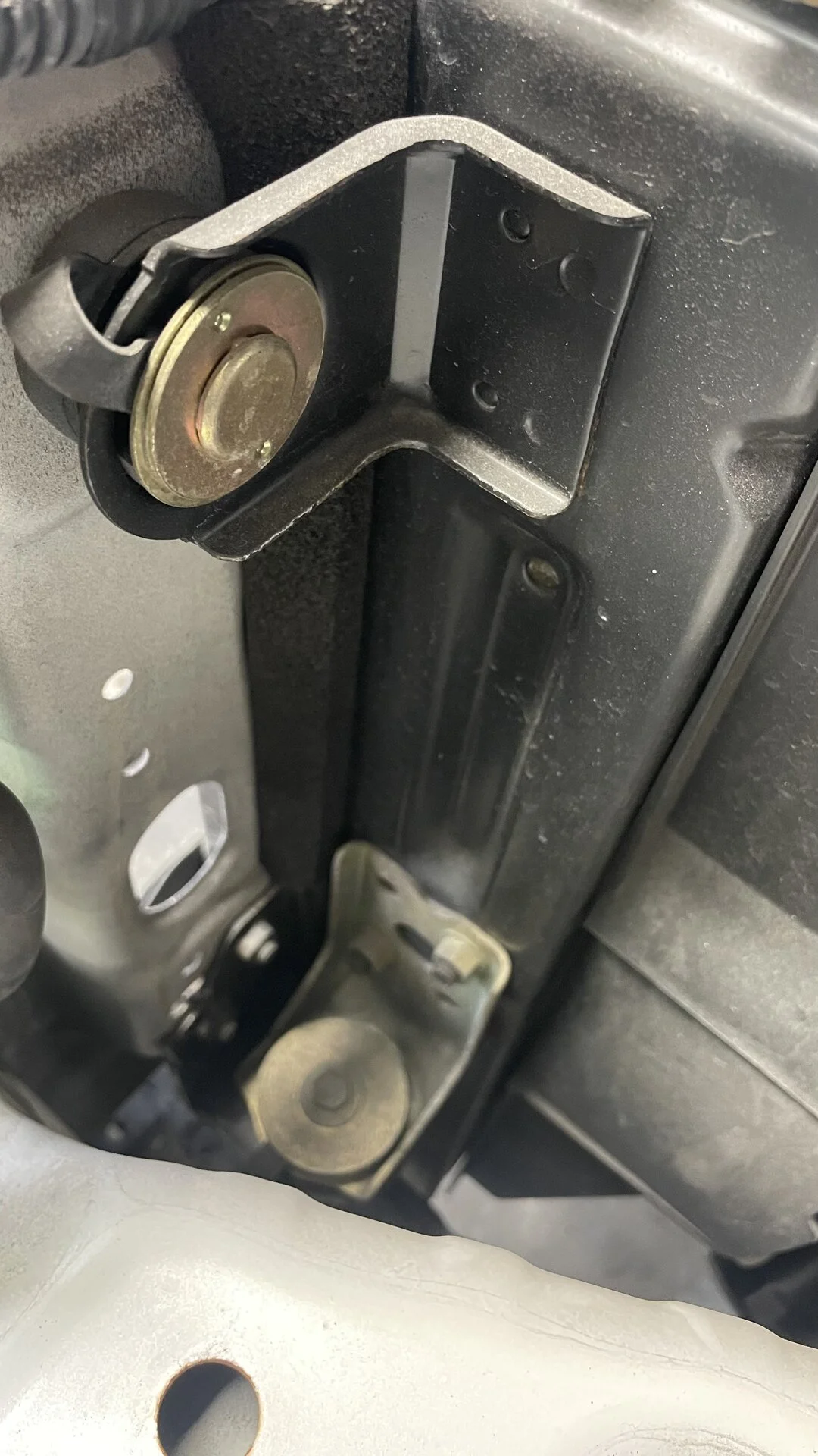

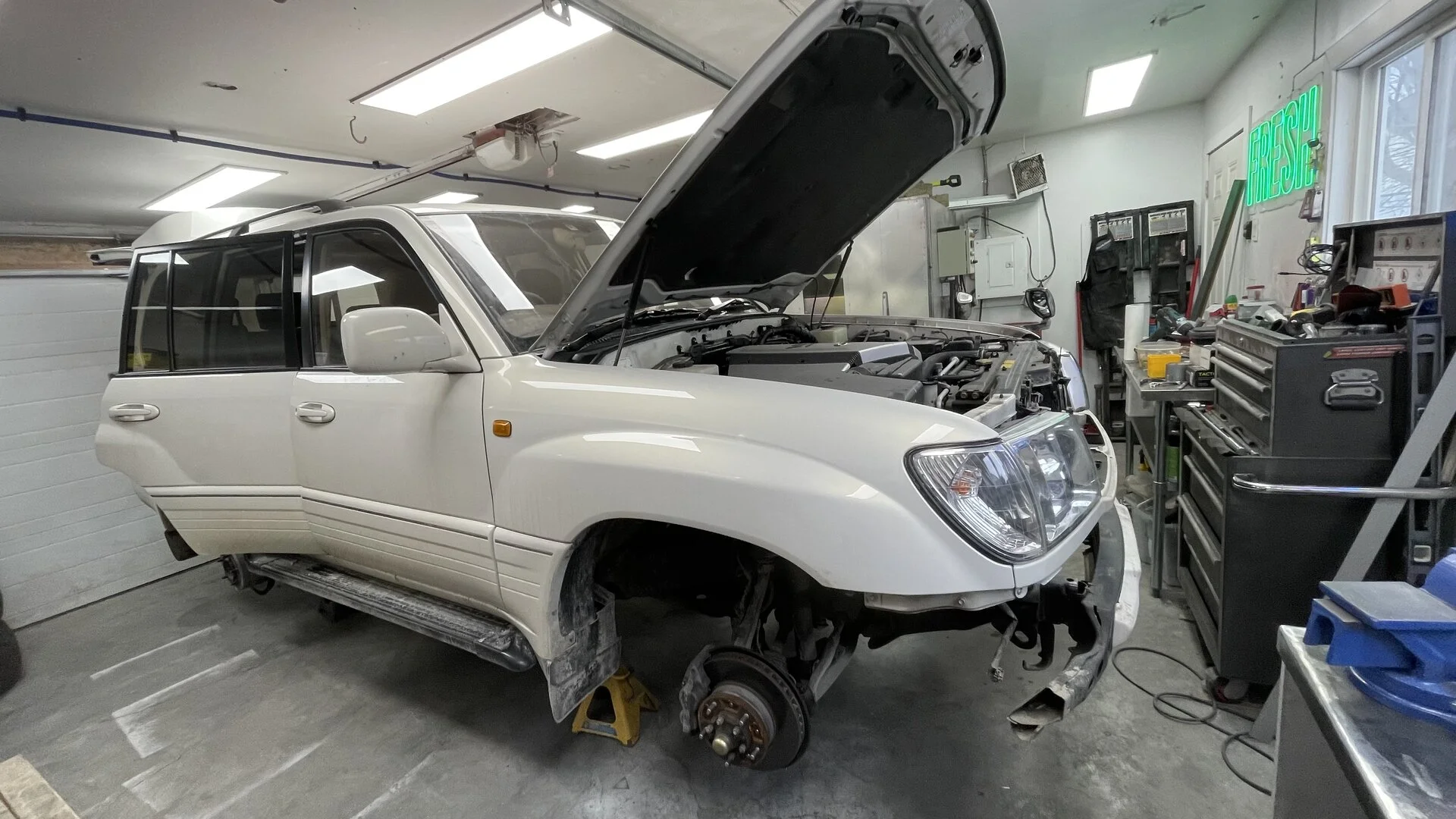

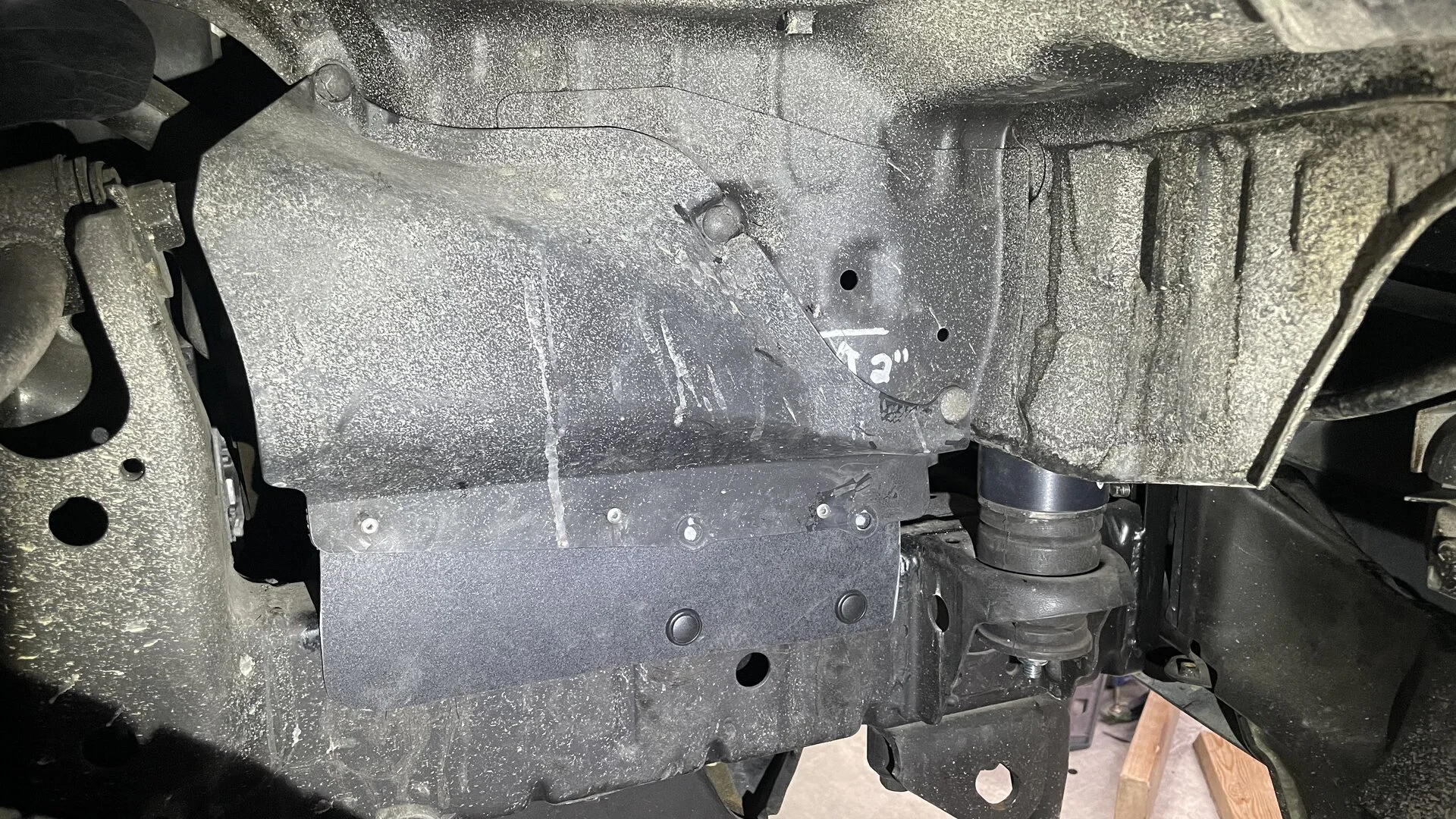

Putting in the pucks was pretty easy. Just pull up the carpet in a few spots, pull interior panels, remove seats, front grill, headlights, fender liners, bumper covers, mudflaps.

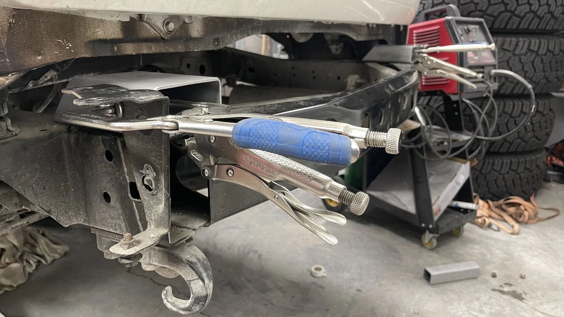

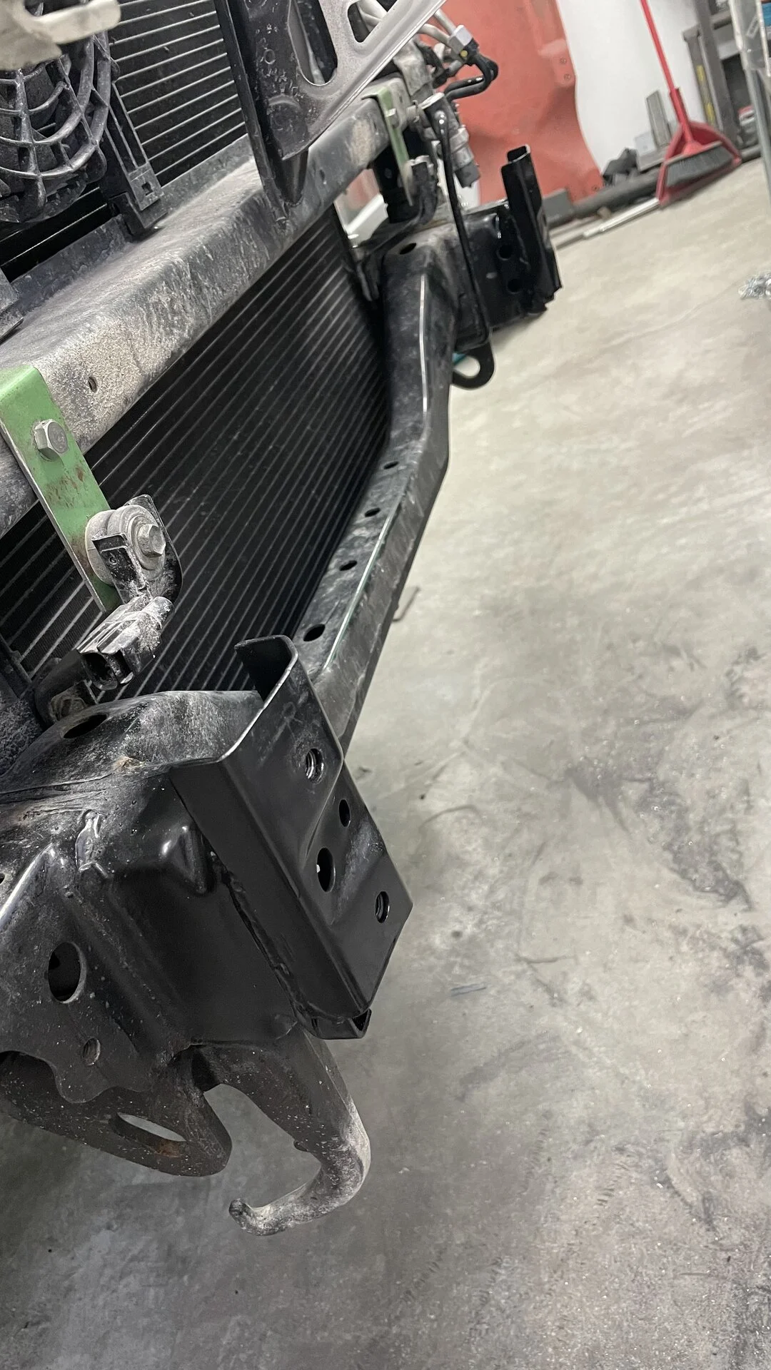

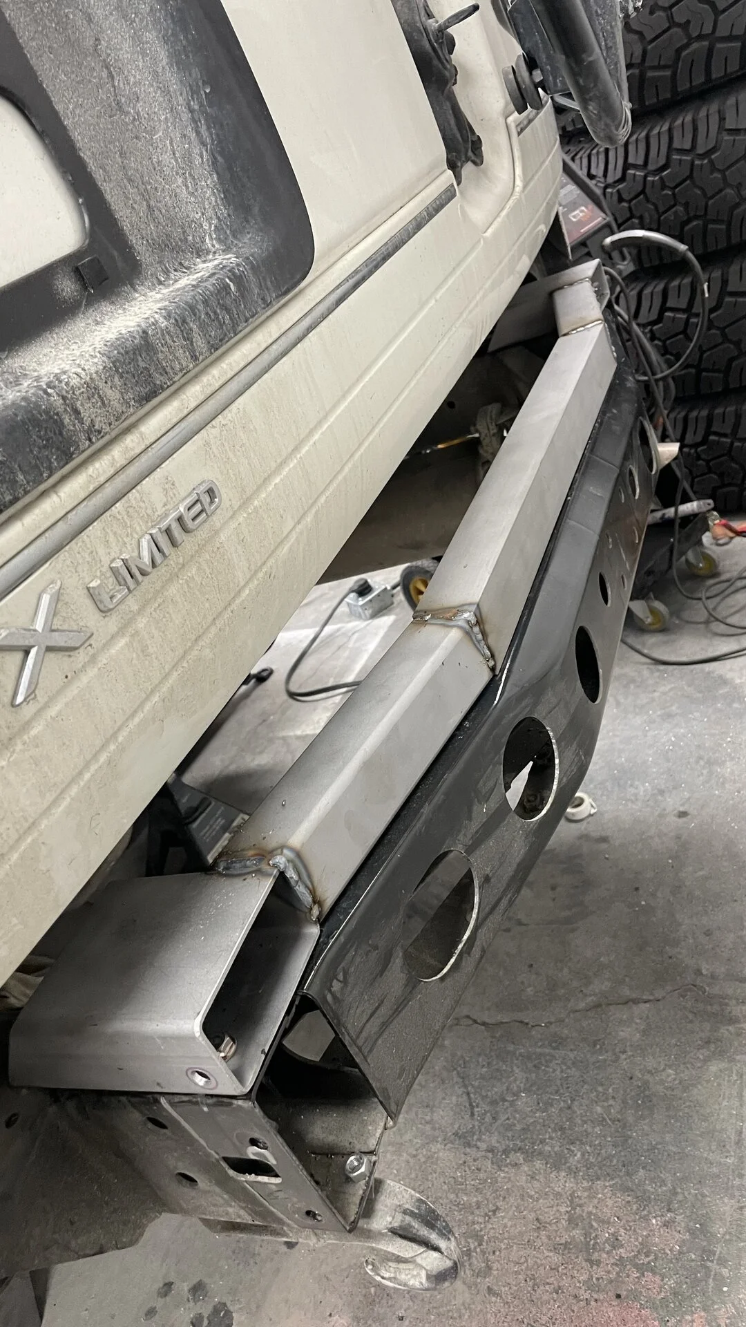

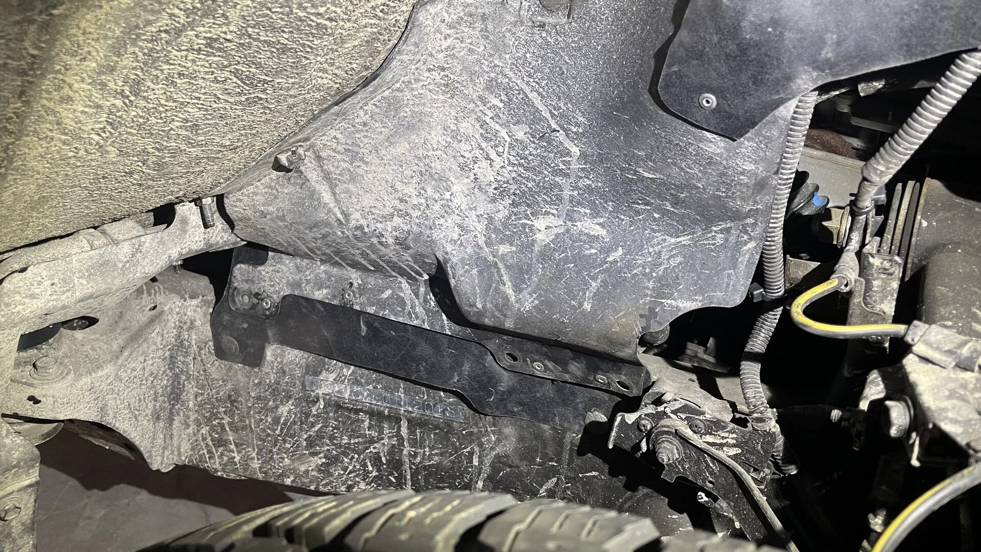

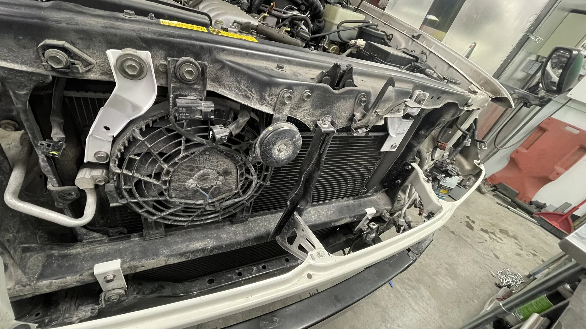

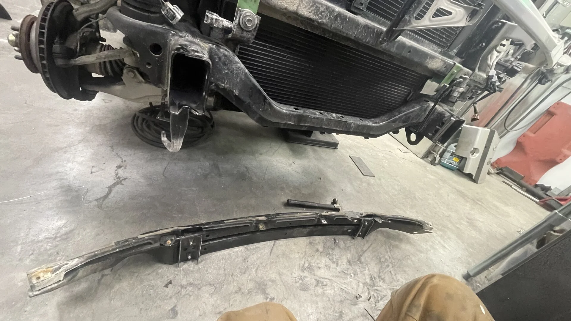

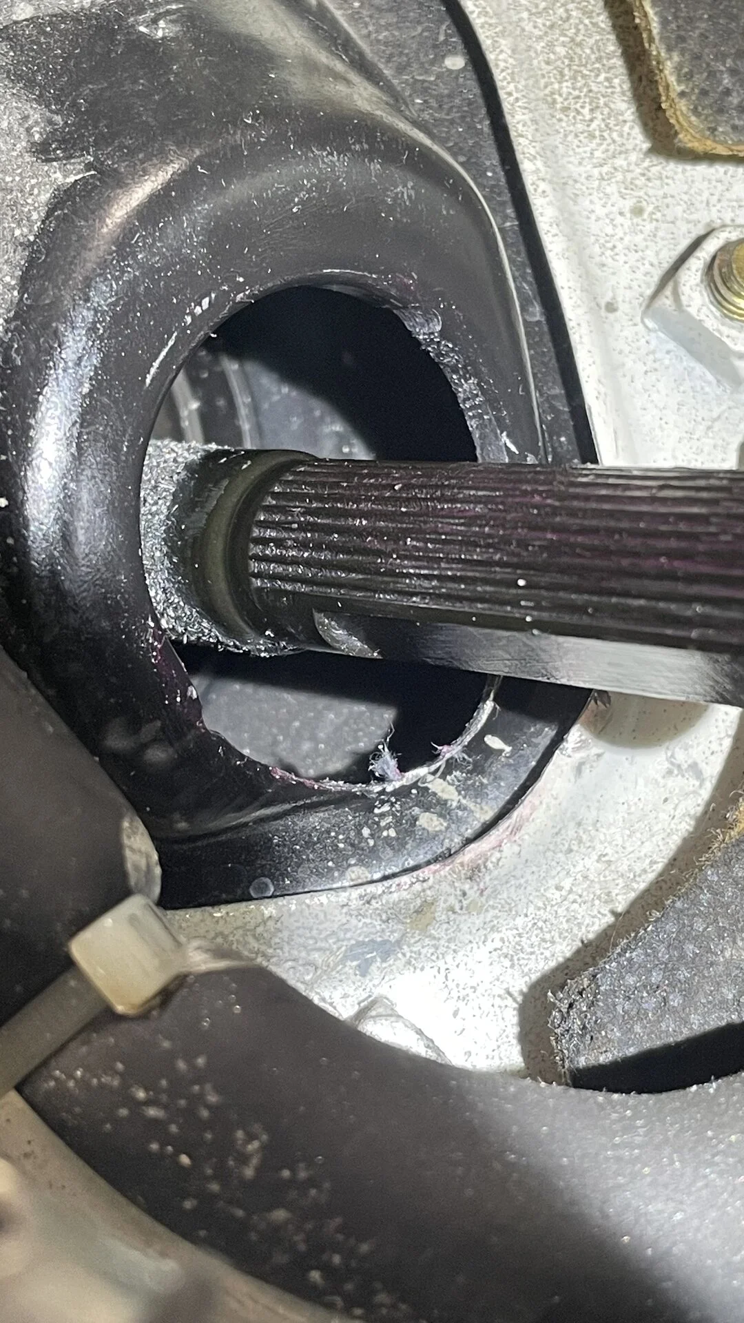

Things get interesting after the pucks are in though. Now you need to make custom brackets for the a/c condensor, drop the radiator, fit the steering shaft extension, adjust the shifter linkage so you can get your keys out, and lift the front and rear bumper (cut em off, and weld em back on)

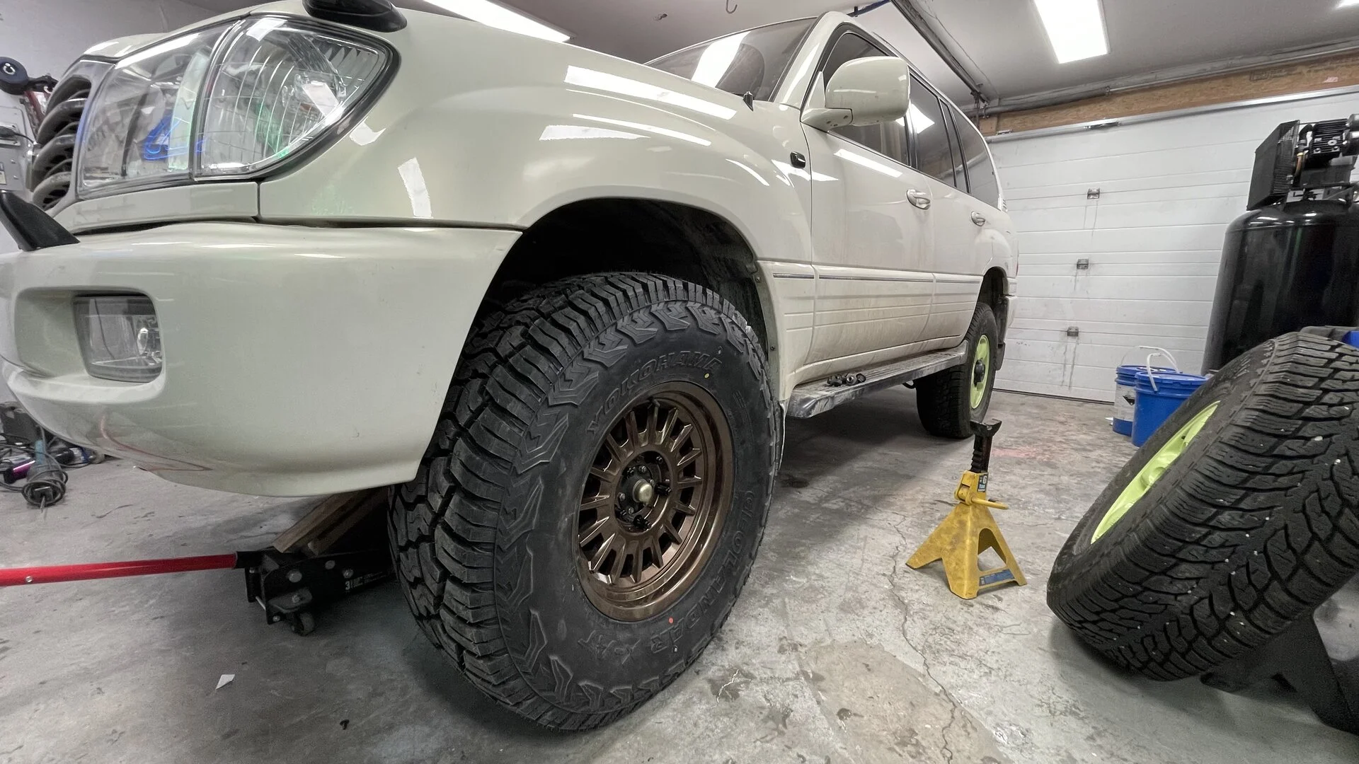

Now once it's all done (hopefully tmrw) I can fit my wide offset's with 35", and AHC comfort!

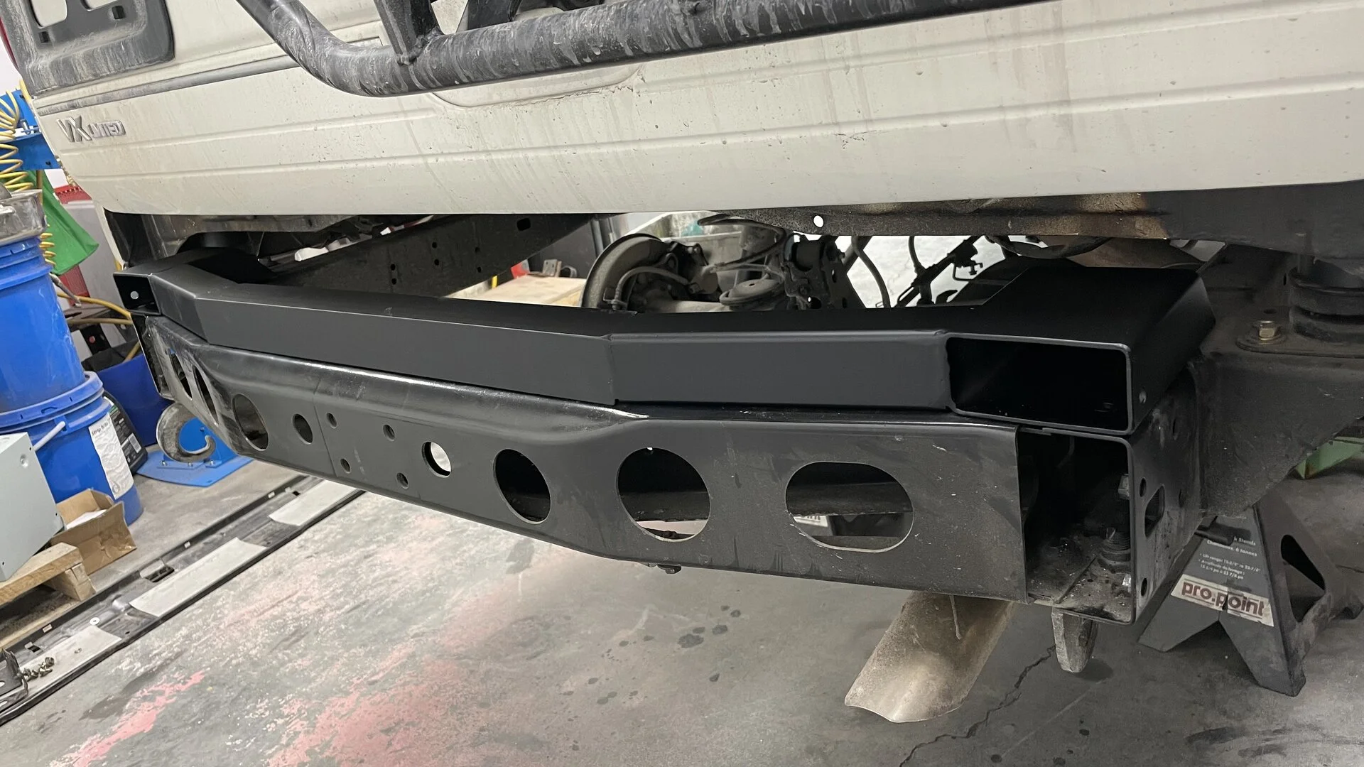

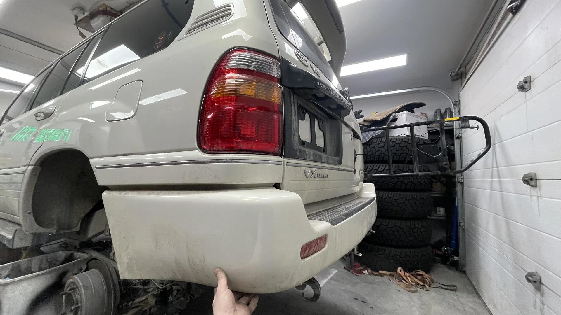

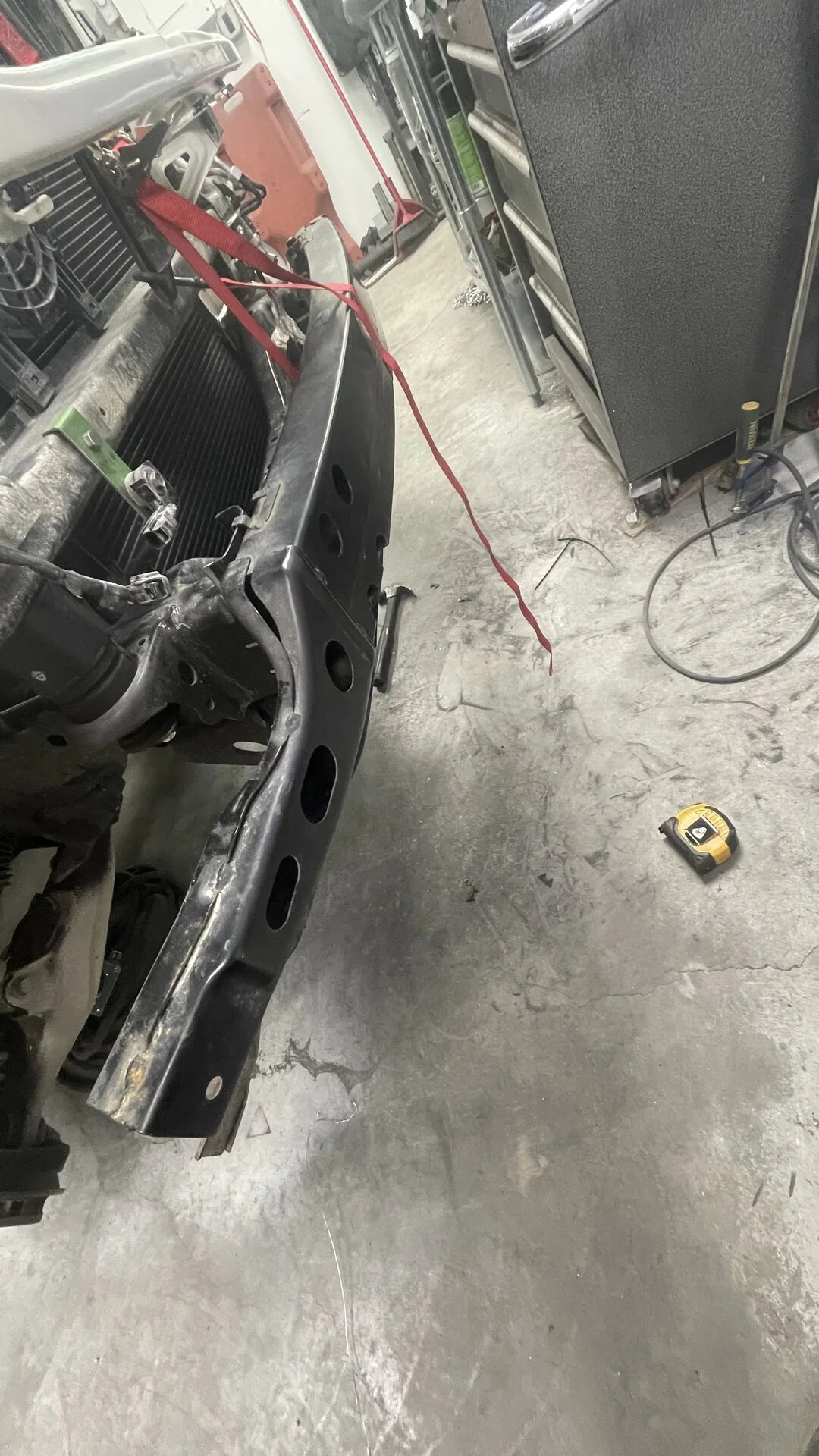

Today was the rear bumper, and finish up brackets.
I hadn’t even looked at the rear yet, but it was pretty easy. Wound up fabbing up a 2” spacer, and provided a higher point to fasten the bumper. May have to do some creative trimming with the cover along the bottom.

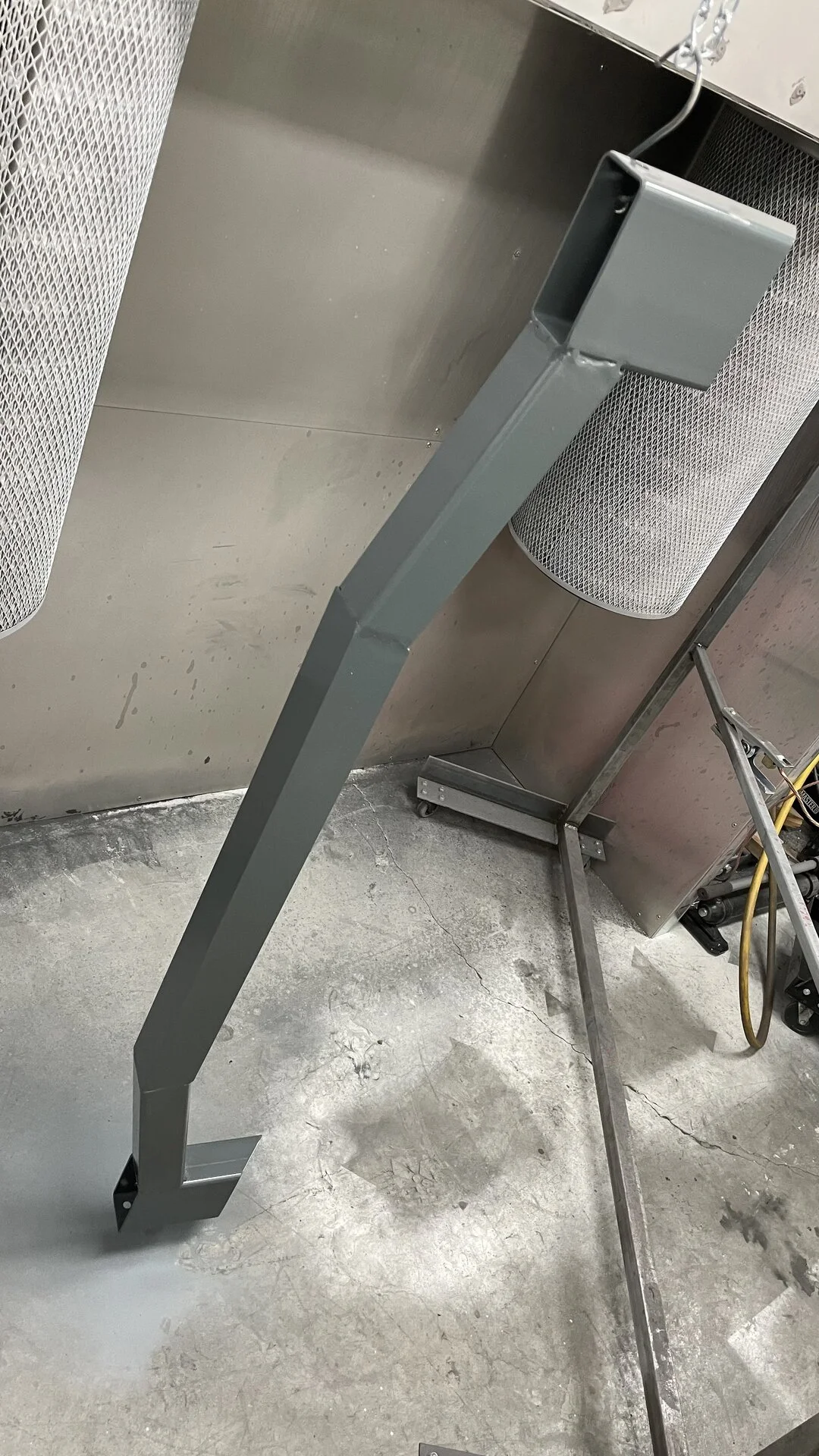

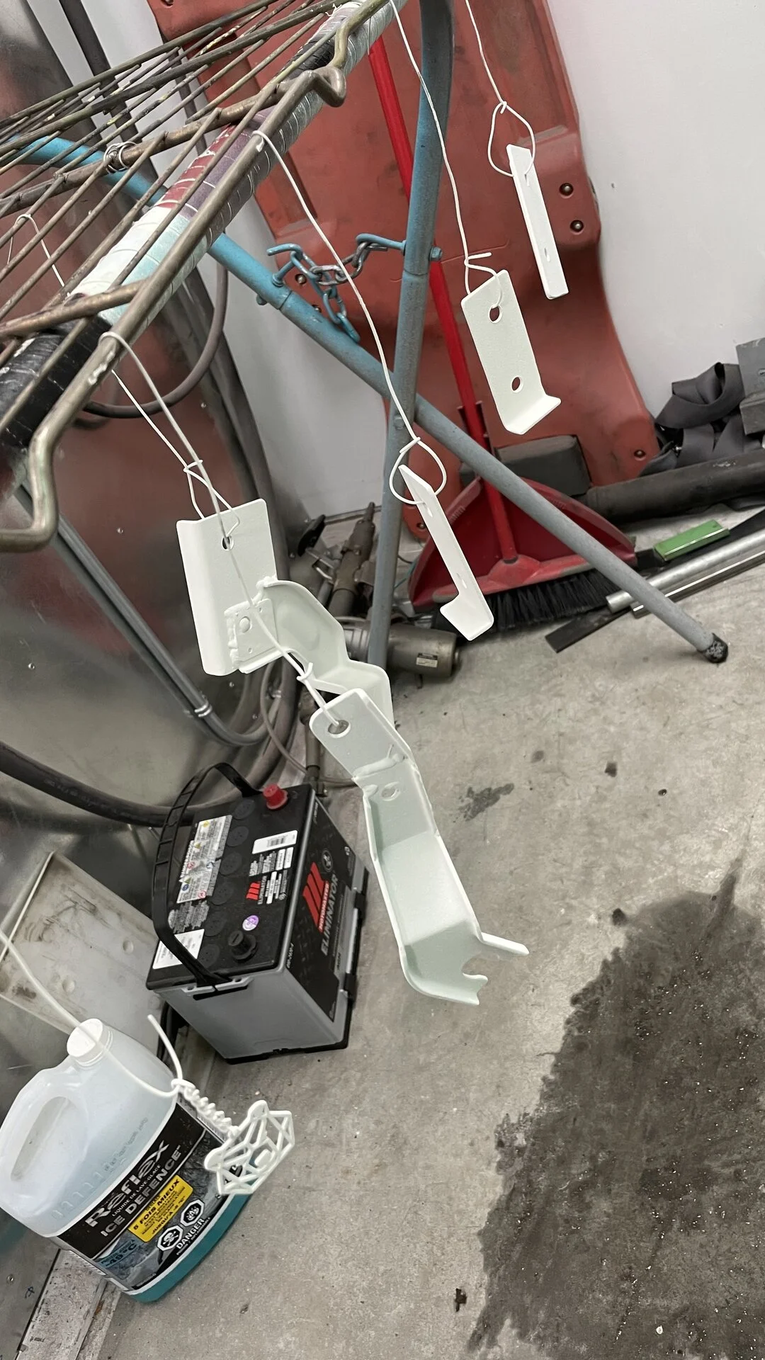

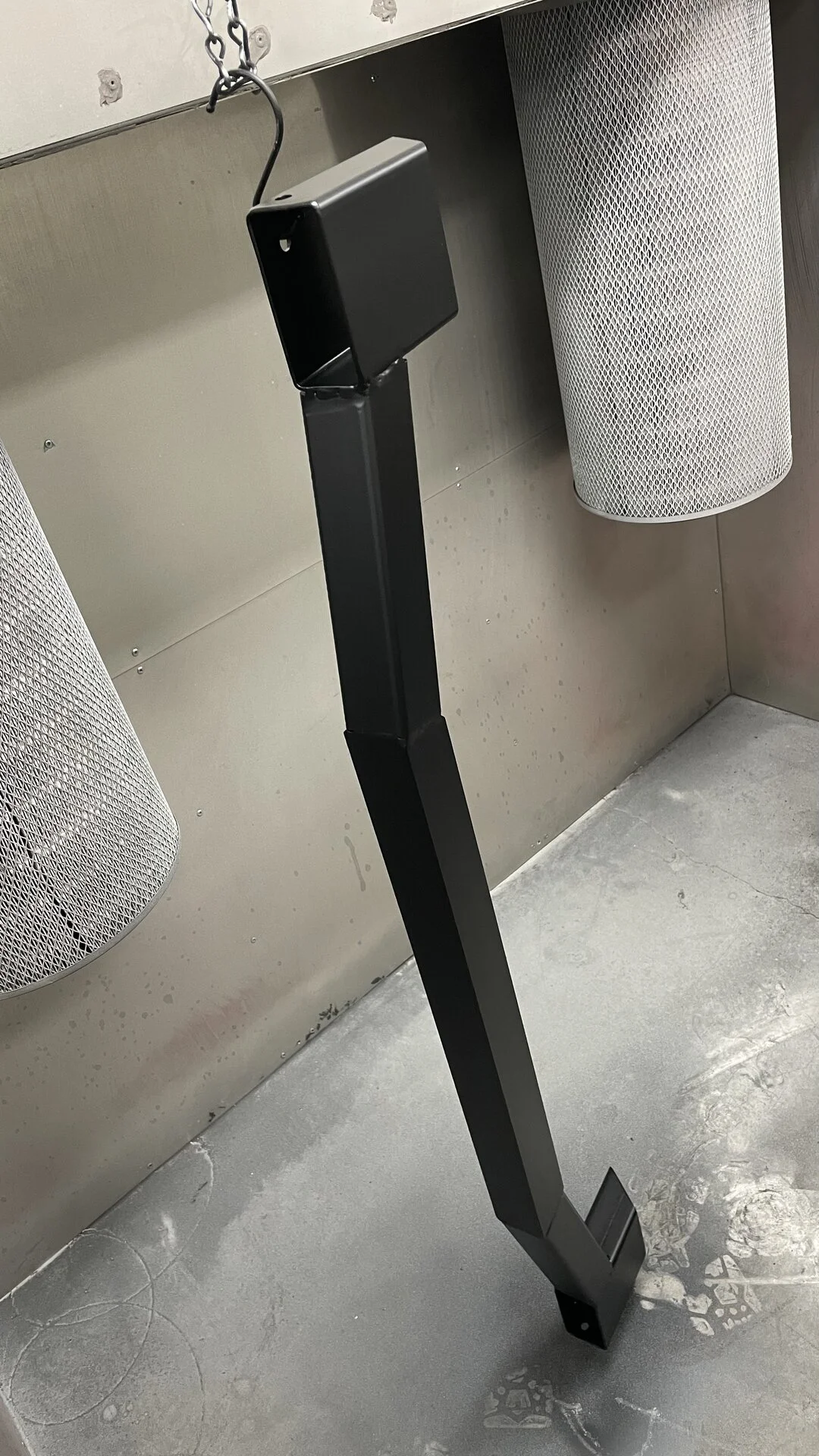

Used my facilities to powder the brackets. Base of zinc, then some satin black, and pearly white for the front pieces.
So just the shifter adjust, and some longer lower rad mount bolts with nylocks, as they are underslung now.

Everything is all bolted back up. All interior back in place. Shift link adjusted, zero issue. And ordered up a transfer lever extension, to return that to OEM height in cab (still function just fine, but sits low).
I would do this again, and even go taller.
