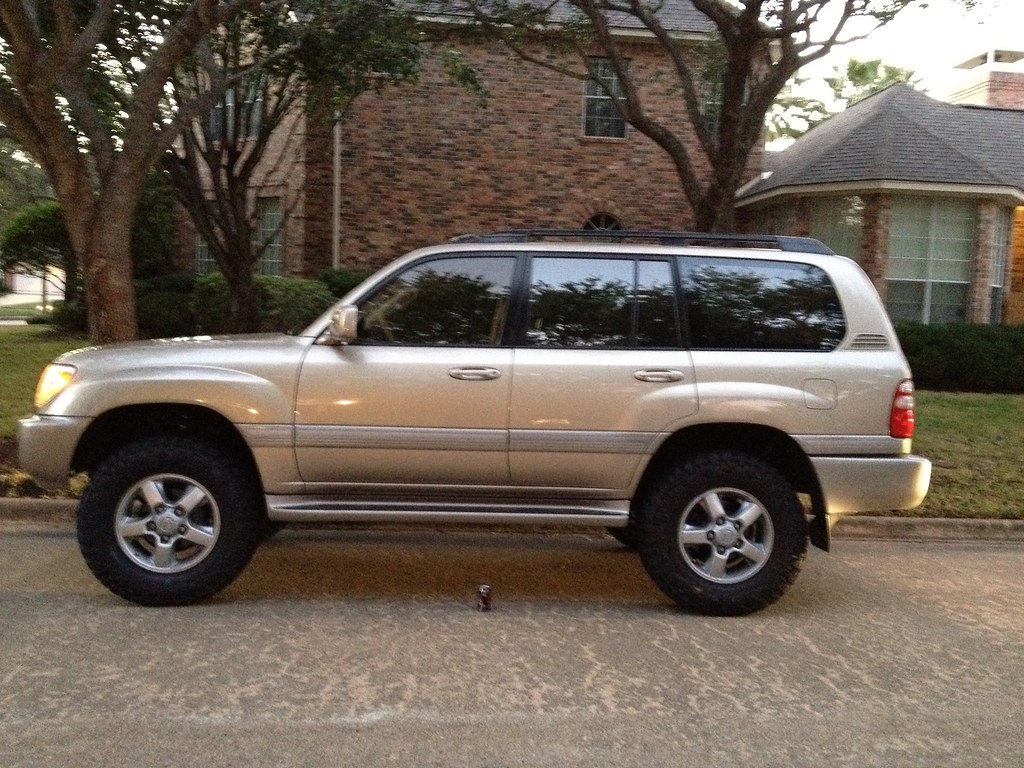

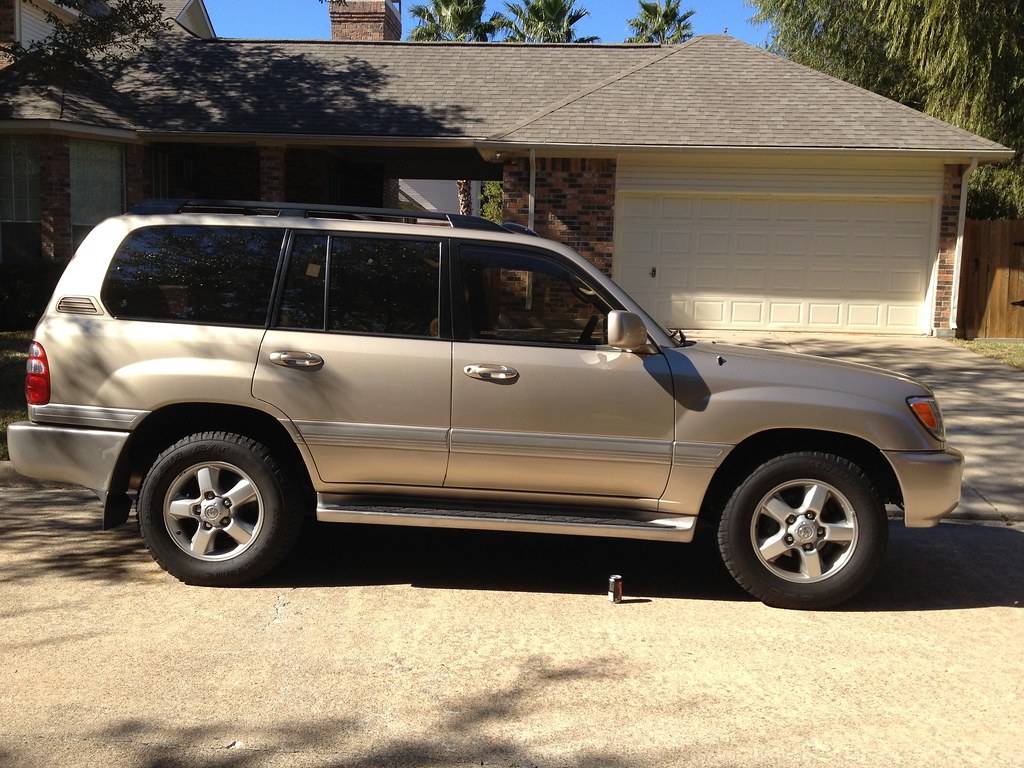

Here is a before image (notice coke can for size comparison)
Here is the after image:
My problems:
1) The front tires are rubbing when I am at full lock, it sounds like they are rubbing on metal rather than plastic. The guy who installed them at Discount Tire said they were rubbing on the UCA. I'm recovering from knee surgery to both knees so I couldnt crawl under there to verify.
I thought I had read in other threads that these tires fit with no rubbing. For those that have this combo was there anything you had to do in order to eliminate the rubbing at full lock?
2) The spare tire (34.6 inch tall) doesn't fit back under the car. This is really only a temporary problem since I am one of the BIOR rear bumper group buyers and should be getting the rear bumper with tire swingout in the next month or so. But, I'm wondering if there is an easy fix in the mean time. If not, I'll just leave it strapped down in the back (where it is now).
3) The ride seems very rough to me. I feel every bump and crack in the road. After driving it for about an hour yesterday my neck was sore. This is coming from someone who drives a Subaru WRX STI as a daily driver so I am used to firm rides. But this current ride is brutal.
I assume the ride will become more foregiving when I add weight by installing the front bumper, rear bumper with swings, rock sliders, skid plates, and winch, but is there a cure in the mean time?
I think the shop that installed the lift kit may have over tightened the torsen bars. You can see from the photo above that the front is bulldog (a little higher than the rear). That's with nothing in the back other than the spare. Also, it feels like there is almost zero droop left on the front.
Would easing up on the torsen bars help smooth out the ride, and would it hurt or help the full-lock rubbing issue on the tires?
Any thoughts are appreciated.
