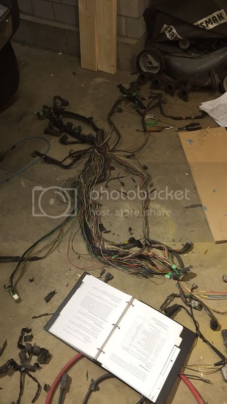

I ended up pulling the entire harness off the engine
This involved having to pull the 2 piece intake manifold off. I plan to rebuild the factory starter before I put everything back together since it is located in the valley of the engine under the intake (Great spot toyota...)

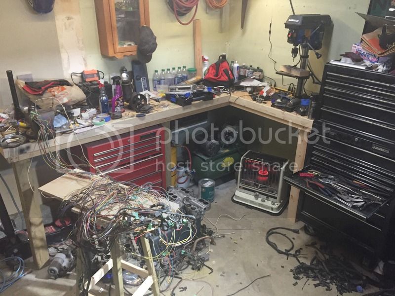

My tiny work space in front of the truck... does the trick

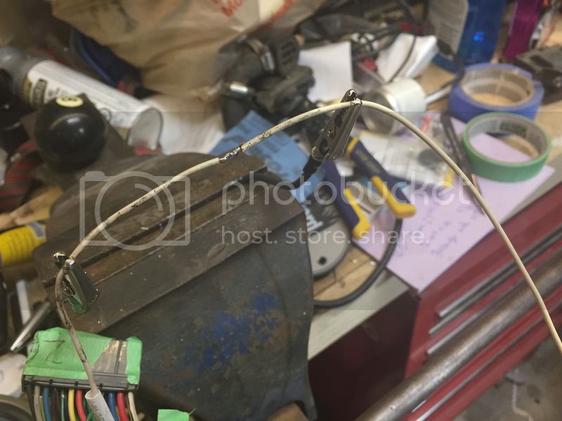

Some sick soldering (jk) I worked backwards on the stock ls400 body plugs and deleted most wires. There was some important power wires and grounds in there but most of it was garbage. After deleting a bunch of these there was a few joints in the engine harness that needed patching.

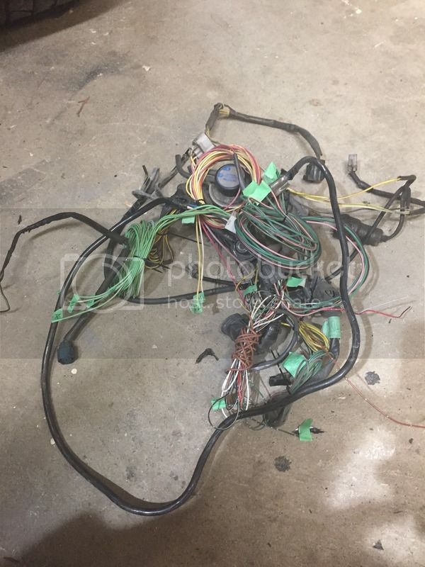

Some of the wires removed from the 1uz harness. This includes EGR, Traction control stuff and some ls400 interior bits
