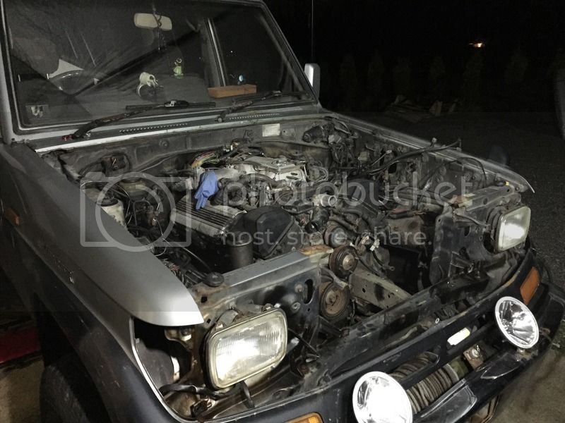

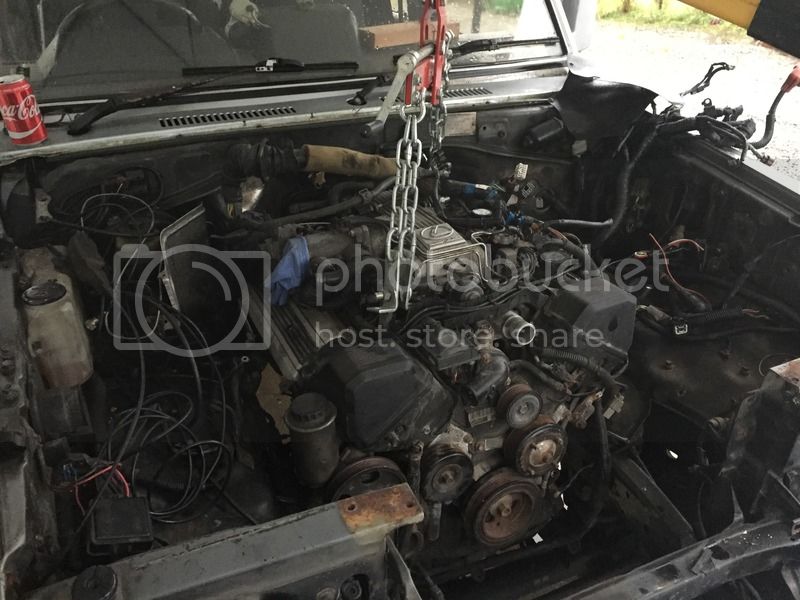

Good news! I love how at home the 1UZ looks in the Prado engine bay. Toyota should have put those motors in from the get-go.
Totally! The only thing that would make it perfect would be if the ps pump was on the opposite side. It’s pretty tight with the alternator and ps pump right beside the steering box.
Also if one wanted to leave the tcase in the original spot and not slide it forward like I did you wound have to massage the firewall quite a bit. Even with the one inch forward the rear section of the drivers side of the engine is like maybe an 1/8” away from hitting. Luckily these are very balanced engines. I don’t expect too much torquing causing it hit.
Interesting... I wonder if the transfer case sits in a slightly different place in the LWB vs SWB, or the auto gearbox length is a bit different as on mine (LJ71 with R150 box) we just had to give the firewall a little tap behind one of the cam covers to get plenty of clearance. PS pump vs steering box is close but even torquing the buggery out of it with big tyres & low t-case gears nothing has touched on mine.
