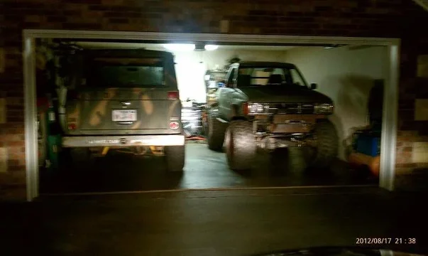

Glad you got it .painted! It would look good sitting next to its big brother! We'll have to take some shots of them at Roundup!
White Trash of the Elwood Chapter, TORC4x4.org, Cottonland Cruisers.
Here's a shot .of its brothers. Camo and OD green are in its bloodline!
