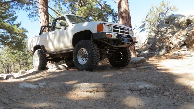

my 85 on 33's
Nice. What lift do you have? Looks like you put high steer on it too. Mine was tricky to do high steer with only 2.5" of lift. I have OME lift. Thinking about going with something else up front to get 3" of lift.
Thanks, and yeah your right I would like to do a SAS but I have a 40 for that haha, no I'm just going with the ifs because I've never done anything with it at all and we'll I figure it deserves a shot to see how it goes I've always wanted to feel the difference off road to see what I like more. But maybe later on ill do a SAS but for now I'm just taking my time learning about what I got while I have it and seeing what I can do with it I'm not expecting to do any crazy trails right now. Love your truck though looks great and awesome view out there.
oh you"ve got a 40 too. i'm just sayin don't go too extreme on the ifs. i don"t believe in ball joint spacers. definately smooth and nice to have both trucks for both kinds of fun. that pic is on the jon bull trail in big bear
racehoss, i have all pro 4"( i think it's been a while maybe 3") springs up front with stock shackles and tacoma 3" leafs in the back with custom hanger locations and yes marlin high steer.tires are 33x10.5x15
