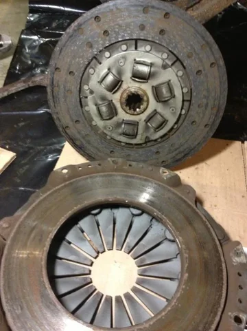

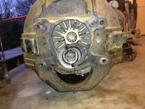

Began to tear down the engine. Clutch and bell housing first.
Clutch showing proper orientation of the disk

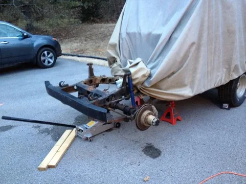

Since it got to a balmy 35 today, I got started taking off her front shoes. Had the air tool out and went to town on those. Pretty disappointed with the air flow from my California Air compressor, but is didn't expect it to run an air ratchet very well.

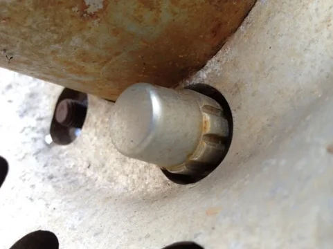

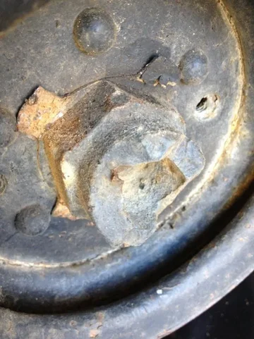

Things went pretty well until I hit the last lug nut on the first wheel. Locking nut! Curse, crud, phooey, snap!
I hate locking lug nuts

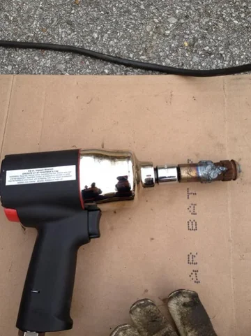

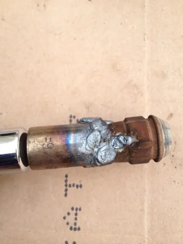

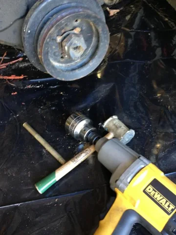

Turned to MUD, and had 2 ideas to try in a few minutes of research. Tried pounding on a socket, to no avail. Then got the big guns out and welded a socket on. Had to try a couple of times as the nut didn't want to accept the weld (this was the little welder, so it struggles with heavy thicknesses). Ground down the nut a little to expose some clean metal, reduced the diameter of the socket so it matched the nut and mated the two.
Socket welded to nut

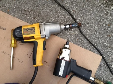

First one came off with the air ratchet, but the other side was not budging. I had to get the big Dewalt Hammer Drill out, which did break it loose finally.
Dewalt Hammer Drill and Sears Air ratchet

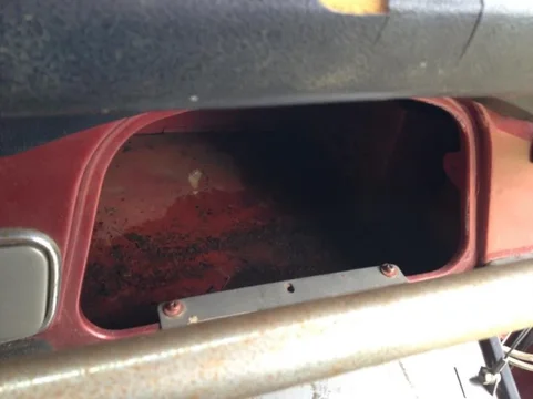

Did you look in the glovebox for the wheel lock socket? I have missed your posts. Glad to see you back at it.
It's extremely more satisfying building your own Special Service Tools-
The cupboard was bare!
No lug nut key. Just mouse poop. Wet.
Heck, it only had a total of 18 lug nuts on the entire vehicle. Rears had no locking nuts thankfully.

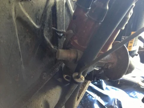

Removed fuel pump, distro, oil filter, side panel. Amazing that distro only has one bolt.
Only one hole on engine block for distro?

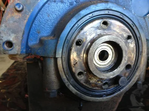

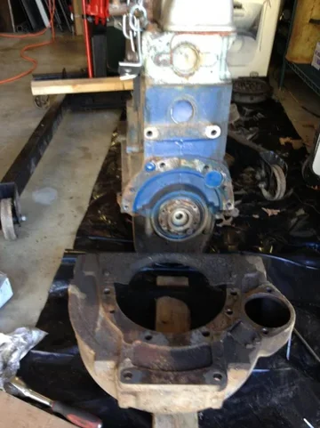

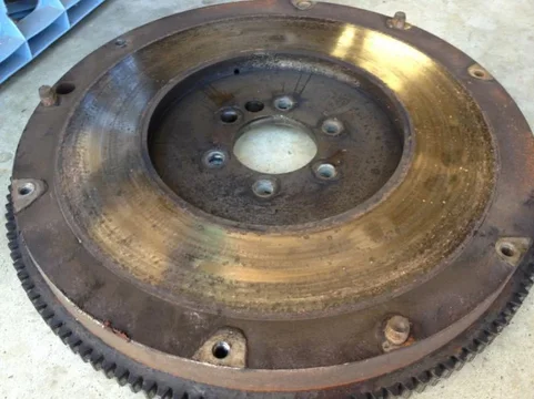

Removed flywheel and bell housing
Flywheel looks clean

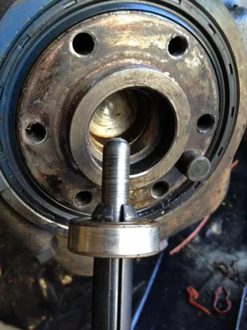

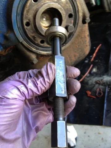

Bell housing and pilot bearing

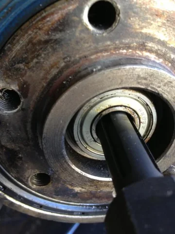

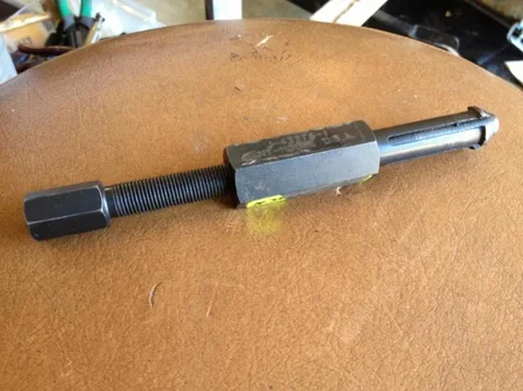

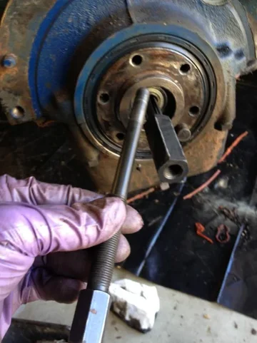

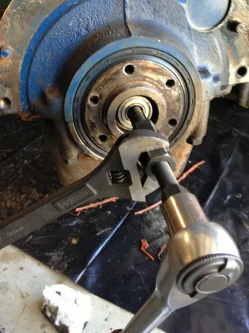

Speaking of pilot bearing - my eBay find a few months back paid off. The used tool I bought was actually a SST pilot bearing puller. Hot Dam(n)!
$36 find on ebay
Great thing - I've never done this before, never even seen the pilot bearing before today. But it just *looked* like the tool when I stumbled across it. I'm very pleased that something was actually easier than it was supposed to be (crankshaft nut too).

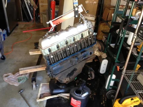

Thought I drained the oil - but had not. Oops. Almost a disaster. Got it drained. Engine tilt bar came in handy.
Tilting at windmills

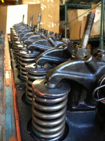

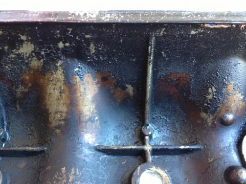

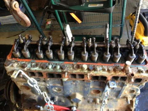

Removed valve cover
Looks clean
Shoulda tried the bread trick for the pilot bearing - even cheaper than $36!

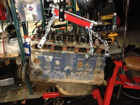

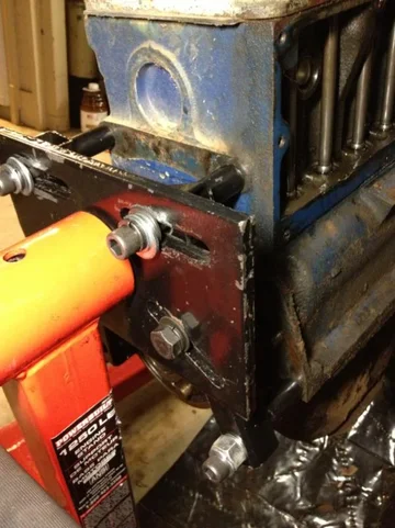

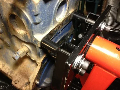

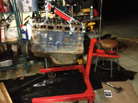

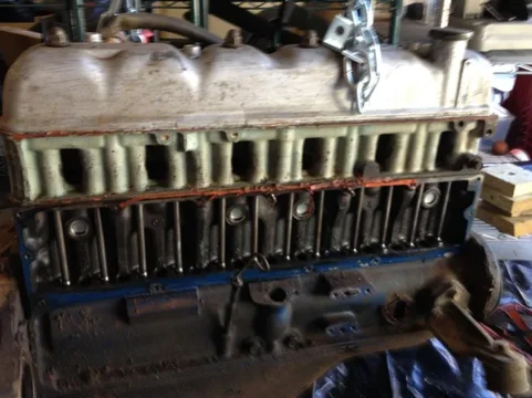

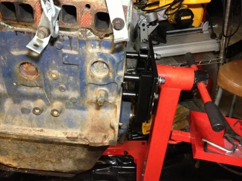

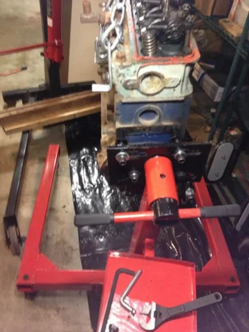

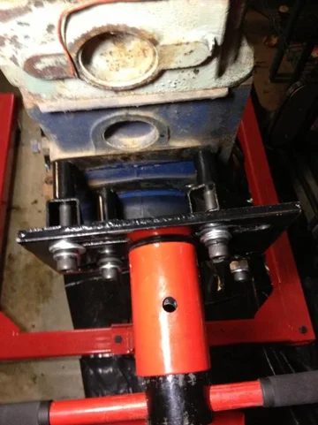

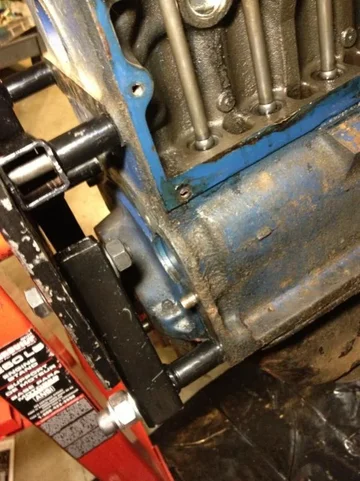

Messed with the frickin' engine stand for about an hour. Clearly it wasn't designed for a straight six.
Does this look like it is supposed to?
The lower right was the one I'm concerned with.
