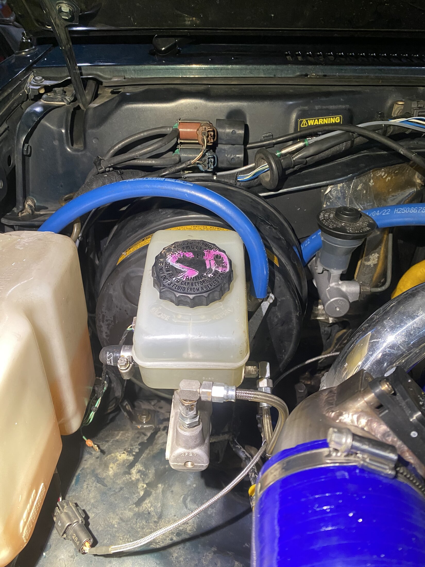

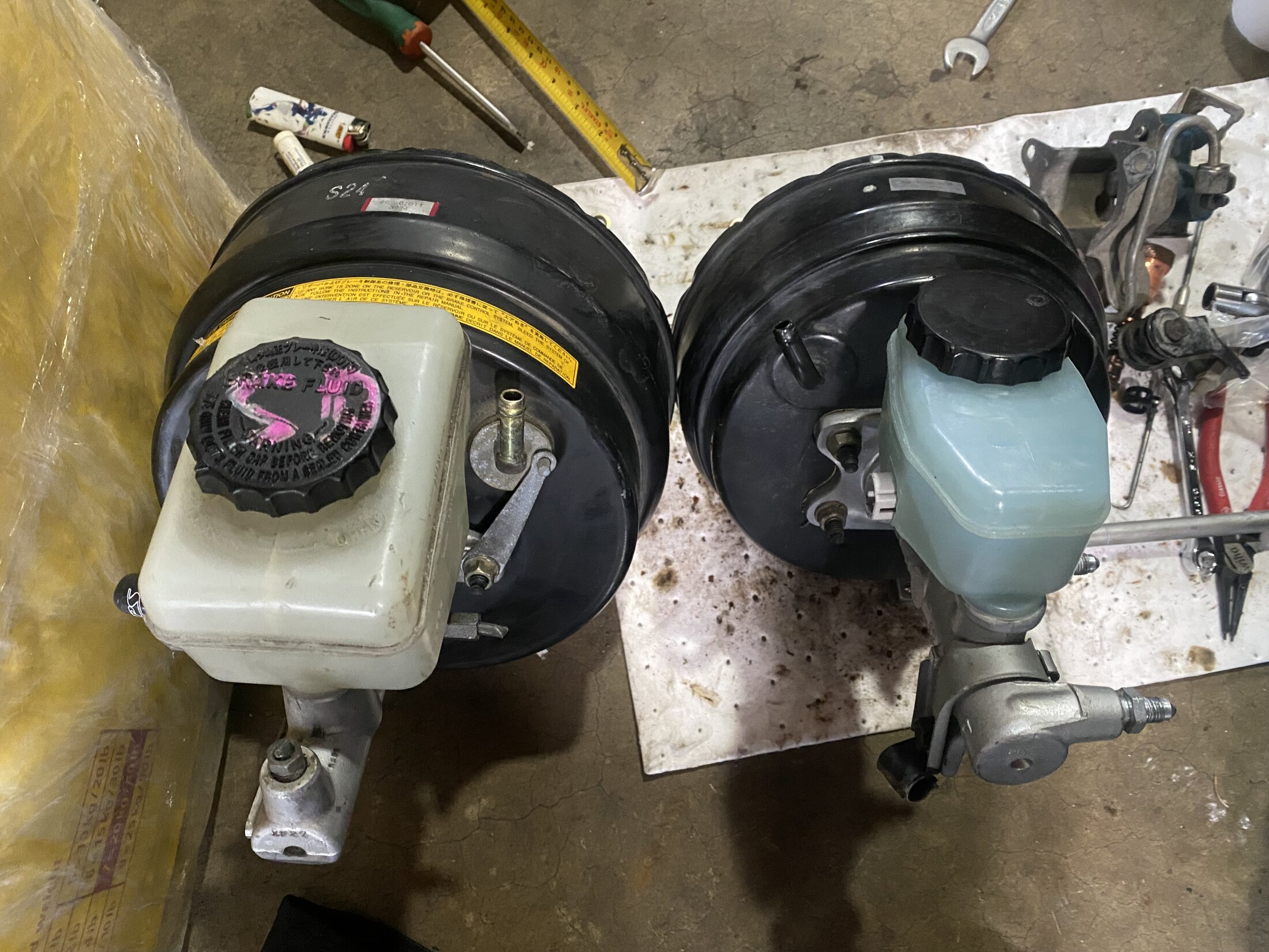

Very interested in the details of this modification, my master cylinder recently started leaking fluid and the booster is likely filling up with brake fluid. Looks like I’m going to need to replace the master cylinder at least, probably the booster as well and original parts appear to be NLA.Todays modification. Due to higher ability of the engine, braking power improvement is a must.
The results are, stopping like a Mercedes Benz feeling. This include the pedal feel
I don’t know from what car, but I did order another one for spare. If ur intrested let me know. FYI it is not brand new it’s secondhand.Very interested in the details of this modification, my master cylinder recently started leaking fluid and the booster is likely filling up with brake fluid. Looks like I’m going to need to replace the master cylinder at least, probably the booster as well and original parts appear to be NLA.

Looks pretty similar to the 80-series MC/booster setup that I am considering. Any chance you have a source for the fittings and hoses you used to connect up the master cylinder? I really like the clockable 90º fittings.I don’t know from what car, but I did order another one for spare. If ur intrested let me know. FYI it is not brand new it’s secondhand.
Those are earls -3an fittings. The adapter is 1/8 inverted flare to -3an.Looks pretty similar to the 80-series MC/booster setup that I am considering. Any chance you have a source for the fittings and hoses you used to connect up the master cylinder? I really like the clockable 90º fittings.
