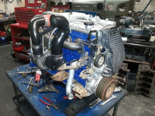

Would love to have that decal. 😊
This one is a 1HZ 😁 fuel feed into the top of the injectors and spill in the middle
Could be, I am by far not an expert. Do you think someone would bother to turbo it in a coaster?
Also the 1hz-t sticker looks to very autentic with all the dust and oil :D
To get back to the OPs original question, I'd say maybe $6,500-$8,000 for something in the condition you are describing. FWIW, that looks identical to the 1HZ I recently got from a low mileage de-mil'ed armored HZJ76 (which also had the Safari aftermarket turbo fitted). But keep in mind, the 76 came with a R151 transmission instead of the H55 or H151 so it has a smallish 4Runner gearbox (which may be perfectly fine for your application).
If you find out the part number, see if you can order it. :cool: I'm guessing the 'factory' 1hz-t uses the stock toyota 1hz setup adapted to merge with the stock toyota 1hdt setup somehow.

Regarding the "factory turbo," in the original post, it looks quite aftermarket. The silicone pipe + hardware store hose clamps gives this away.
I can't see the details on the turbo, but I would guess it's aftermarket as well.
