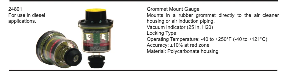

Get a genuine air filter and see what the restriction is like.
Same. I have both the OEM washable and paper filters seems very restrictive also maxed out the filter minder. It’s possible this turbo just wants more air. Could have been turbo over speed condition because of the crack in the housing. More testing needs to be done once I have the turbo back from repairs.
Looks like I’m not the only one with these wix filter minders showing maxed out clogged filters on stock air filter configuration.

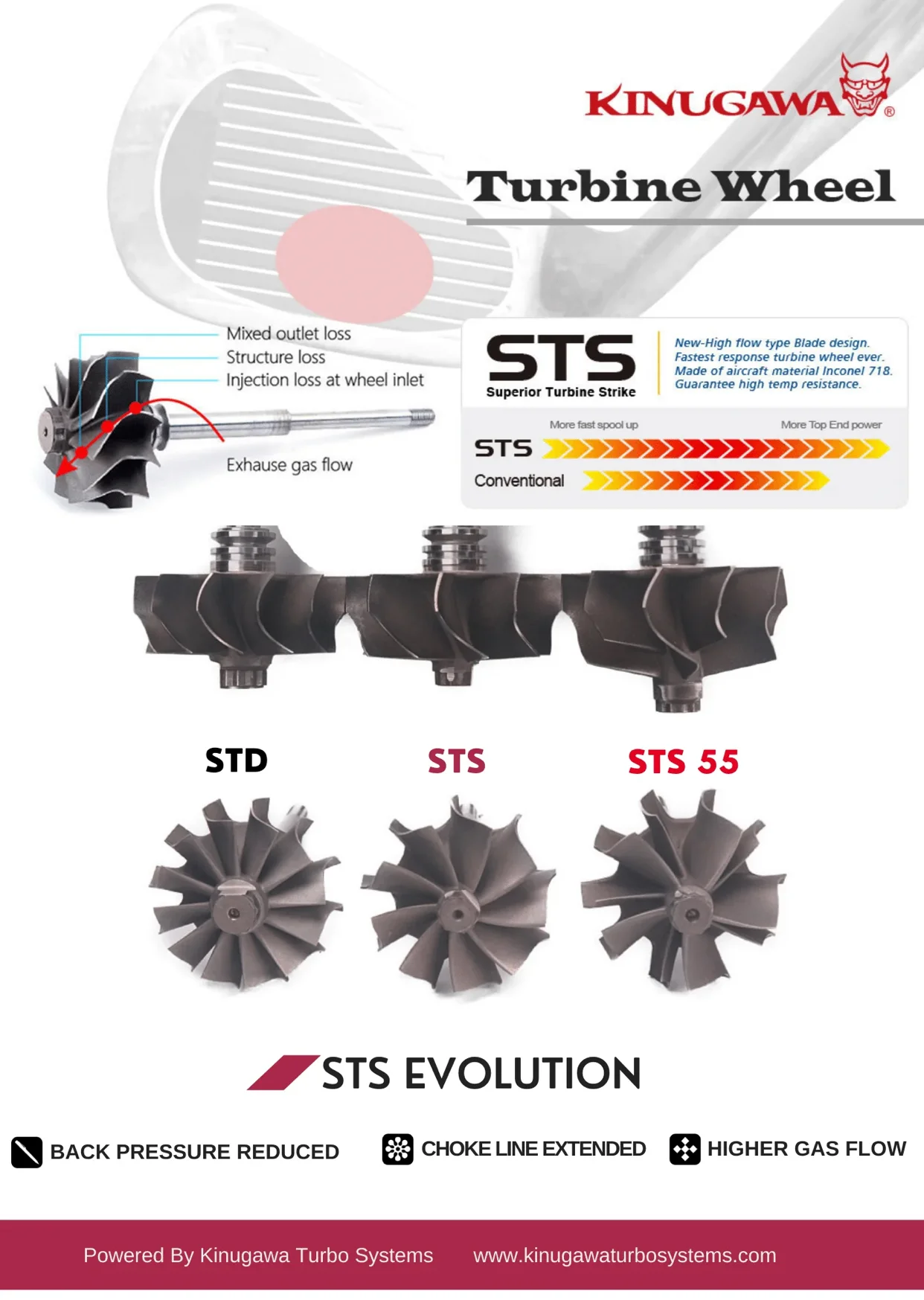

Round 2
turbo came back from warranty. That was actually pretty quick for having to send it half way around the world.
If anyone is wondering RMA process was flawless.
I paid shipping 1-way.
I also opted to upgrade the turbine wheel to the 10 blade STS 55
Let’s see if I notice faster spool.
Round 2

I have snorkel but the snorkel opens up larger than 3 inches.
3 inches from the turbo inlet. Factory air box is 3.25 inches then to snorkle 3.5 inches. So the pipe path gets larger. I'm sure the restriction is on the filter.
As per the filter minder and trying 3 different filters. (Also tested filter minder with vacuum pump and it is within spec. )
Waiting on an aftermarket filter to try. Its backordered. I'm trying the aFE
Part# 10-10008

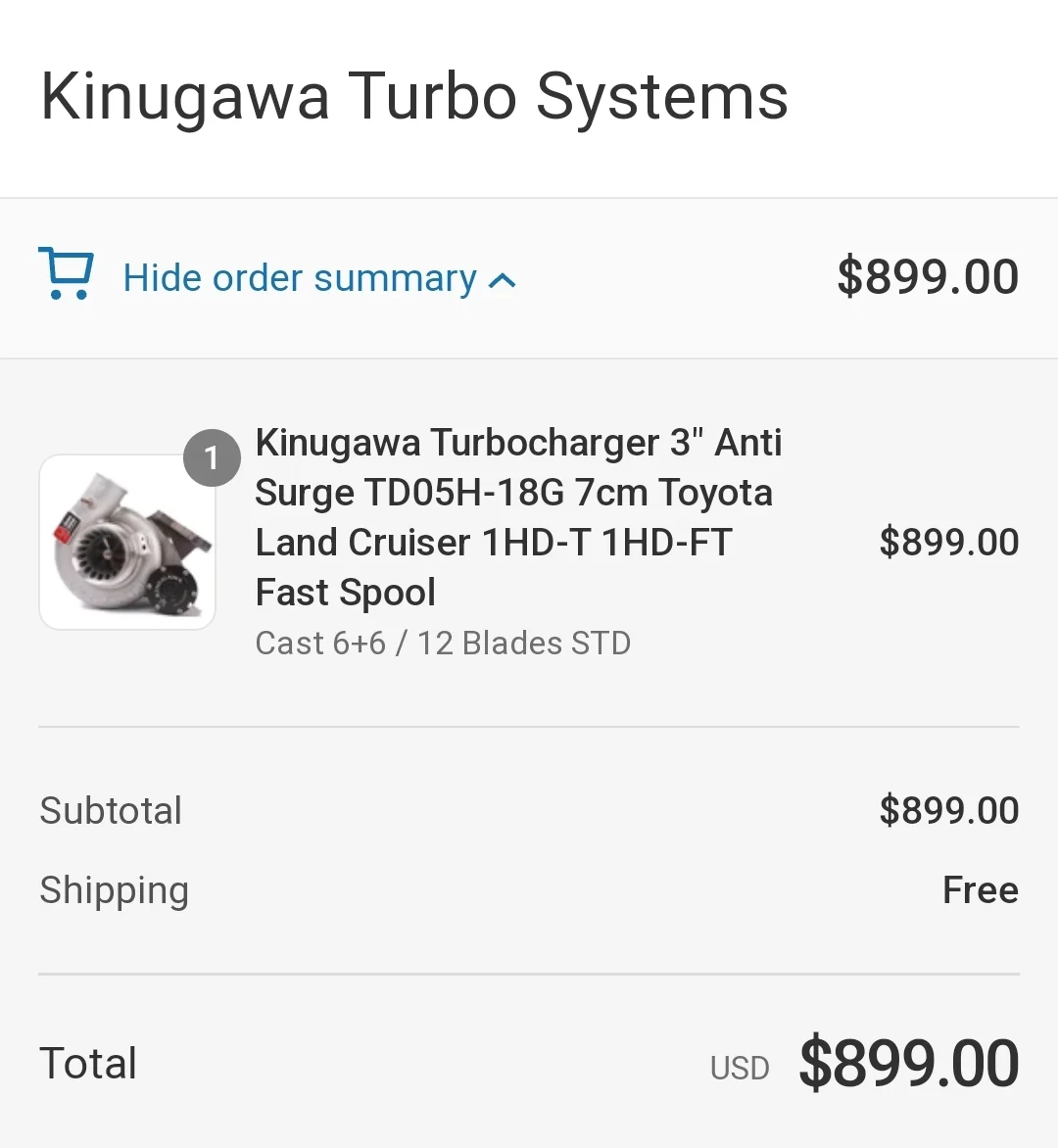

Why no billet wheel and no sts ad-ons?
