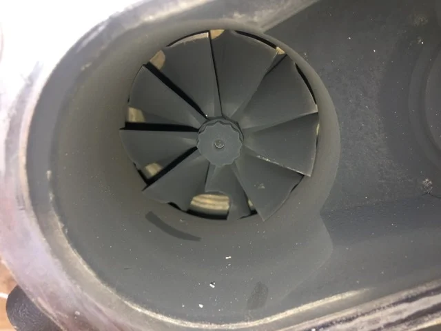

I’m on a TD06SL2 18G 8CM
6+6 billet wheel
9 blade exhaust
Same turbo as this but 8cm housing.
Can’t see the turbo but is burried in there.

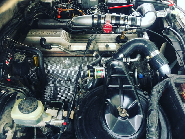

What's the big red thing in the inlet manifold piping

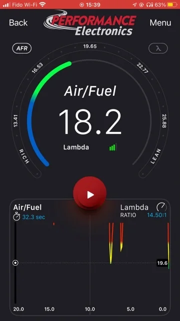

Sometimes I’m getting perfect AFRs I really need to find a long steep hill to tune this better. AFRs bounce all over the place.
AFRs in a diesel will be all over the place.
Constantly changing.
Depending on throttle position, engine speed, engine load, boost etc
Your really just looking for a peak to be sure you're not overfueling.
If you had sustained AFR of 18:1, it would show up as high EGTs.
Reading both in conjunction gives you a read on your tune.
Also, if you were seeing AFRs of 18-20 when you're at full boost, you're probably running too rich.
The screen shot of your gauge above, the graphics shows a rich condition as blue, or green suggesting its giving you a cool running condition. That is true for a gas engine, not true for a diesel. I wonder if the graphic is able to be changed to show rich in orange and red colours for a diesel application?
yes the application does allow me to set ranges.. i just haven't done it.

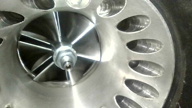

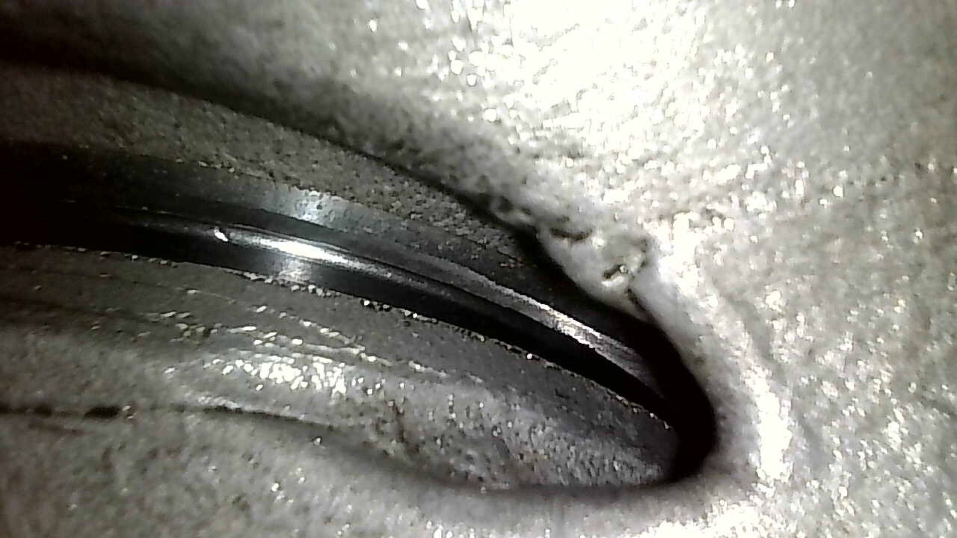

I figured out why I can't build boost I inserted a borescope into the turbo air outlet and I found a crack. so sad :(
What that's BS!
I'm not sure if that's the housing or turbine rotor. Manufacturers issue
Yes I'm waiting on RMA. they said they would send it to my email...
all this time I thought it was something I have done or missed....
glad I had a borescope to check inside the compressor outlet... first time I have seen an issue with the housing
perhaps under higher boost the crack opened up and now the compressor wheel touches the housing... I was driving and I heard a loud POP and lost all boost... I was not far from home so I just idled it back no power.
