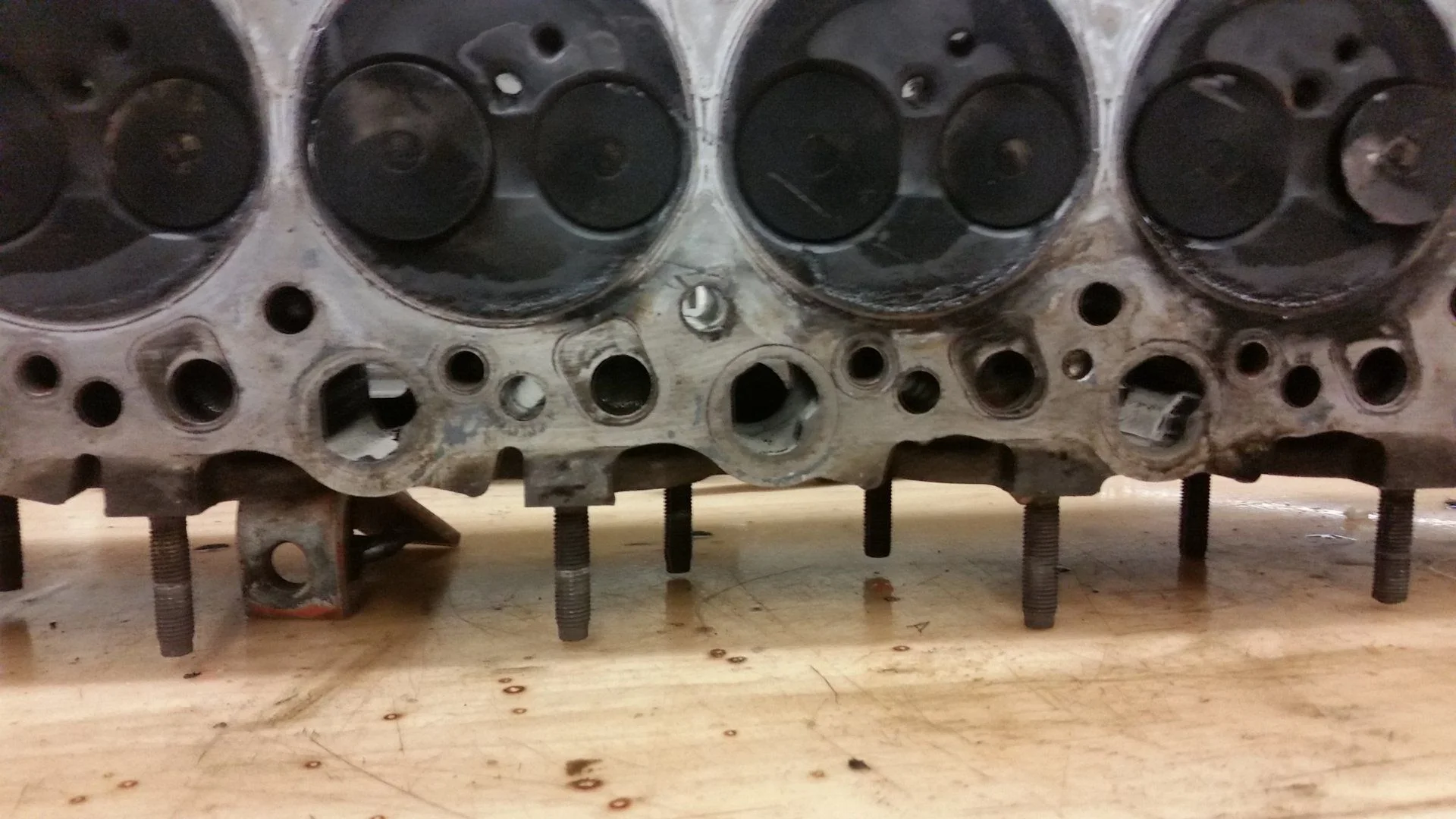

I noticed recently that my Land Cruiser with 1HDT was pushing a bit of coolant into the Overflow. I remove the head and did an inspection. I found cylinders 4 5 and 6 we're leaking on the right hand side of the Block near the back into the water jacket. I checked the cylinder head for straightness and it's flat and looks like it's probably been recently machined. I measured the block and found that there's .003" warp in the block deck. The service manual says .007" is the limit for warp. Mainly the right-hand rear of the block has the issue when measured with a Precision straight edge.
Also of note the head bolts seemed pretty loose in comparison to when I installed them. Before removing them I loosened off a few and retorqued them back to the factory spec. To my surprise all the bolts took 90 degrees extra turn at least or more to get back to factory torque spec. 51 ft/lbs + 90* +90*. Bolts oiled, cleaned the threads in block with tap. Oem gasket and bolts.

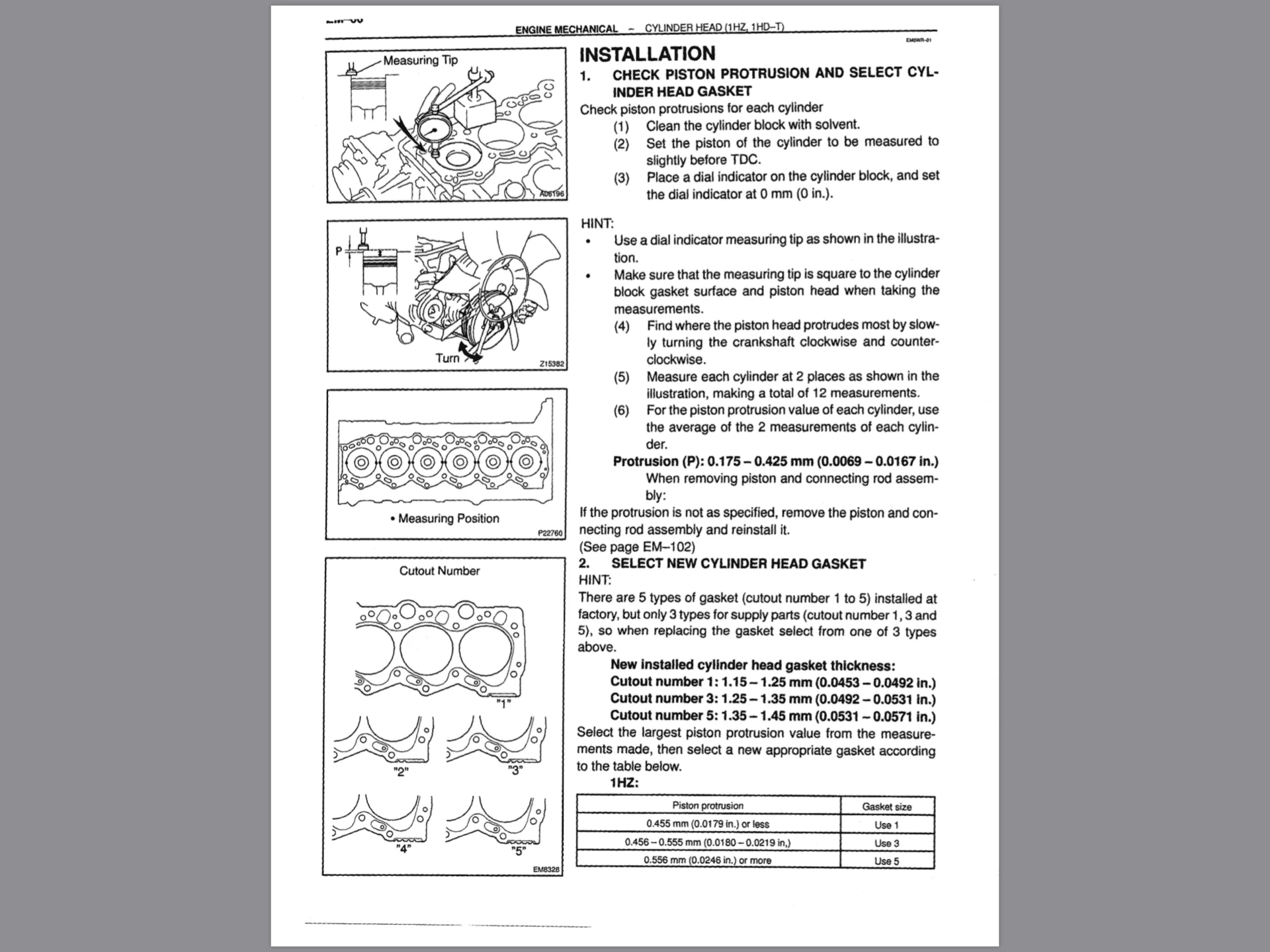

IF the head has been milled, carefully measure valve protrusion from the head and piston protrusion above the block deck before ordering a head gasket. The HD-T series engines are interference engines, ie, they rely on the gasket thickness to provide clearance between valves and pistons. Getting the right thickness gasket is critical, milling the head makes this more critical as valves are closer to the pistons after milling. There is fairly limited scope to mill the heads of these engines

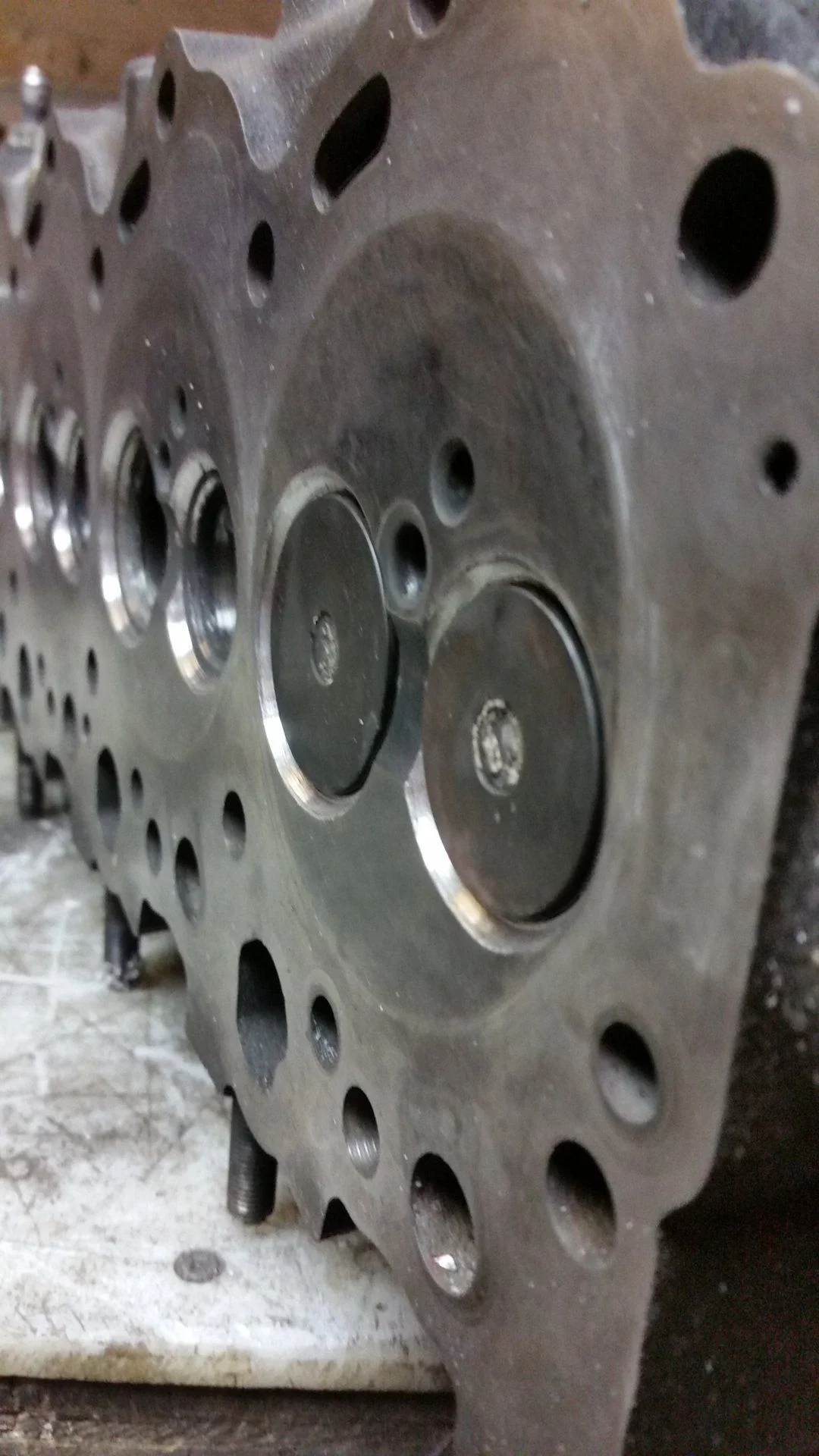

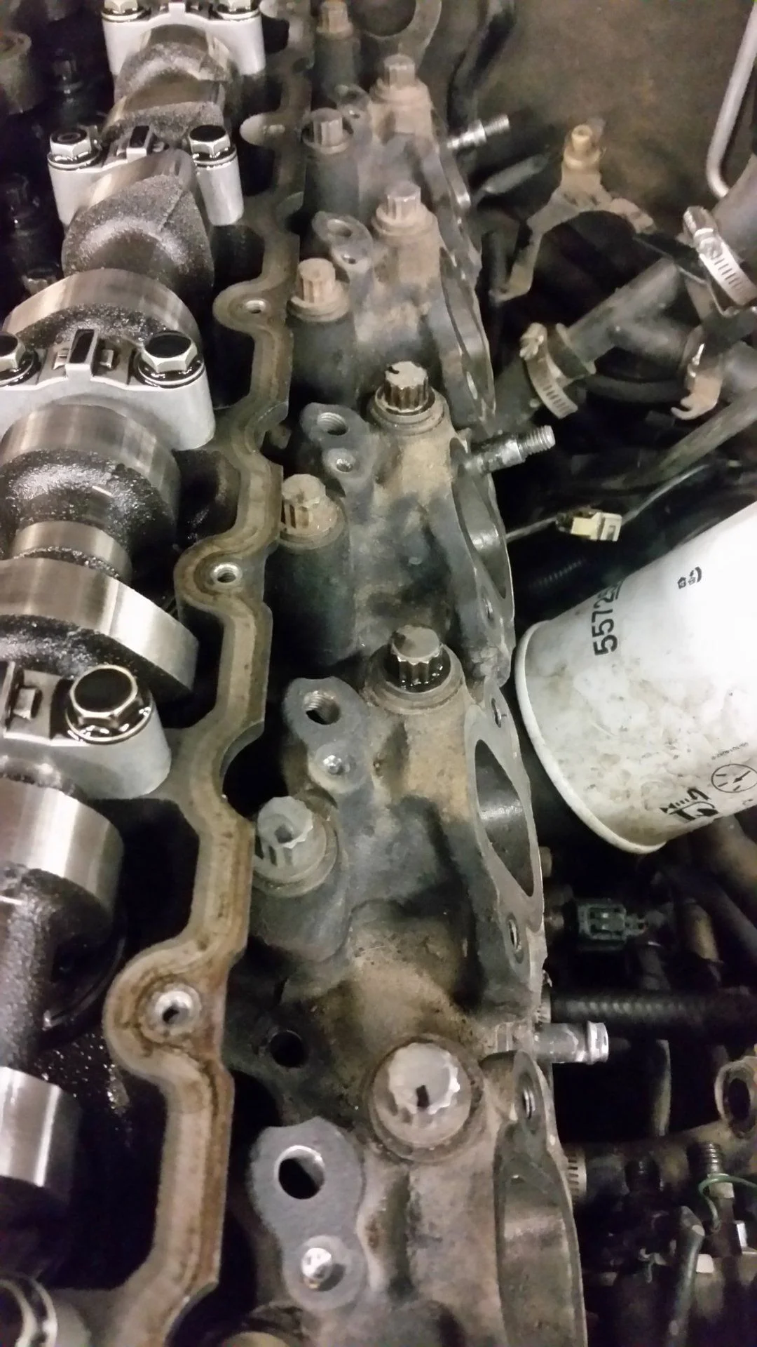

So because it is not excess power blowing the gasket I decided to do a little more port work. I unshouded the valves.....idea stolen from Riverina Cylinder Heads facebook page. Didnt have the proper tools but made do. Not perfect but functional.
Kiera says happy Halloween. (funny she doesnt look happy)
Be careful deshrouding the intake valve as you can make it easier for intake reversion on the last bit of the intake valve opening when the piston is on its way up. This is especially true with low intake port velocities and longer duration. Both occur at low rpm which is a primary goal for most diesel guys.

Toyota use one of five different thickness head gaskets in the factory, aftermarket there's usually 3 thickness available.
Yes both gaskets were 5 notch the thickness of installed gasket is close to the manual.

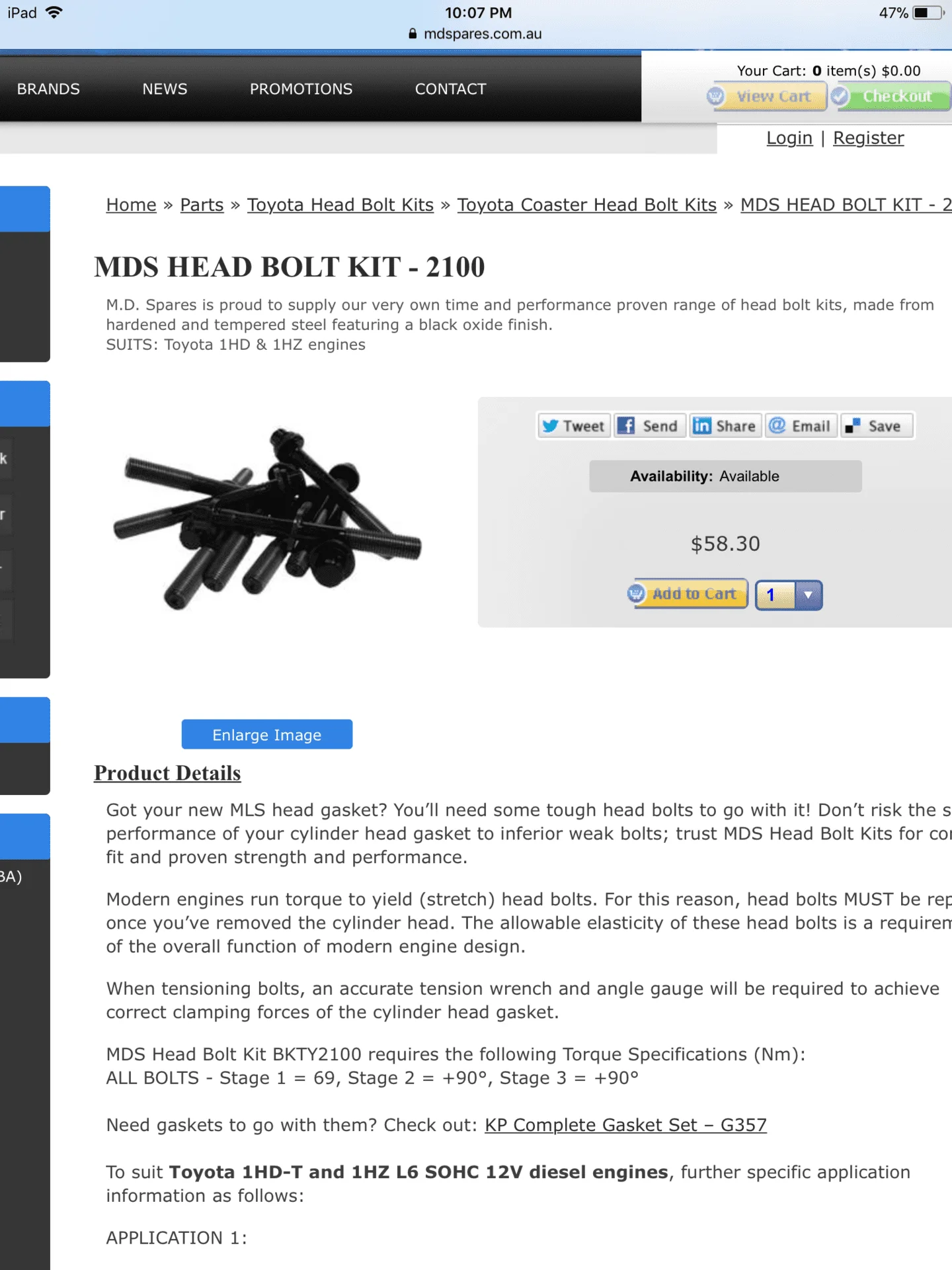

I was looking at head bolts from different vendors and I found these bolts with a different initial torque. 69ft/lb plus 90* plus 90*.

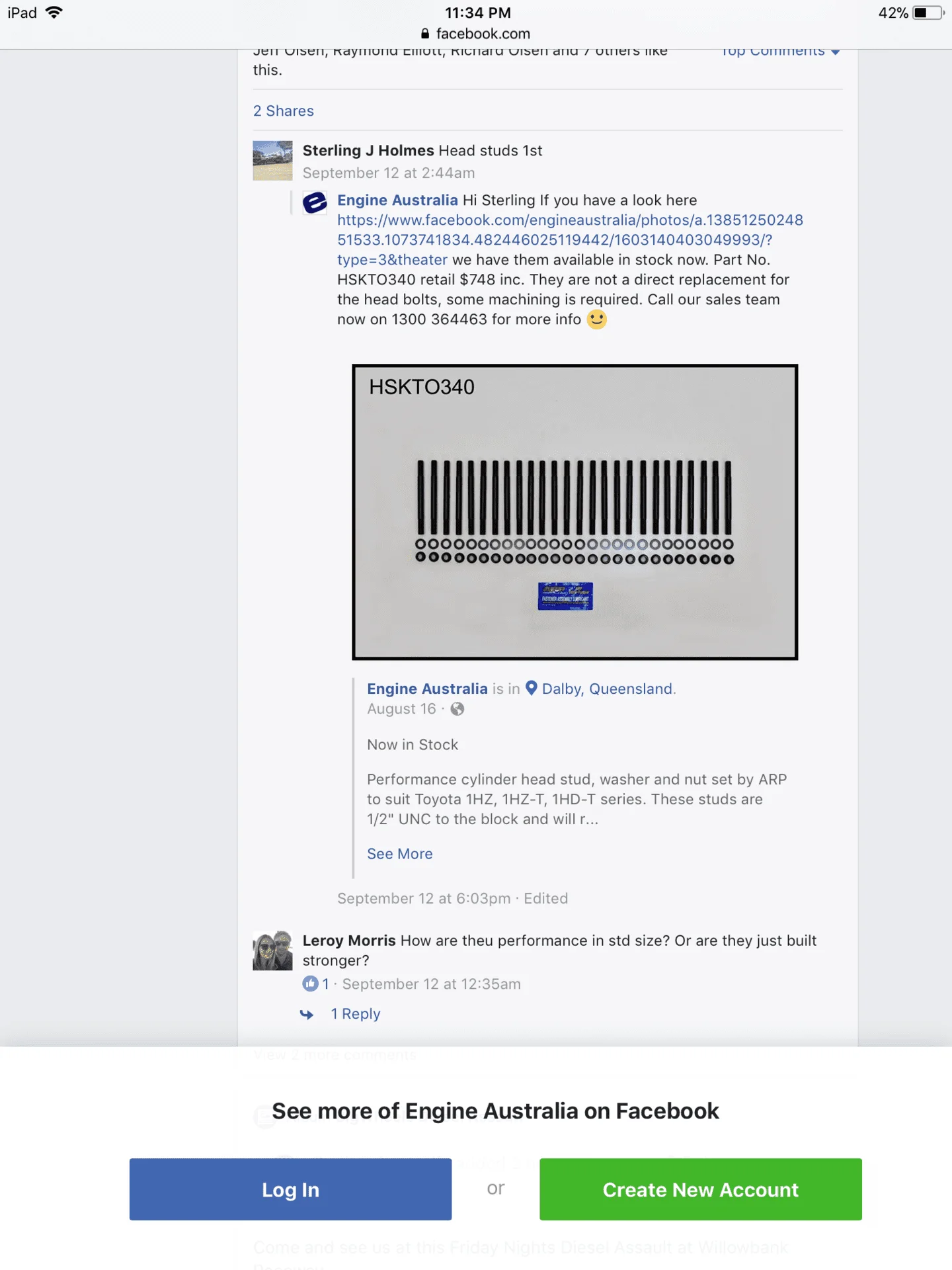

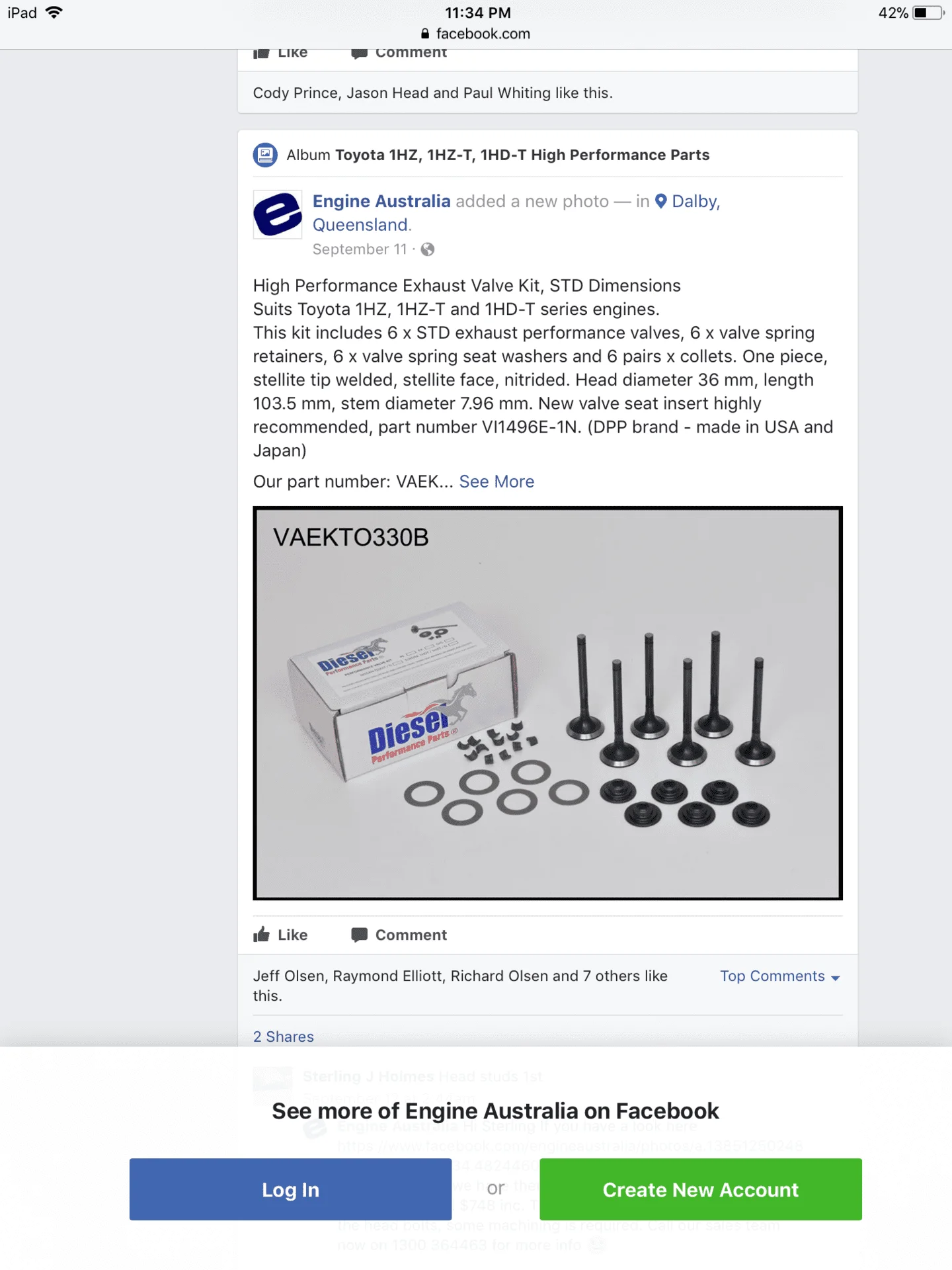

You guys in Austrailia have a lot of choices for top shelf engine builders. Lurking about on the web and found this too. Arp studs, oversize valves, lack of cash....:meh:
I did think a little about this...
My thoughts....I think the 1HDT is tuned towards low speed running with little valve overlap and consevative valve timing for intake closing. I am sure I saw a published figure in a manual for valve timing. I would guess less than 25* after BDC for intake close which is very little piston travel. If there is reversion with stock ports then it makes sense that porting would increase the amount of reversion. I am interested in improving inlet flow into the cylinder and exhaust gases out...bulk flow.
The deshrouding will give a significant flow benefit when the intake valve is just opening.... the sooner you can get the gases moving the cylinder filling will be that much better. Gases are heavy and it takes time to get the flow moving or stopping. the deshrouding of the exhaust will have the same benefit for gases leaving the cylinder...start flow early in the valve lift cycle. this should provide more cfm of flow total.
in theory..... :worms:
:hmm: wish I could test.....i'll need a pressure transducer in the intake hooked to an oscilloscope.
That's the problem with head porting. You can't measure power improvement easily even with a flow bench. I know when I port my heads I am continuously tempted to deshroud the intake valve....like constantly. I chose to work in the bowl and blend the grinds on the intake valve to improve flow up until it entered the cylinder. Deshrouding the exhaust valve is a no brainer. I based my porting off of low lift low rpm v8 engines that were focusing on building low end power. It's the only porting on an engine I've found that came close to running like a diesel.
