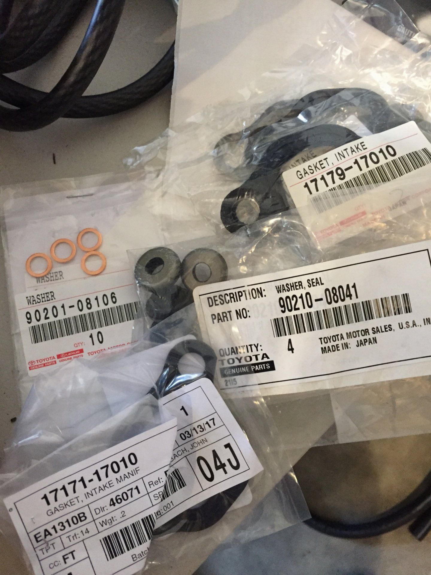

Can someone throw up part numbers for the gaskets and the seal washers?
Crossover pipe to IM gasket: 17115-17010
IM to head gaskets: 1X 17171-17010 and 5X 17179-17010
I would recommend genuine gaskets and also replacing the seal washers.
These seal washers, they are between the fuel hardlines and the injectors, correct? Any chance you've got a part #? I can't find a diagram with anything shown there.
Edit: well that didn't show up for some reason...
Can anyone clarify where the seal washers can be located?
I get 90201-08106 at ToyDYI in the injection nozzle detail. EPC shows a host of applications. Two per nozzle. You want slide 22-01 in either EPC or DYI.
hth's
gb
EDIT: Crab's got it...see pic above.
@Crab Sack I'm a bit confused, the copper washers are what I thought @David60series was referring to, but your pic shows a rubber seal for the bolts holding the IM to the head being called "seal washers"?
Copper washers, 2 per injector, so I'd need a dozen of these, correct? Have you had your manifold off already, and were the seal washers 90210-08041 needed/deteriorated, or you just got them incase?
You need 12 of the copper washers.
Correct, you need 12 of the copper washers for the fuel rails.
The seal washers are for the intake manifold and mine were a bit dry but otherwise in good shape. I just got my manifold off last night to pull the injector pump to rebuild. I don't like to re-use gaskets so I opted to replace all of them while it was apart.
I see where you were going now. Thought you did not see the details in EPC or DYI.
