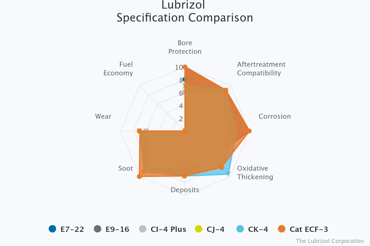

The proof of an oil performance is in the certifications it meets. It can't be certified to a spec unless tested and passes.
These little spider carts are always a good tool to really understand what level of performance an oil meets.
The Cat spec is pretty much covers it all. You know it's a good lubricant if they pass their cert.

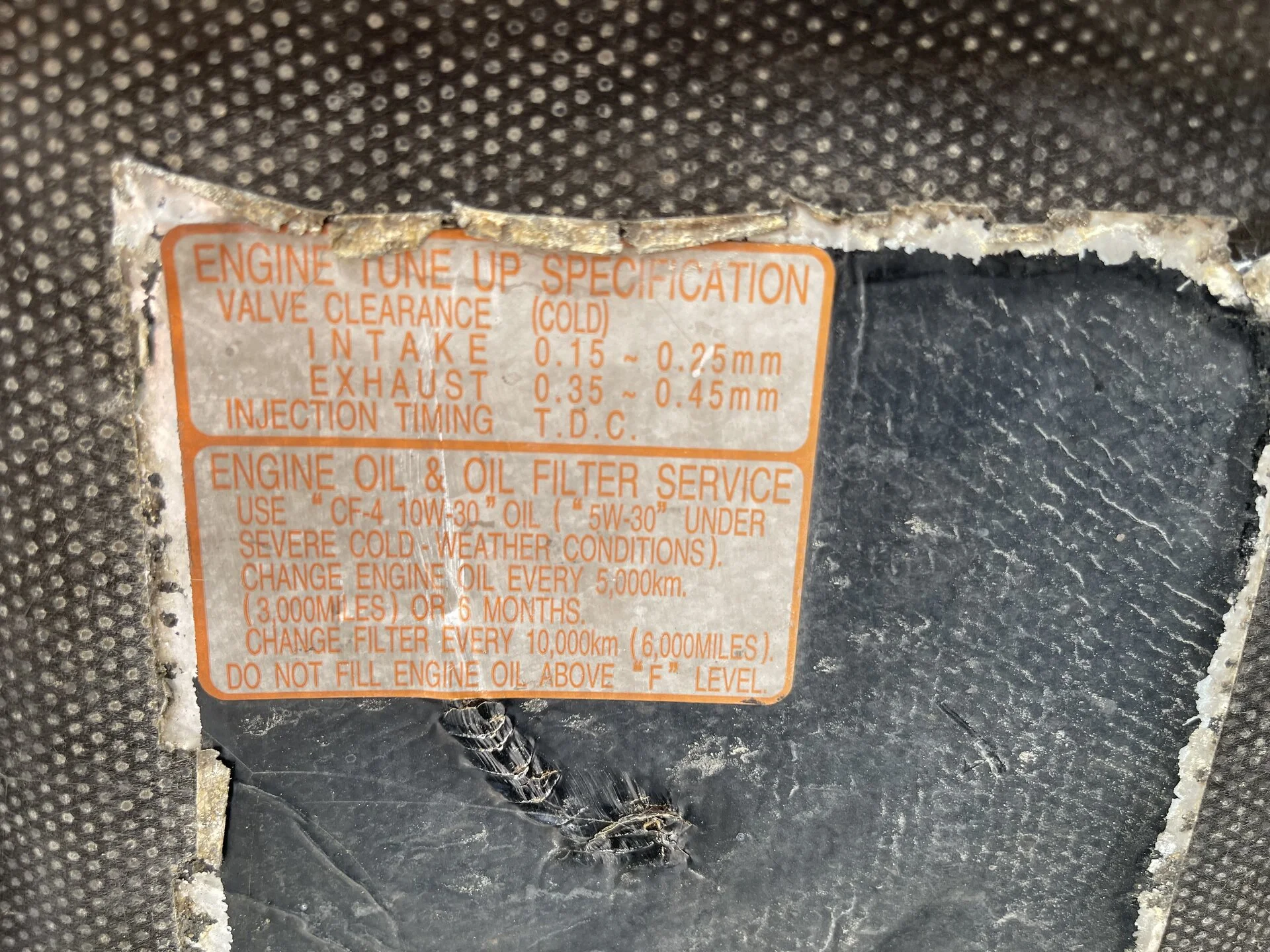

Oil viscosity and oil change interval on my 1HZ powered 105. I believe it's the same for 1HD-T and 1HD-FT.
Back then Toyota stretched the FTE intervals out to an enormous 7,500km. Because the FTE ran a whole lot cleaner than the earlier engines. Less soot in the oil.
Note the progression in oil standards. CF oil on that chart is C for "compression ignition" (diesel) and F was the grade.
