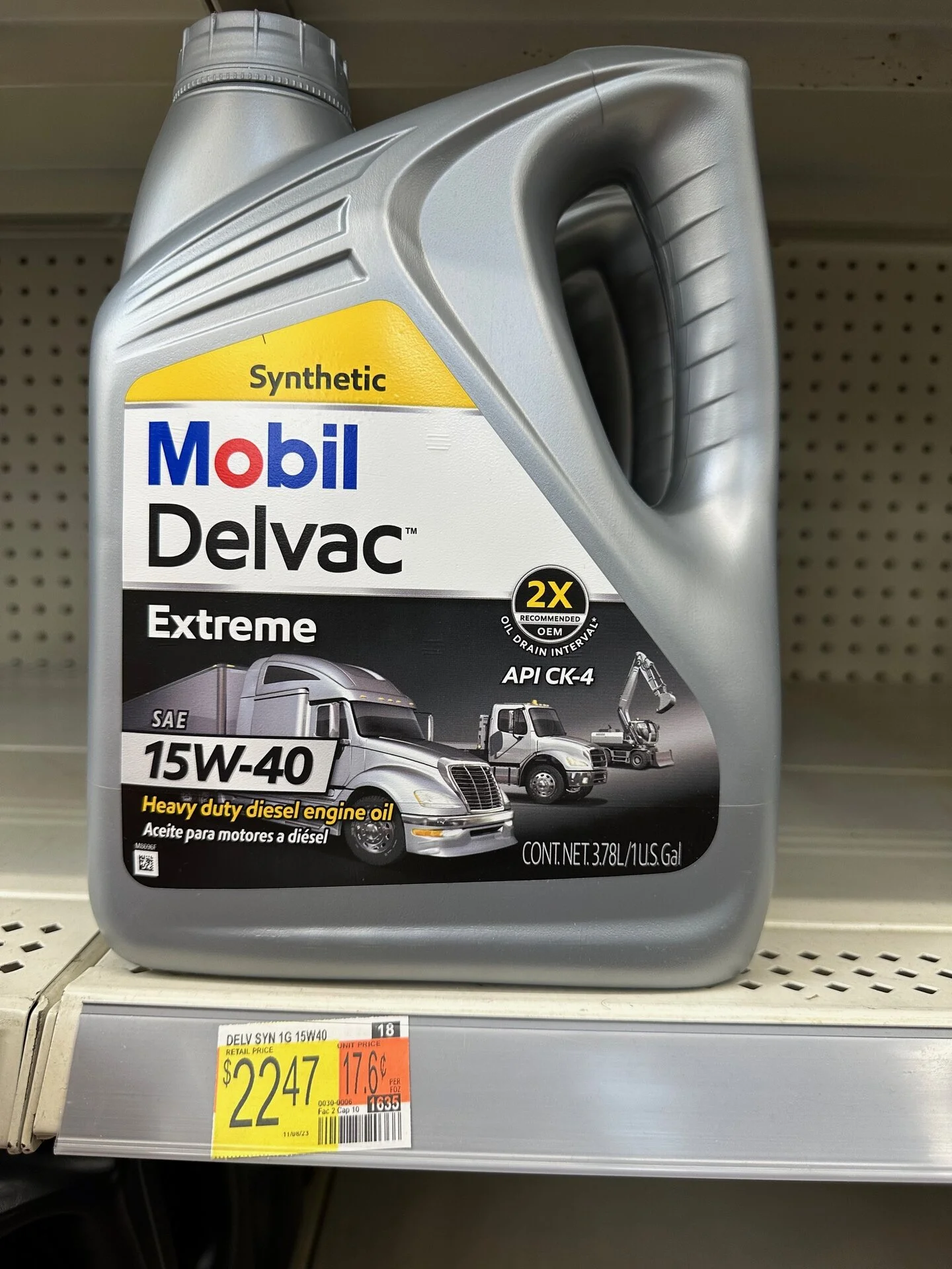

Alright... don't flame me too bad for these questions. I found lots of info on engine oil via search engines and this forum, yet I could not find an answer to my specific questions.
I'm trying to decide on a synthetic engine oil and viscosity for my 1HD-FT. I am a huge fan of Mobil 1 Synthetic, and would prefer to stay with that, unless there is substantial reason to the contrary. I've read here that JASO DH-1 spec oil is recommended, but I don't know the API equivalent of it. The Mobil Delvac Synthetic API shows CK-4, CJ-4, & CI-4 PLUS.
So, my questions are... Is Mobil 1 Delvac Synthetic Oil (like pictured below) recommended for the 1HD-FT? What is the recommended viscosity? (I live in Tennessee. Temps generally range from -10 F to 110 F.) Lastly, what is the oil and viscosity that Toyota recommends for those engines?
As far as filters go, I also run Mobil 1. I don't yet have a Mobil 1 filter number for the 1HD-FT. If anyone has that info, I would appreciate it. If the Toyota filter is a better recommendation, I would appreciate that part number also.
Any additional info is greatly appreciated. Thanks!

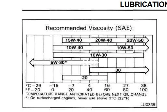

Trust the chart.
I use 15w40 because I store my Landcruisers in winter time. If I had to drive it in the winter, I would use 10w30 or 10W40.
I know some Canadian cruiserhead use 0w40. I wouldn’t.
I use regular oil and sometimes semi-synthetic if it in special at the time I need oil. I change the oil every 6-7000km.

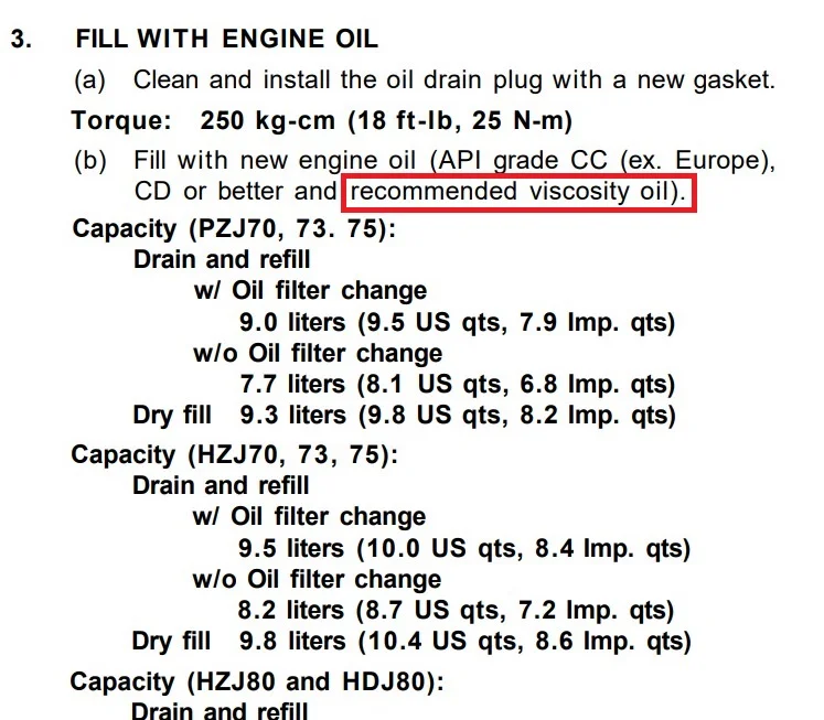

Yeah, the FSM specifically said do NOT use 5w-30 above 32 degrees Farenheit on turbo-charged engines. We only have a few days out of the year where the temperatures might dip below zero. I'm thinking 15w-40 might be good for my area, but 10w-30 might be optimal here, I don't know.
I searched the FSM several times, and I could not find a Toyota part number for the oil filter.

After some searching, I found that Mobil does not offer Delvac Extreme in 10w-40. They only offer it in 10w-30 and 15w-40. I would prefer the 10w-30, but it's harder to find and more expensive. So, it looks like I'll be using the 15w-40 for year round use.
