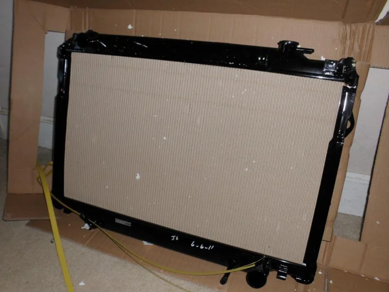

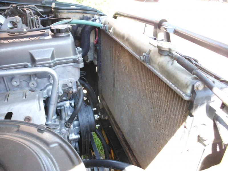

As soon as i got the truck running, i had to shut it down because the radiator was leaking like crazy.
It was my bonehead move to leave the radiator sitting out for the last part of summer all the way until a few weeks ago. Let's just say that the sun can kill em'. :bang:
Here's the old. :doh:
And here's what's going in. Koyo C1917 ..... $286 to my door.
Followed your build from the beginning. Awesome. I put a C1917 in my 94 and it fit like a glove. I did have some trouble with the fan shroud not clearing the lower coolant hose and prematurely freaked out, said f-it and cut a big piece off the shroud....then realized I had been hung up on a nut or something stupid. Now I've got a nice 3" slice out of the shroud. Seems to run fine, but sure its not as efficient. I'm sure you'll be fine though since you've learned jedi mind trick patience on this project. :beer:

New Radiator.
Hat's off to you Alex! Congrats on your engine build. Is that Koyo made in japan?

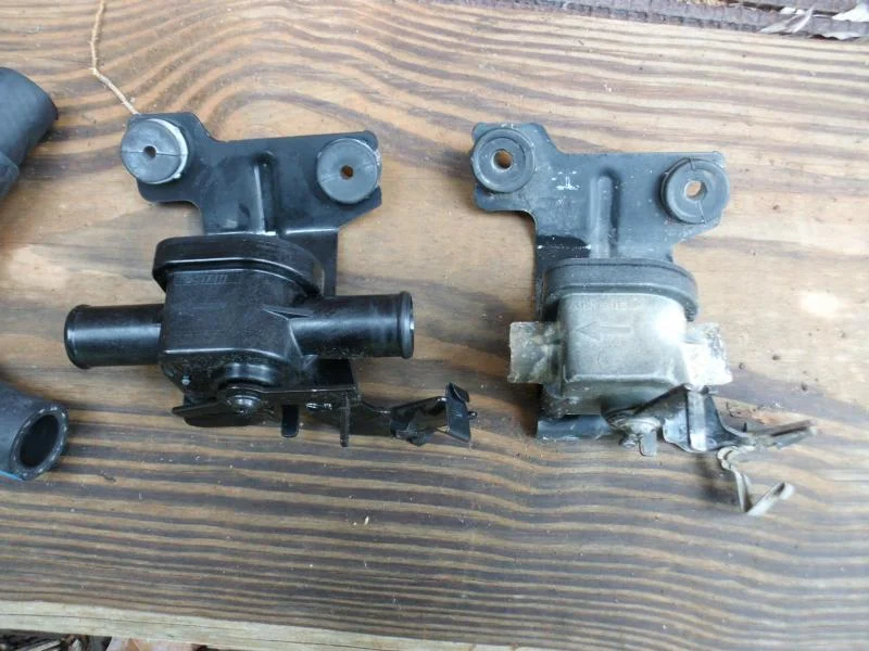

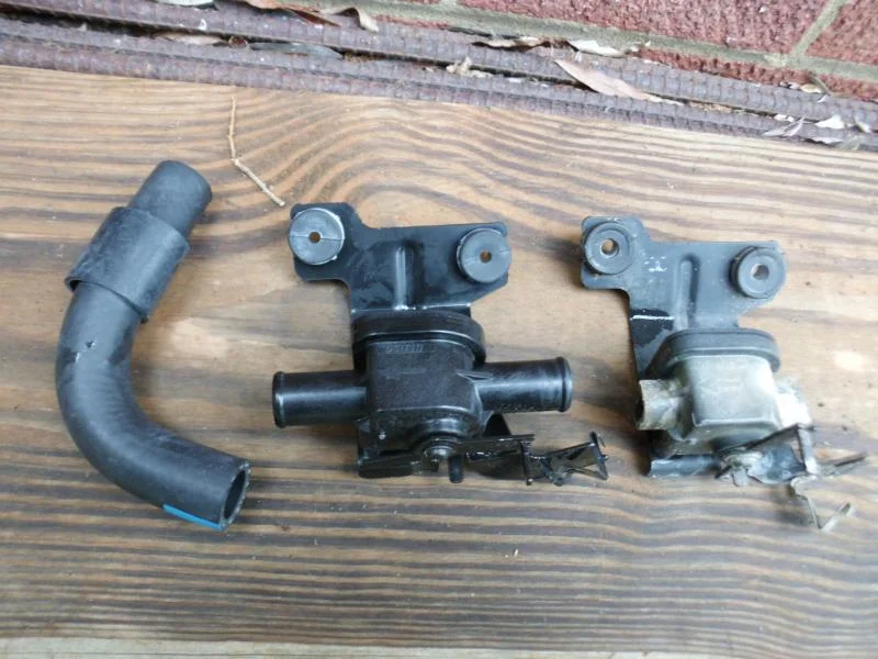

I guess i found one of the small bugs the other day....
Was at the gym and came out to find a small puddle of coolant on the ground :bang: Popped the hood and found the ends of the heater control valve just rotten away and leaking.
This little guy is stupid expensive IMHO. My local Toyota dealership wanted $104... supported a dealer that supports one of our clubs and he gave me the same thing for $61 :grinpimp:

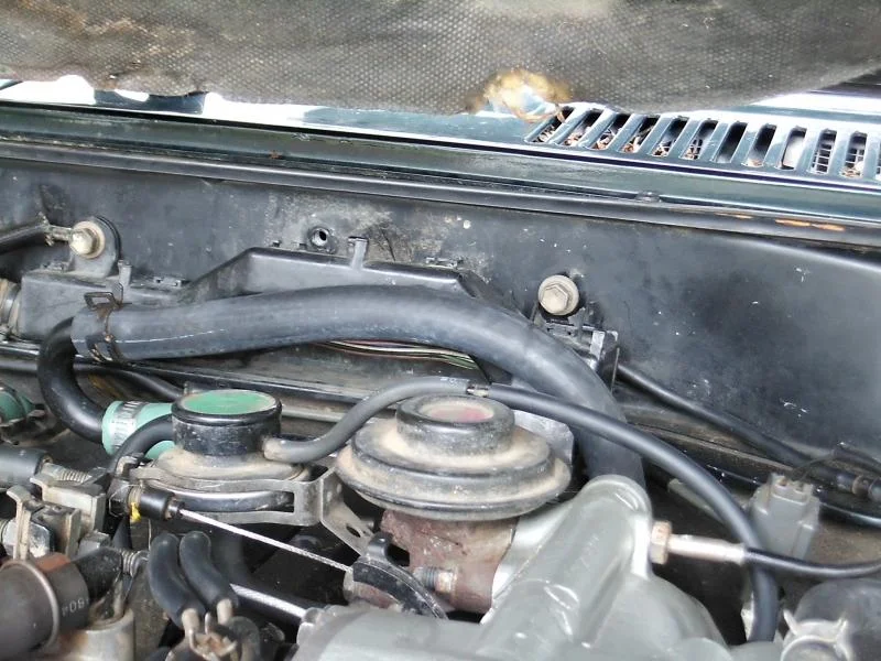

I also have a pic showing how i just bypassed the dang thing for a few days.
Few pics of the old and new here.
I also decided to order the hose that has the 90 degree bend to it. I was having a hard time finding he right hose to fit.... found plenty that i could make fit, but nothing that was right.

When you did the bypass, what was the net effect? If you turned on the fans, did it just blow hot?
I recently found a coolant leak coming from the right side tube of valve. The hose seems to be intact, and the screw-strap is on there securely, so I'm kinda scratching my noggin to explain why it's leaking. Oh, mine is the newer plastic version (one on the left in your side-by-side comparison photo), not the metal-based one.
It's been a while and i didn't go up an re-read my thread. I didn't bypass anything really; I just ran a hose down as one piece instead of having a small hose attached to a hard pipe, then attach another hose to the bottom of the hard pipe to the block... i just went one hose from the top all the way down to the block.
Since you bypassed the heater valve for your short term fix, coolant was always flowing through the heater cores. So yes, it would always blow hot if you turned the blowers on in the cab.
