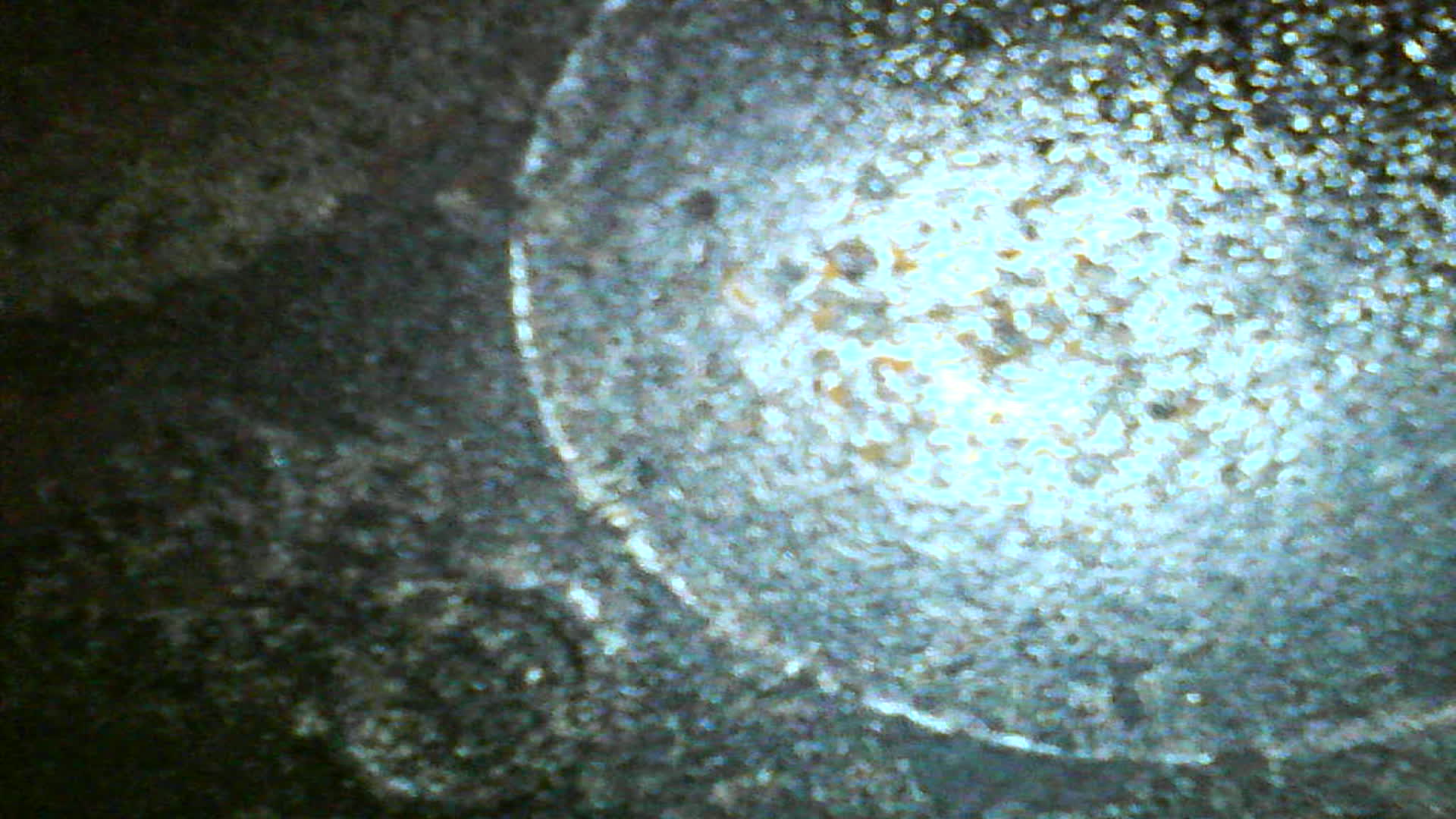

Here are some pictures, as best as I could get using my cheapo bore scope.
After one can of MCCC:
Cylinder after 24 hours of soak (I was unable to get clear pictures after the carb cleaner went in, no matter how much time I spent with the vacuum):
