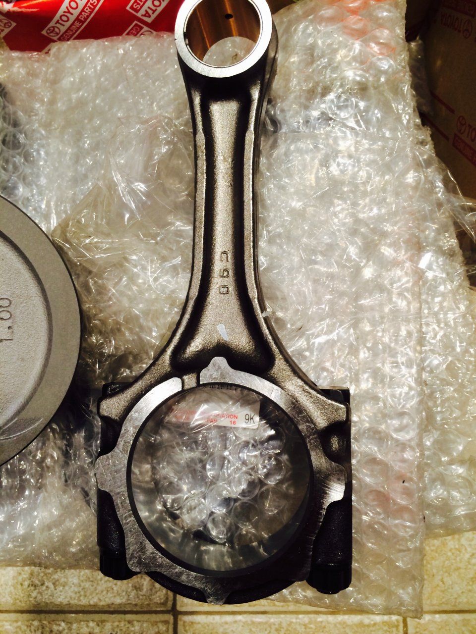

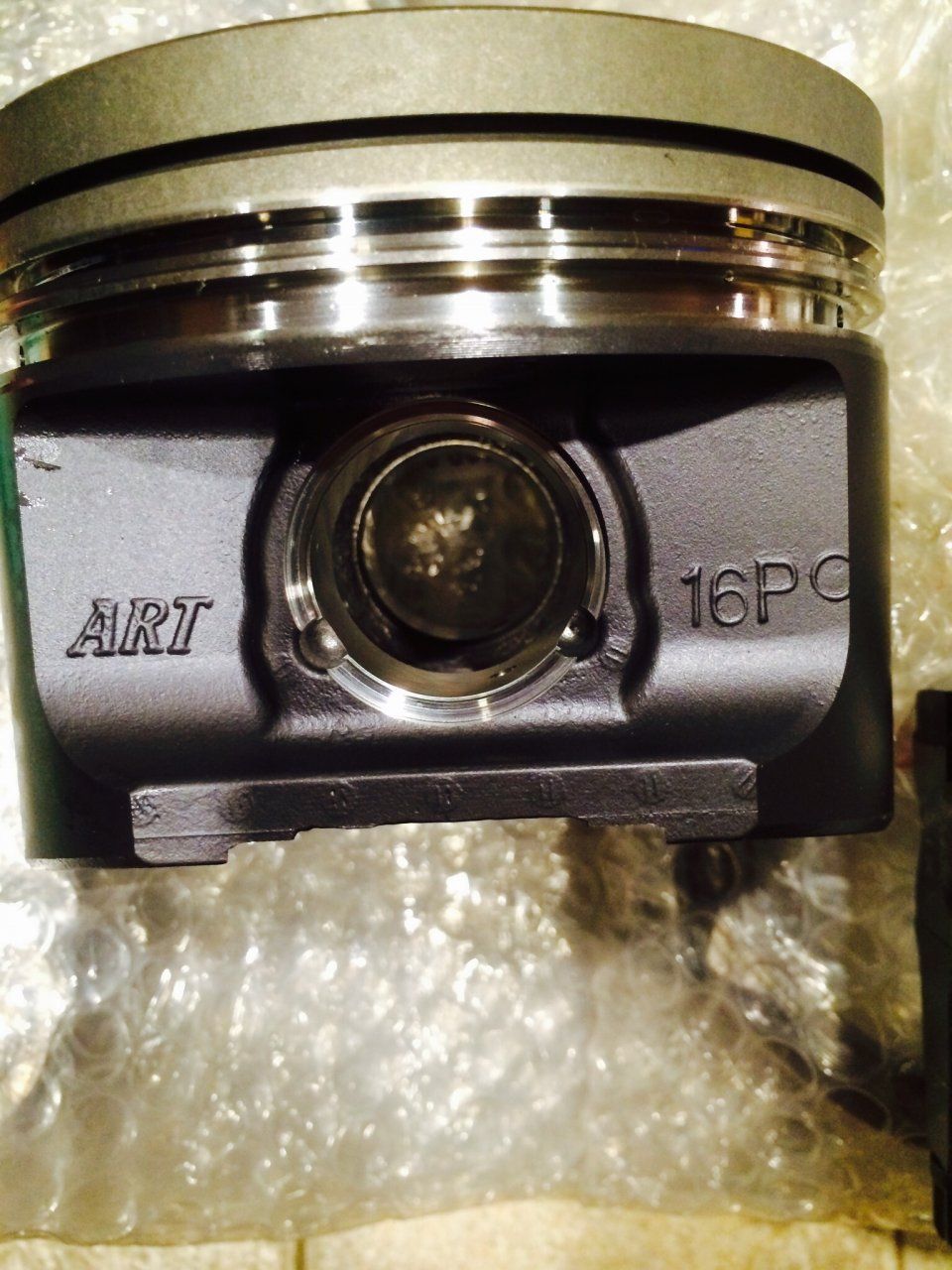

Gotta love hard rods....
And pistons....
And pistons....
Are these forged pistons and rods? For my 3rz 98 Tacoma build this was an absolute must I wondered why more 1FZ engine build posts didn't include discussion of forged components especially with the availability of Joey Turbo.
