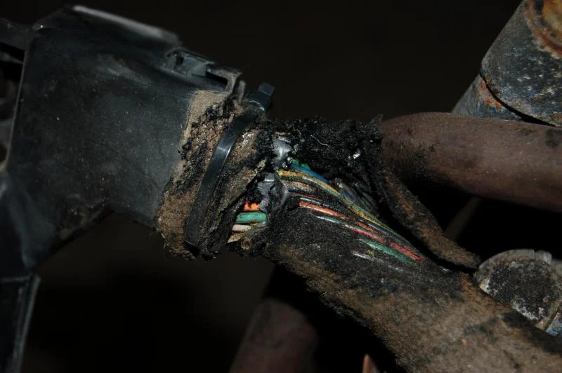

1) Eliminate the carbon that goes into the engine.
2) Eliminate the risk to the wiring harness.
There are other potential benefits and side effects, but none that have been as well documented and are as solid as those two. Those alone are a good enough reason for me, but you'll have to decide if that's good enough for you or not.
Here's one of the best pictures I've seen of the biggest reason to do this (stolen from LT's trubo build thread):

I wonder if ceramic coating the EGR pipe would protect the wiring harness from the heat. Although the question then becomes what will happen to the engine with hotter EGR gases being injected?
Thanks again to Ebag et al for the healthy and civil debate. I know I've learned more about engines and their operation from this discussion. (I'm keeping my EGR though, gotta get my money's worth out of that new VSV!) :cheers:
Ceramic coating is probably not worth the hassle and expense, but that'd drastically reduce temps.
My guess is that you'd be significantly increasing the temps seen by the temp sensor. I doubt it'd put you out of the EGR range, but you'd be on the high end and it's very possible you'd throw a P0402 occasionally.
Then again it might just compensate for all the carbon buildup in it. :meh:
It gets seriously hot though. After all that's heat shielding that it burned through in the pic above. I'd imagine a nice side effect to disabling it is probably reducing engine bay temps a bit. :hhmm:
The pipe leads to the back of the head where it recircs exhaust gases. That pipe itself can get up to 1000 degrees during operation.
