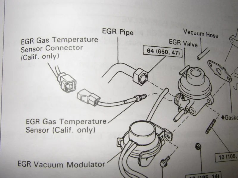

Did you look at the EGR valve? Not the modulator (the one where you looped the vacuum lines) but the one that is attached to that.
Here's a pic of it. You can see the bolt head where Tblumes was removed. It is just up and to the right of the wiring harness plug (which is for the temp sensor). Note that the EGR modulator has been removed.
attachment.php
And the FSM pic.
attachment.php
