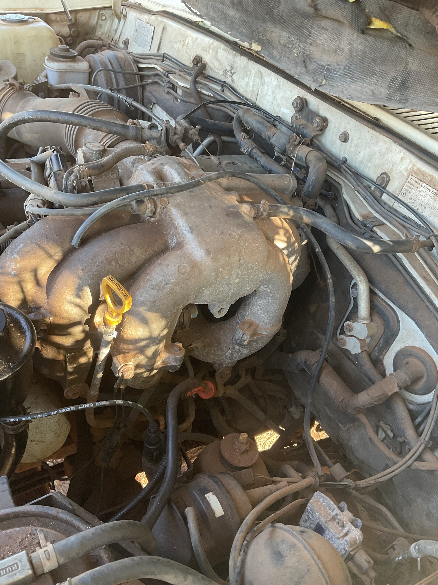

Sounds like a couple cylinders. Took all apart and checked plugs are tight and leads are on.could it be another issue?

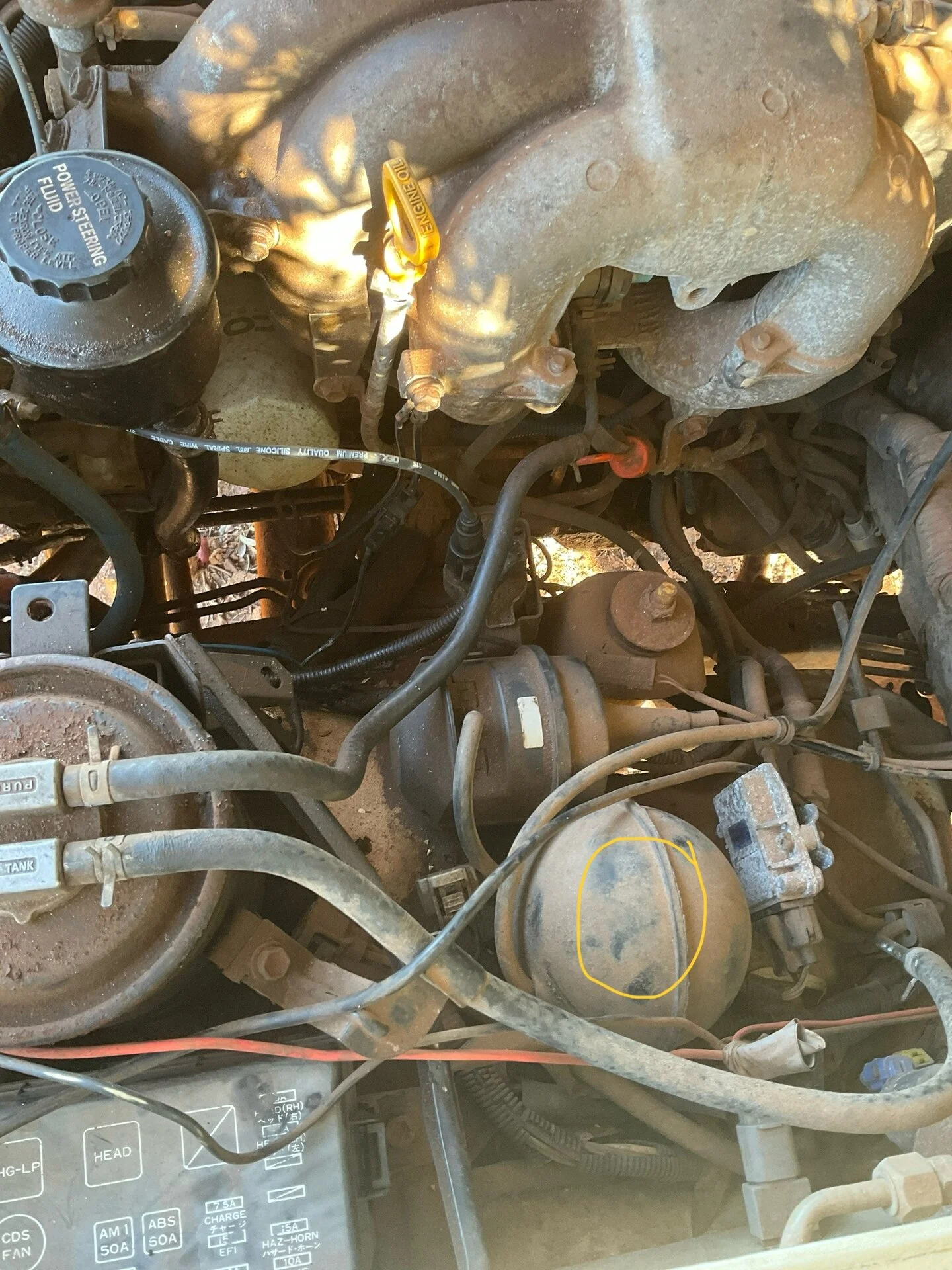

found this hose and don’t know where it goes I guess it vacuum? Second pic shows where it comes from
I don't have one on my 80, but that looks like a vacuum reservoir. I've had them on other vehicles. Maybe check the vacuum routing diagrams for ideas?
