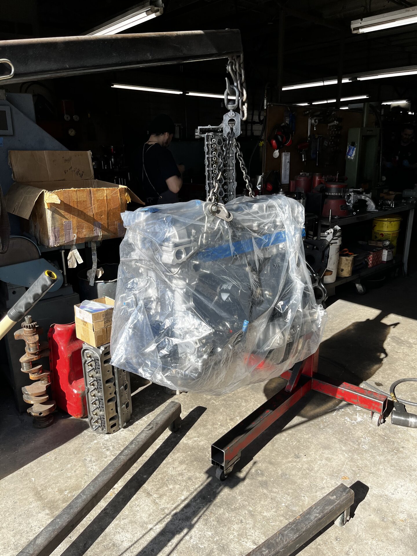

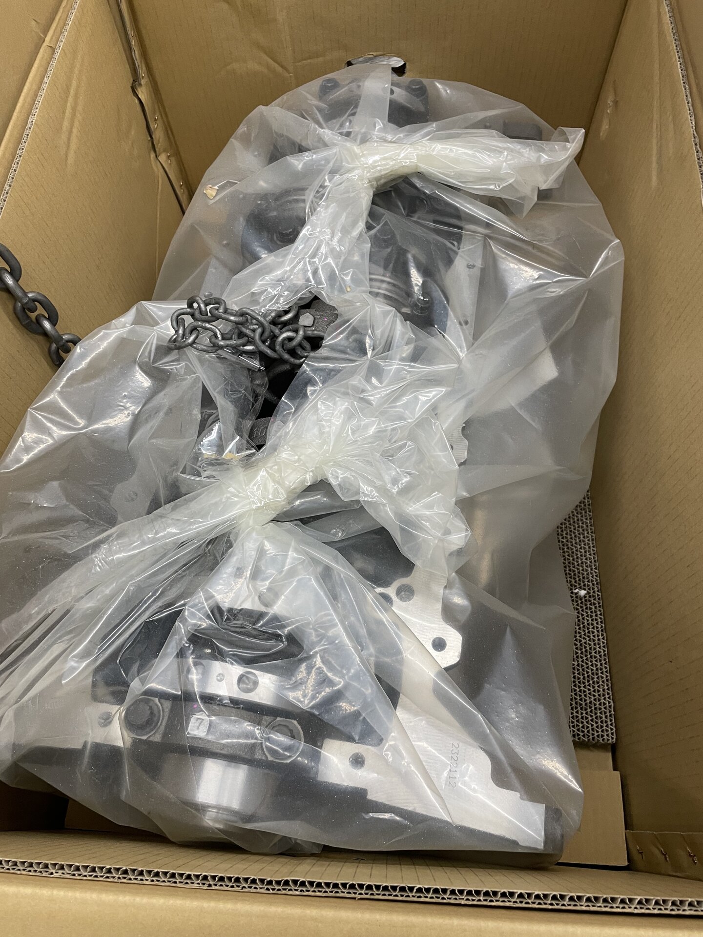

Since my post, I commissioned and installed a new 1FZ-FE with all new factory parts except the valve cover. Even the oil cooler a$$embly. Even the lifters. Even the shims. All Toyota new. I know because I sourced and ordered every dot single dot part.
24k miles and 2 years later, more power and not one drop of oil added between engine oil change intervals at 3-5k miles. 90 mph on 37” MTs. Up and down the Grapevine. Multiple trips up and down the West Coast and out to SLC. Most miles piled up in I-10 traffic heart of LA.

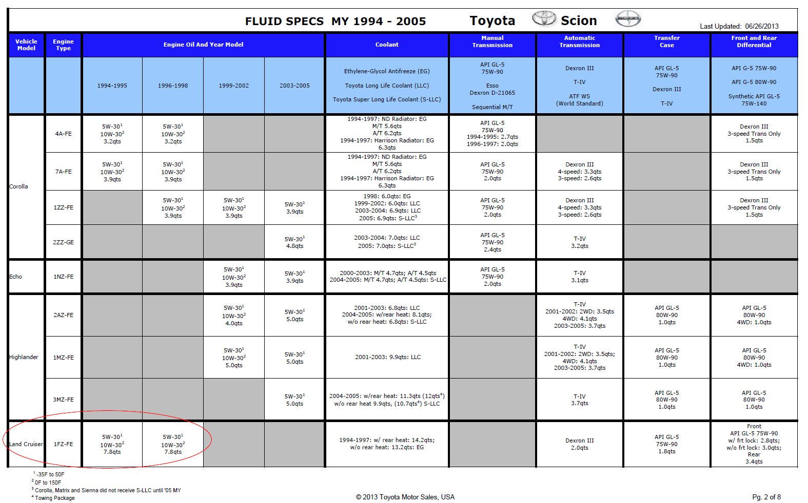

Any chance you remember how much oil you ended up putting in the new engine? I put 8quarts in mine and it’s still low. I’m wondering if I have an issue here with the engine and oil is escaping somehow, or if it really just takes more than that to refill a dry 1FZ.
This is for oil changes only; 8.5 quarts dry. Is your dipstick seated properly?
