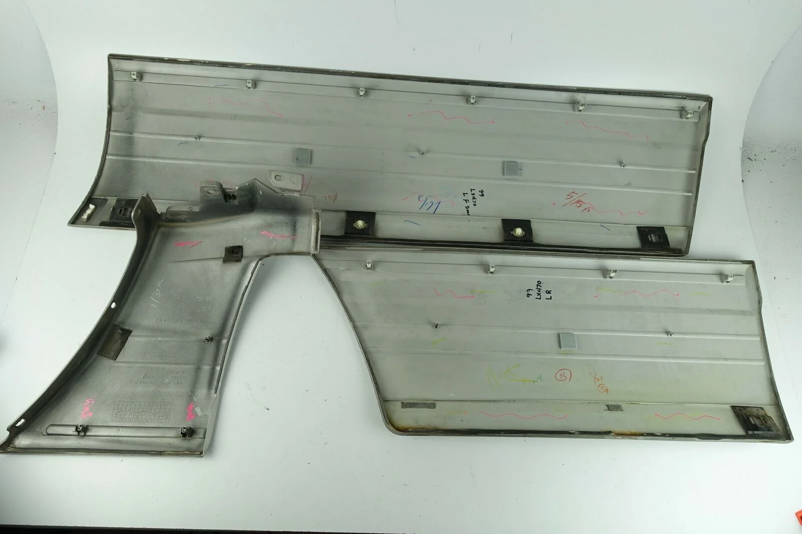

So i have a relatively rust free LX470 but the clips for the body panel moulding have rusted out. Anybody else have this problem? I have searched and it appears only the fasteners that go in the clips are available but not the clips themselves. Searched on ebay and mud but haven't found any that aren't attached to full panels which i do not need. Anybody have a part number for these clips?

I have the same problem. Enough of the clips have broken so I have been able to take a peak behind there, and it's just the clips that are rusting. One of these days I need to pull them off and replace. I have rust stains from them on the lower cladding portion too. It is just the front door cladding for me that is doing this. I need to get part #'s for the clips and get on it myself. Let me know what you end up doing.

I've got the same issue. My tailgate panel was nearly falling off when I finally pulled it to discover the rusted clips, and I've since noticed the rust stains at the bottom of nearly every door panel, with panels on both front doors being visibly loose now. Would love to know if anyone's found a part number or suitable replacment.
I have called my local Lexus parts department and there is no separate part number. May have to find one good clip and fab them. They don’t have to be pretty just useable. Doesn’t look to hard to make by hand but it would be great to get them stamped. I haven’t found anybody willing to sell the clips from any wrecked lx parts rigs that have been parted out on mud and the part doesn’t exist on a land cruiser.

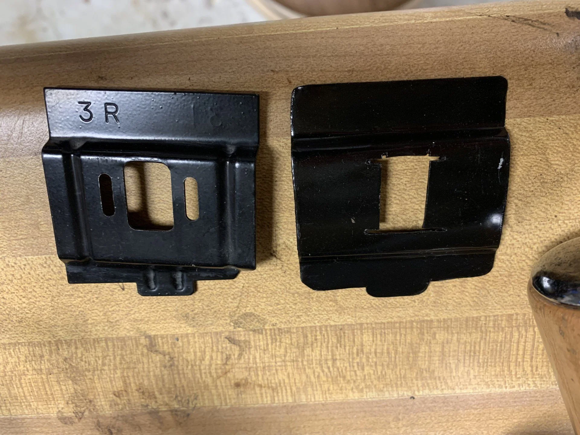

Those will not work. Original on left, homemade on right I was unable to find these anywhere new View attachment 2454125

Here was my solution. The metal clips are indeed not sold in any form. The metal clips had prongs that stuck into the bottom lip of the cladding, and then were double-side taped to the inside face of the cladding. Mine were 100% dissolved. I ended up using new plastic clips and Urethane adhesive. Seems to be working well.
