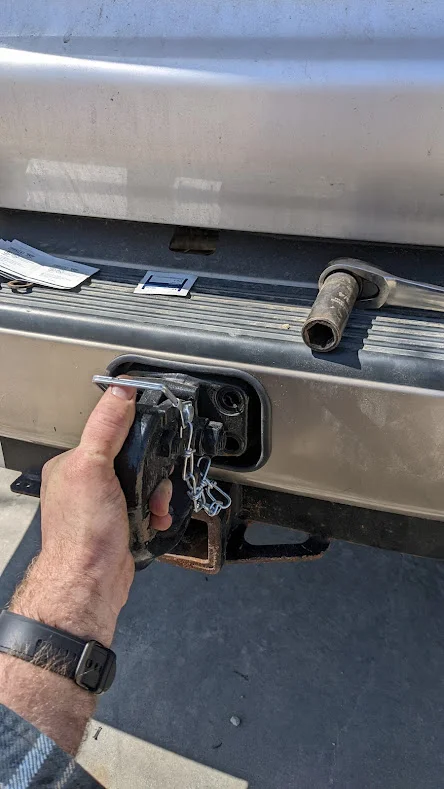

It's not quite time for my annual thread update, but I did complete the pintle install a couple of months ago! *Disclaimer, this is not technically a tow rated option here in the US* With that said...
I did not use a Toyota pintle. I already owned a quality 6ton Buyers pintle. Pintle bolt patterns are universal and the designs are all about the same, so I don't anticipate any issues.
I went to Partsouq and started digging through the parts diagrams for non-US spec'ed 100's; unfortunately I did not note the specific models I checked out. The below parts list was the same for every pintle installation on a 100 series. Some of these parts were delayed by a few days, but Partsouq got them to me with no problem.
5198560011 - HOOK, EYELET PINTLE (2)
9451201200 - WASHER (FOR PROPELLER SHAFT) (2)
9017012018 - NUT (FOR PROPELLER SHAFT) (2)
9011912263 - BOLT, W/WASHER (2)
5177560040 - STEP, REAR BUMPER
*9453101200 - WASHER, WAVE (2)*
*I did not use this thin wave washer and do not know where it was supposed to go. It was so thin I can't imagine it would be useful for a hitch installation, but it was on the Toyota parts diagram.
I dropped the spare tire first to start the installation. With the tire out of the way, you can drill 4 pilot holes in the bumper cover from the backside of the crossmember through the existing pintle bolt holes. Then I held the pintle over the pilot holes and traced the pintles backing plate shape onto the bumper cover and cut it out with a basic utility knife. The trim piece for the pintle opening on the bumper cover is "STEP, REAR BUMPER". I centered the trim over the pintle backing plate shape I cut out of the bumper cover, traced it, then trimmed the bumper cover until it fit. The trim is held in with notches on the bottom, tabs on the top and adhesive on the sides.
Test fitting the trim and the pintle.
The pintle is secured with the eyelets, lock washers and nuts on the bottom and the bolt with an integrated washer on top. You will need to clean out the existing bolts in the crossmember to thread in the top bolts.
Then you have to test it out.
The integrated pintle is way nicer than the hitch mounted pintle adapter I was using.

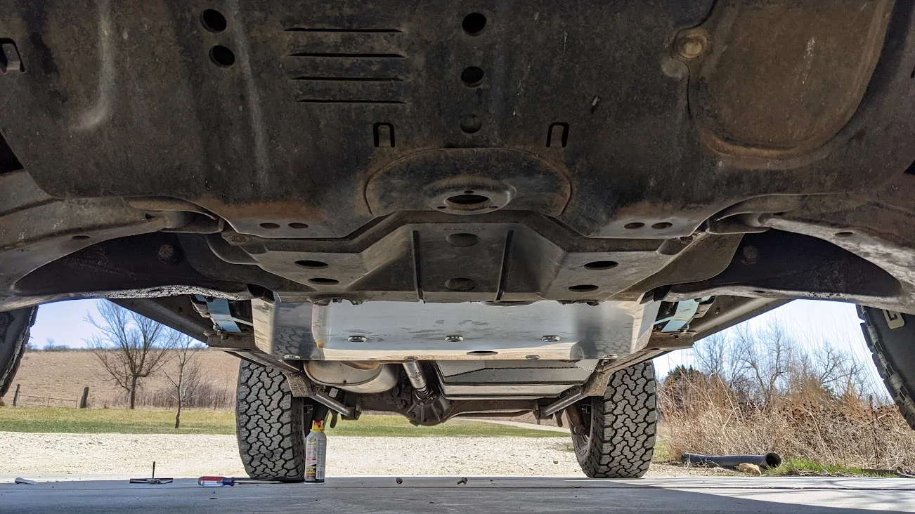

  • Installed ASFIR mid skid plate and trimmed OE composite skid to work

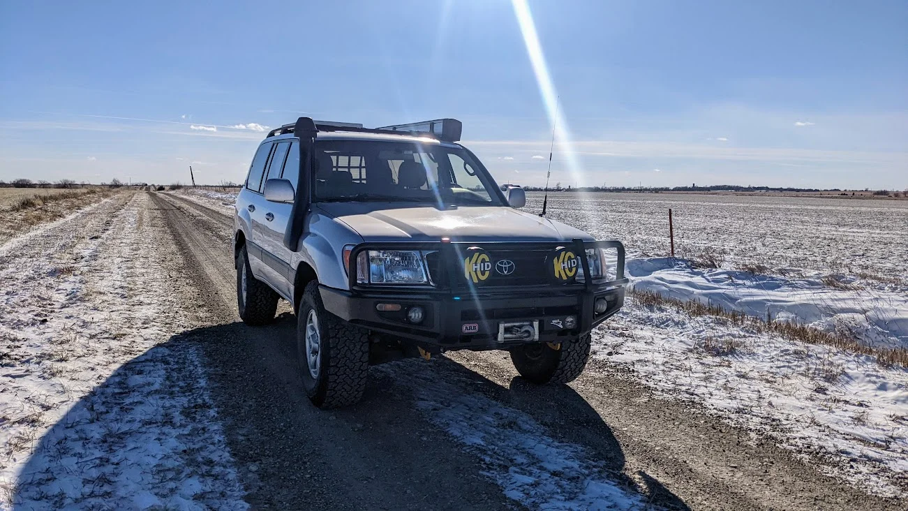

My wife and I took a 2 week trip in November, exploring Utah National Parks (plus the Grand Canyon and Black Canyon of the Gunnison) and a bit around Moab. That was a 3,700 mile trip in the 100. It was awesome... and also the inspiration for drilling the fender for a snorkel after we had water come over the hood!
Last picture of the 100 for the year after getting the snorkel installed. Brrrrrrrr.

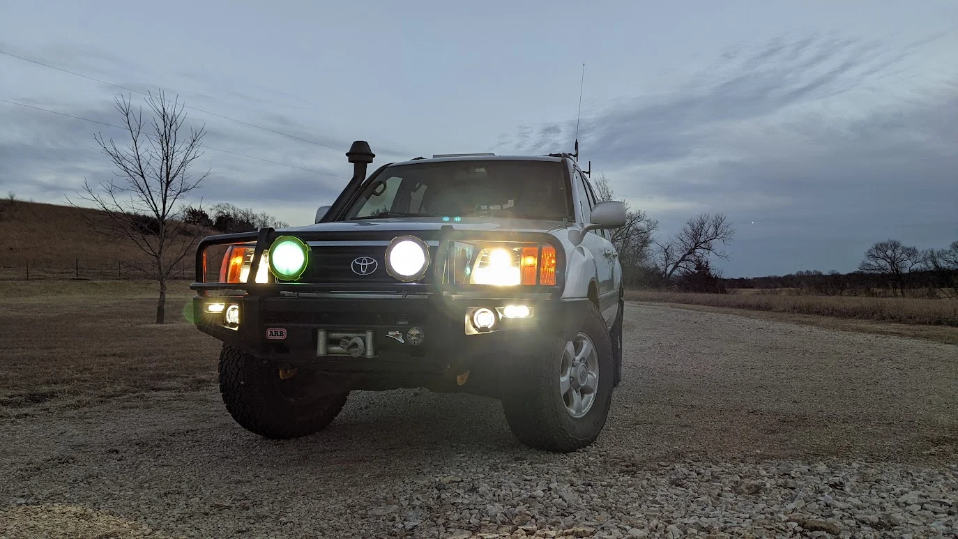

  • Installed HID retrofitted head light housings (only to remove them since I did not like the sharp light cut off)
  • Installed Stedi Fog Lights in the ARB bumper
  • Installed Stedi LED High Beam light bulbs
  • Replaced the marker lights in the ARB bumper with switched flood lights

Initial installation of the new lighting, including HID projectors. Holy cow, the HID's throw down a ton of light, but the cut off is so sharp I felt that I couldn't see any further down the road and on tree lined or hilly roads the cut off was distracting. I reinstalled my OE headlight housings with a 9012 low beam bulb and the Stedi high beam bulb in November. The light output is good and there is no obnoxious light cut off.

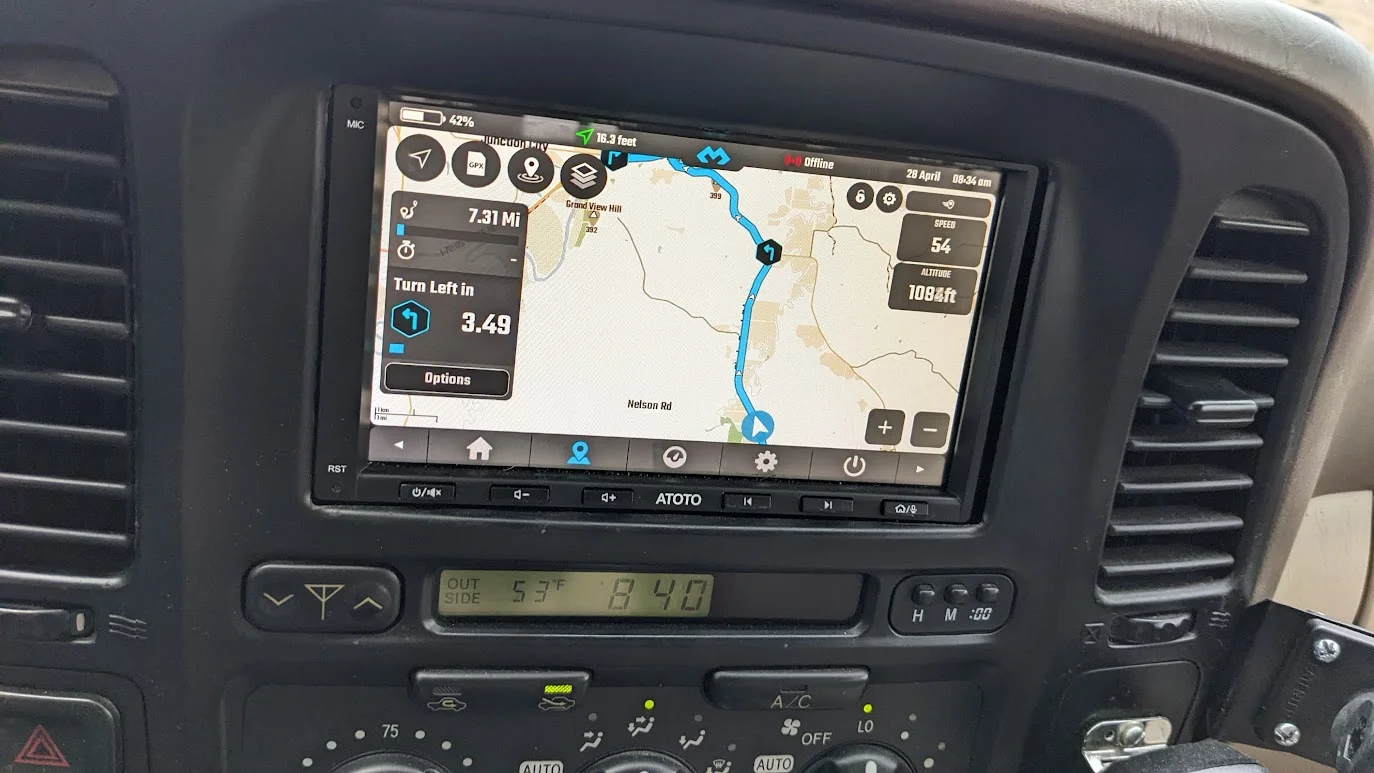

With the new Atoto A6PF radio, I could finally use my favorite motorcycling app (Drive Mode Dashboard 2) in the cruiser and I now have wireless Android Auto!

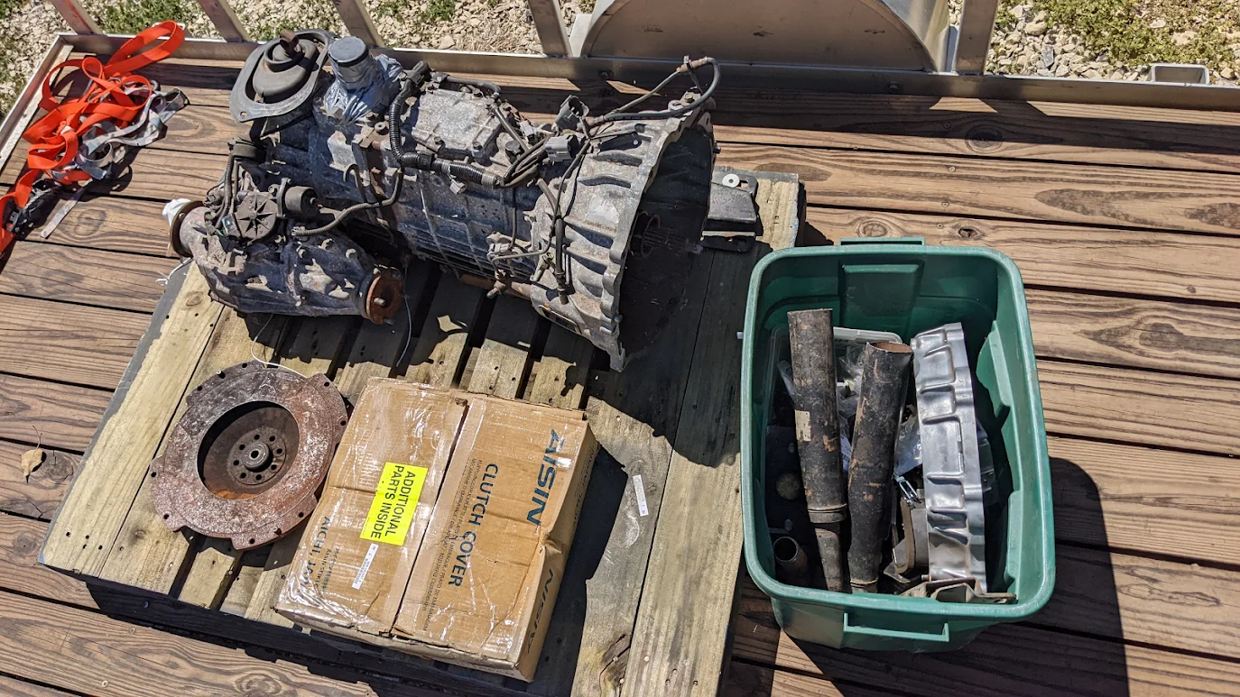

  • Replace transmission with H151F :hmm:
