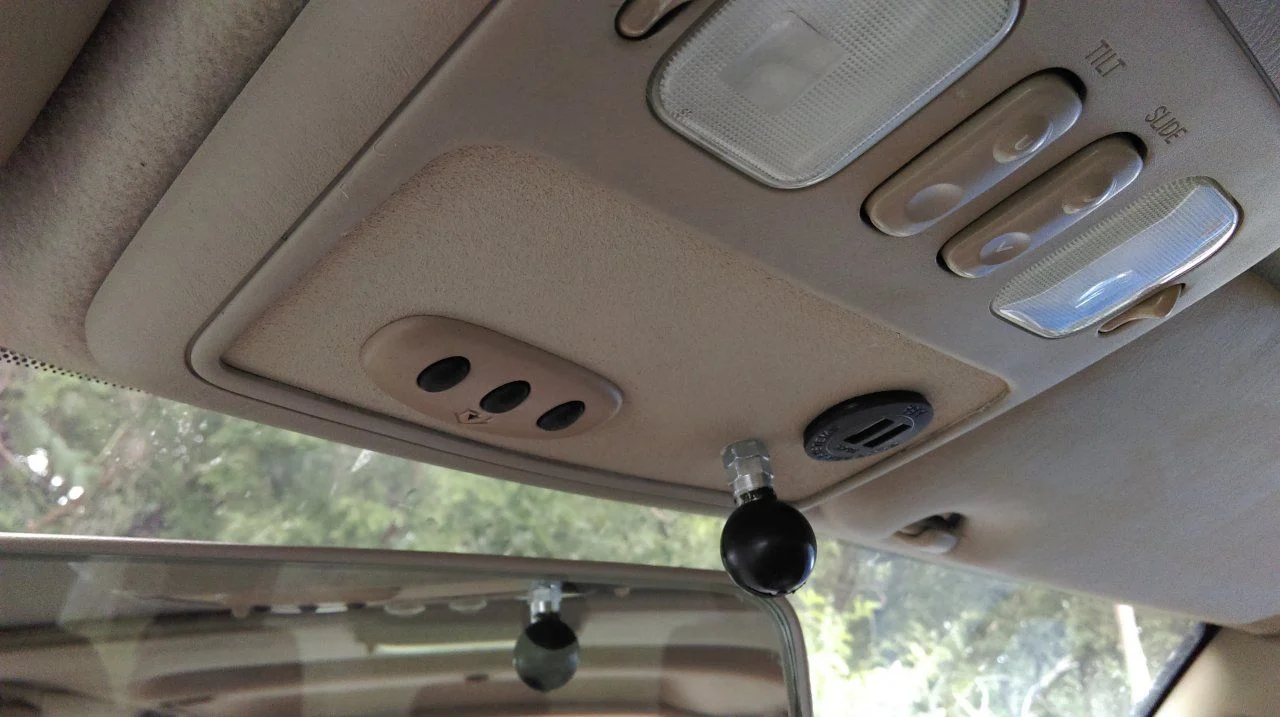

- Replaced the garage door housing in the overhead console with a HomeLink module and a Blue Sea USB power source​

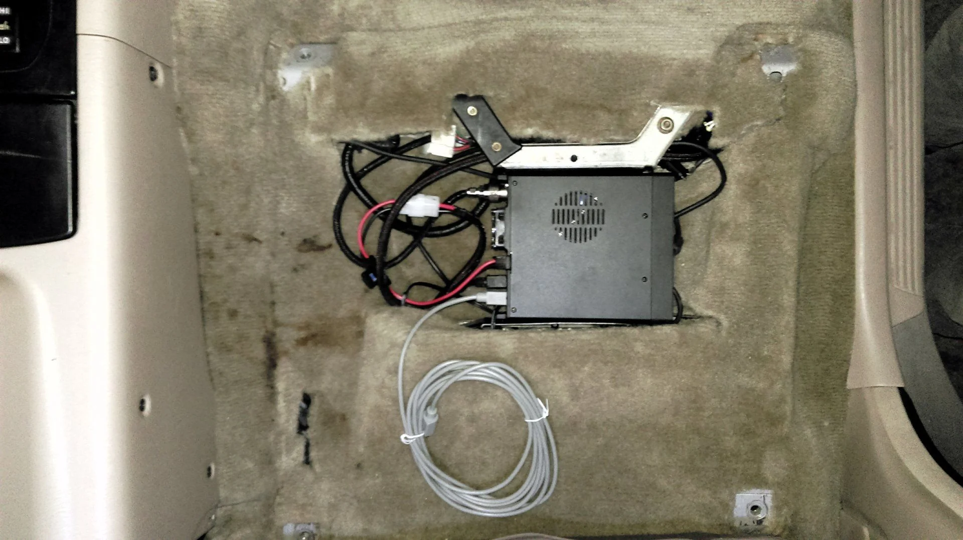

- Bypass factory amplifier to open up the space for a Kenwood V71A (see above)​

I'd love to see a pic of your Homelink/USB set up.
I do have a picture of that. Turned out pretty good in my opinion. The Ram ball mount is for mounting my phone when using Back Country Navigator.

- Bypassed factory amplifier
- Installed Kenwood TM-71A ham radio

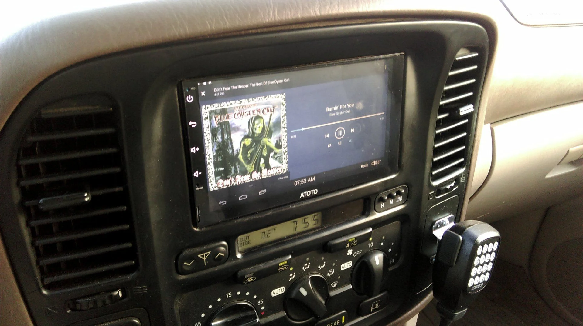

- Installed a 32g ATOTO Android Radio to replace the JVC radio
What Home link did you use, where did you get it and how much? Thank you!
